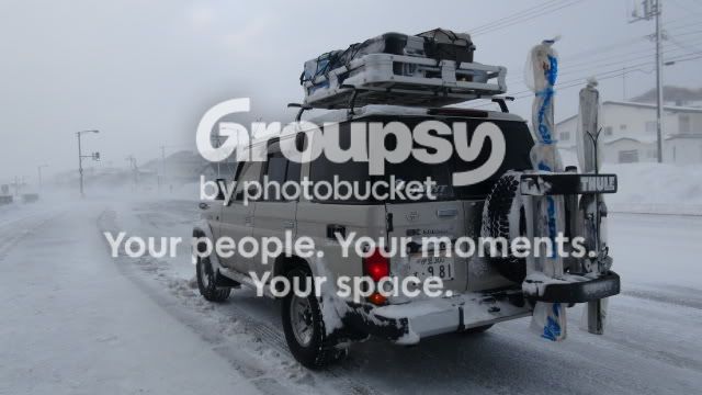

I will be taking this rack off my Cruiser and putting it on the 3rd gen Hilux Surf which only has the silly proxy factory tracks. Anyone have any ideas as to a foot solution to mount the racks crossbars? I was looking at the Surco CH 100 feet but getting them to Japan is an issue. I'm thinking I may have to have some mounts made up. Any thoughts...?
dd58f23d.jpg~original
Ah...the 3l Prado....It is a great little and trustworthy truck. 220,000K and nary an issue but it's time for a change and I got a Surf for a good price and thought I'd give it a try for a few years or more. I can always get another Prado or better yet a proper 70 later.
I'm not liking the cheap mounting tracks of the Surf and hope it's not a representation of the truck in general. Anyway, custom feet look like a tough proposition with all the curving of the roof. :twitch:

Even if I can't use my cross bars, which it looks like I can't, is there a system that uses square bars and a foot that uses the factory tracks?
Yakima has round bars and feet with or without locking clips that fit the factory tracks. I don't see why they wouldn't work. Again though, you have to deal with shipping. Maybe try to find an ebay user selling what you need that ships international. Might be a long shot, but it's worth trying.
Thanks for the help ARKRWLR.. Ya..I saw the Yakima system and have been scouring this site for other ideas but not much available that isn't going to cost me an arm and a leg for shipping.
I was tailing a nice 4th gen Surf around here a few days ago with some kind of custom foot and rail system that wasn't factory but I couldn't get a close-up of it before we went off in different directions. I'll have to keep a lookout for it and flag him down.
It looks like you have Thule gutter mount feet and bars on your roof. Thule does/did make feet that fit the 4Runner/Surf. Find the correct ones and your Thule bars will fit into them. The newer feet that run in factory rails are much shorter than your gutter mounts so that may take some getting used to.
I'm not sure what year you're looking at or what is has or doesn't have on the roof but here is what I'm running. I have the Yakima version of what I described above.

Thanks Mike, This is not a Thule system. The feet are some Japanese off brand like Tufreq. The cross bars are aluminum bar stock that I made up with threaded steel inserts. The Yakima feet look great but not sold on the round bars.
