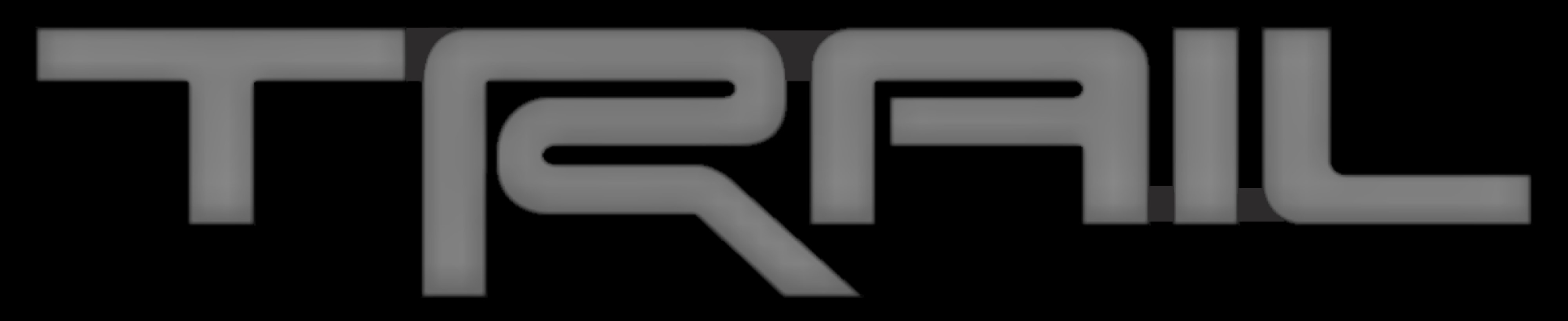

I created my own .stl files
Hey all, I looked around on the Internet and found a site that can convert images into 3D .stl files. I used the image below at Convert PNG, JPG 2D Images to 3D STL Mesh Model File Free Online Tool - ImageToStl and created it. I did mine at 180 mm wide and 7mm depth. It does come out with a rounded face of the letters, which I wanted, but the way the printer does it makes it look odd. In order to fix this, I added a few layers to the "ceiling" or face of the letters and then stopped my prints early after it completed with one of the top layers. I figured which layer by using the slicer program (Cura) to inspect them.
