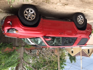

Hopefully the pic posts (don't know what I'm doing) with her new 275 KO2's.

Wow, sure you are in Denver? Picture looks like it's from Australia given the orientation? That red sure is sharp looking.
Welcome, I have no advice on settings, I stuck with what came on my truck. Watch your wallet, this site somehow influences money to disappear from it.
So apparently your first customization feature was to invert gravity... kudos! :D
