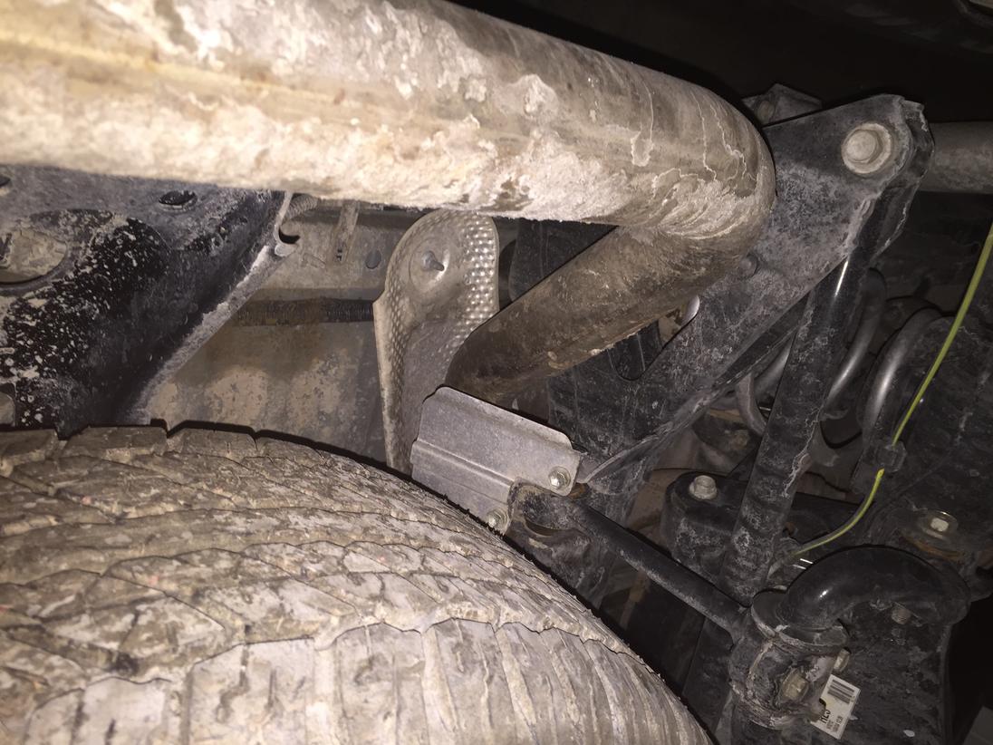

I know this has been done but I can't find the threads. Was crawling under the truck today and thought about chopping the exhaust off behind the rear axle towards the end of the downward diagonal section. I see that I will loose a support hanger
*Did you notice any audible increase in the cab?
*Did it help with the sulfur/exhaust smell with the rear window down under acceleration?
*Any other issues or concerns this could cause?

You might get a new rattle without that hanger.
Then there is the possibility of exhaust gasses leaking into the cab from the shortened exhaust. (The engineers put that pipe there for a reason!)
Every old clunker I had (most of my vehicles, LOL!), when they developed the inevitable muffler or exhaust leak, the exhaust smell was quite noticeable in the car. (Of course, it makes you appreciate the tree huggers more, when you are constantly smelling the by-products of your driving habit).
I've seen several threads where, to alleviate exhaust entering the rear window, owners have had a muffler shop bend/reroute the tailpipe behind the rear wheel.
I certainly would not cut it off underneath the vehicle.
That's the ghetto way to do it and you are better than that. Get a muffler shop to do a turn out behind the right rear tire.

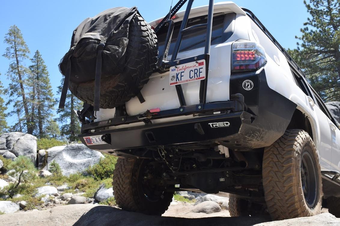

I cut my tail pipe off as it makes the turn to horizontal behind the axle. Would have no issue doing it again. I have driven around plenty with the rear window down with no issues as to fumes. No real change in sound as you are just shortening the tail pipe.
Go for it.

Did you ever do it? I smashed the tip of the exhaust, and debating whether cutting it of completely or bending to the side.
Yes I cut if off where it turns down after the rear axle, I did notice that I have melted a bit off the rear mudflap so I should have cut it differently or just spent a little cash and had it routed out the side.
In relation to the photo above, I cut ~2-3" further up which is before it starts routing to the rear and is exiting angled toward the ground/mud flap
