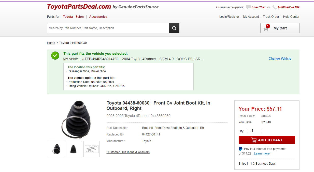

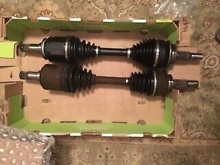

I need OEM 4438-60030 kit which are 300 $ Can in Canada and almost impossible to find here. Any quality aftermarket solution that will fit this kind of axle please?

The part number you posted is an old part number that has been superseded have you tried to get the parts using an updated part number, the part number in the post you quoted is the correct up to date part number , which is..... Boot Kit - Toyota (04427-60141), just an FYI the old part number you posted is missing a number the first 5 numbers should be 04438, what you posted is missing the 0 as the first number.

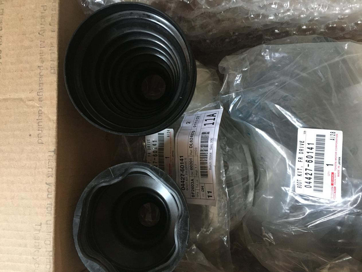

boot kit 04427-60141 won't fit my 2004 T4R CV axle

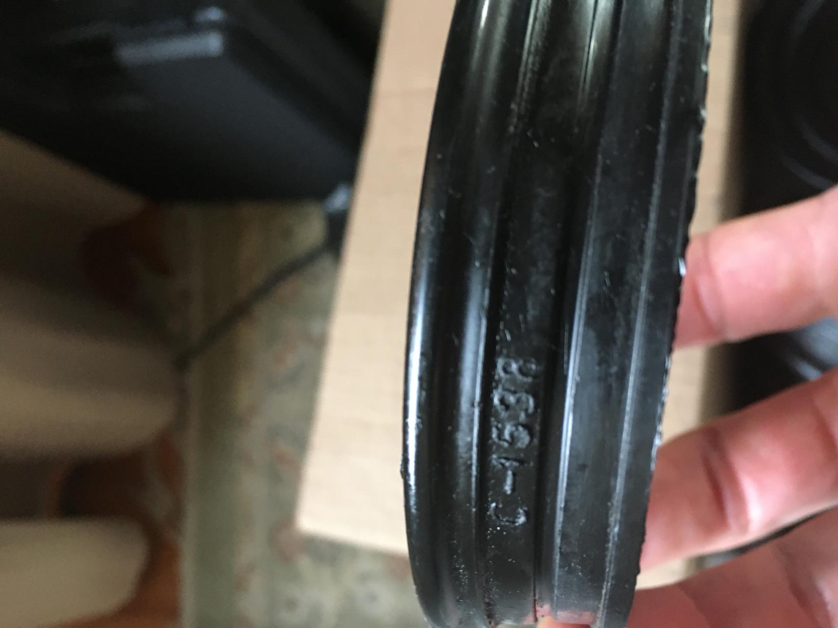

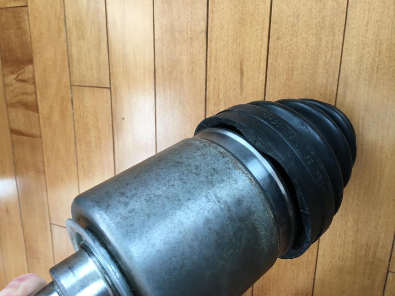

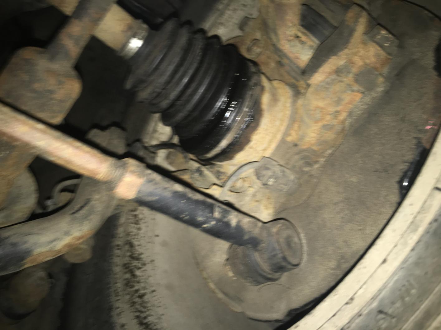

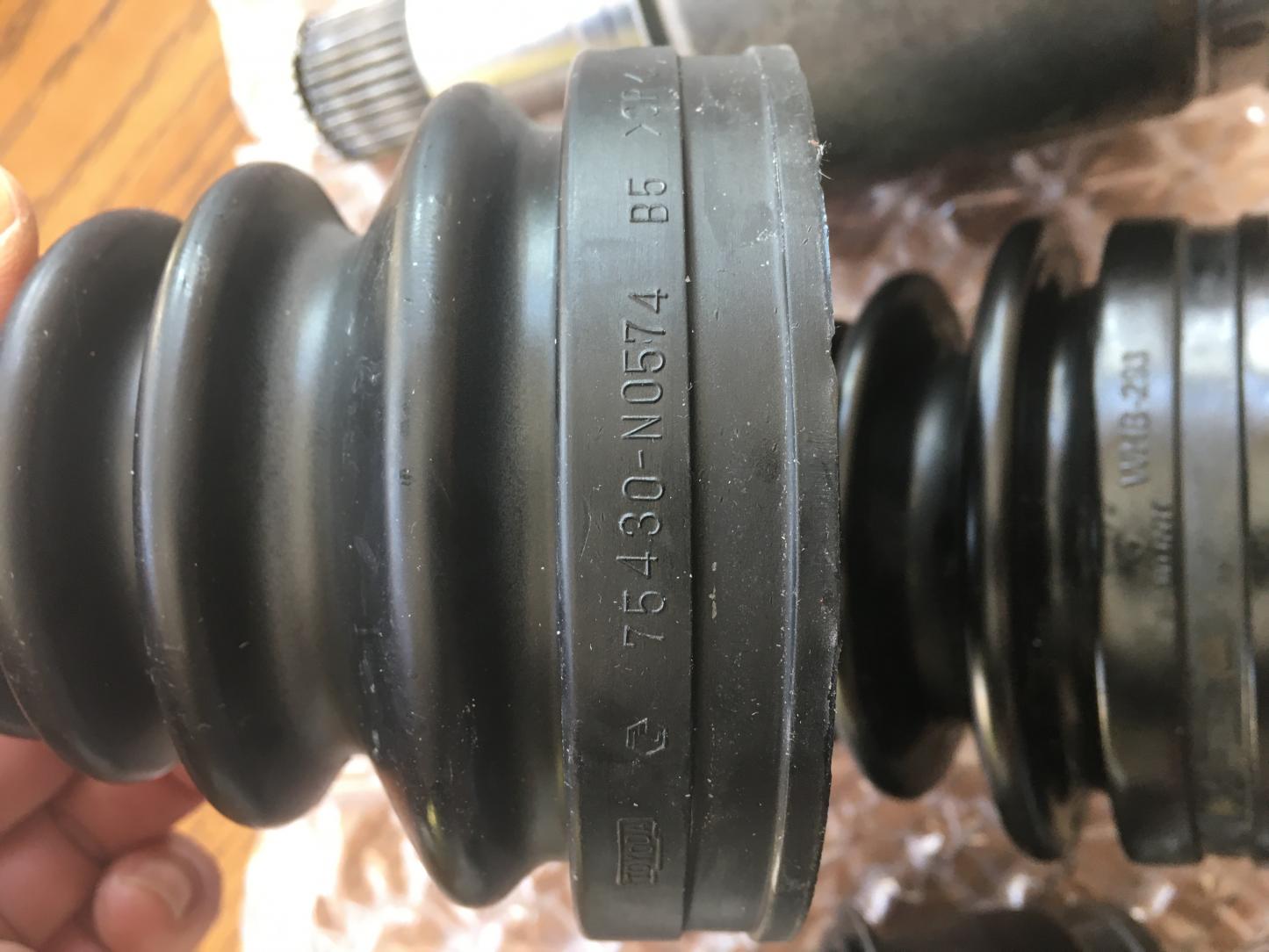

Thanks for your quick replay. Unfortunately I had to return 04427-60141 boot kit as it wouldn't fit my CV axle.Please refer to photos I have attached. My axle is apparently used in some 2002-2004 years models. My inner joint is fully rounded and boot shape inside diameter as well.The new superseded part /boot is triangle concave shape inside and is 1 cm smaller.

I replaced the passenger side with a new OEM axle assembly but still like to find matching OEM boot kit for my 240 KM axle.
