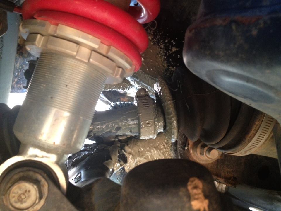

CV axle boot blew up now what?
kmiller93
What should I replace the boots with? Its just a matter of time till the rest go.
With this broken anything I should worry about while driving to the shop to have fixed?
I also just saw something about a grey milkshake?
I had my passenger side inner boot torn (exactly the same way as yours) for the past 2 years and drove across the country, and had no problem!
Bought a boot kit from rock auto for $18 shipped and installed it by my self. The toughest part is to remove the CV axle nut. IF you have the OEM axle, the nut is 35 mm and aftermarket CV's have 36 mm.
Money shot! This seems to be a recent topic around here. Mine looked exactly like that a few weeks back. If I recall you installed your lift not long ago (hope I'm correct but I remember looking at your rig, and it looked sweet.) The OE inner boots fail after moving them from their happy homes, then proceed to spray their goodness all over. I'd think if your axles were angry, you'd have already known. Solution would be to put long travel inner boots on (thanks DirtDawg!). Or, replace the axles with re-manned OEM's with long travels already installed. I chose to go replacement route which was much easier than re-booting and about a $40 difference. Went through CVJ Axles, Inc. in Denver. Here's the thread I posted if it helps http://www.toyota-4runner.org/3rd-gen-t4rs/143267-i-dont-think-normal.html
Not to go off topic but I wonder if there could/should be a spot in the lift sticky aboot boots failing after lift installation? It seems to be a very common problem and something I would have thought about when researching my build. I don't know how to go about something like that or if it's relevant enough to warrant an amendment. Anyway, hope this helps-
If you don't have any issues with your CV axles themselves, then there is no reason to replace them. Just re-boot. I had my drivers side blow a month or so ago and re-booted with the OEM Toyota boot kit. One kit comes with new inner and outer boots, grease, and all new clamps for one side. I did both sides for precaution and replaced LBJs while I was at it.
You will just have to decide to do OEM or go long travel.
Thanks for the compliment. So you replaced the entire axle not just the boots? I read what dirtdawg said and ill prob buy some new boots.
I decided to do the the axles because of cost differential. The long travel inner boots, long travel outers + shipping is $200 +/-. The re-manned OEM axles with the long travel inners already installed was $260. There was no reason to believe that there was anything wrong with my originals other than being 17 yrs old. I've been replacing everything else under there so it was just logical choice for me if it was only a few dollars difference. Not to mention easier and a lot less messy -
Depends on how long you leave it torn. If you don't have the means to replace the boots within a month or so and drive it daily I would recommend replacing the whole axle. It will have spun without grease and with debris in it for a bit too long for my comfort. At that point you're just sealing it back up with crap in there. I advocate buying new ones and rebooting your old ones, after a thorough cleaning of course... then you have them as trail spares. If you can reboot them in time then it would be worth it to go that route. They will almost always blow after lifting your rig. It's science.

So dealership says 600 for new axles and labor. Or I spend 250 for new boots and labor with my friend. Dealership said the axles may be going bad from age. Is that the dealership just trying to make money? I'm sure it is. Or could the bearings be going bad. It's only been torn open for a day.
CV change is extremely simple. You can replace both CV's with remans or new NAPA CV's for under $200. Or just reboot your OEM's. Don't listen to the dealership on this one, you will be kicking yourself after realizing you didn't need to spend an extra $400.
Remove your skid plate, loosen the hub nut, take the wheel off, remove the bolts from your LBJ, remove the hub nut, take a mallet to the CV, use a pry bar and hammer to knock the old CV out, grease the snap ring, install new CV.
