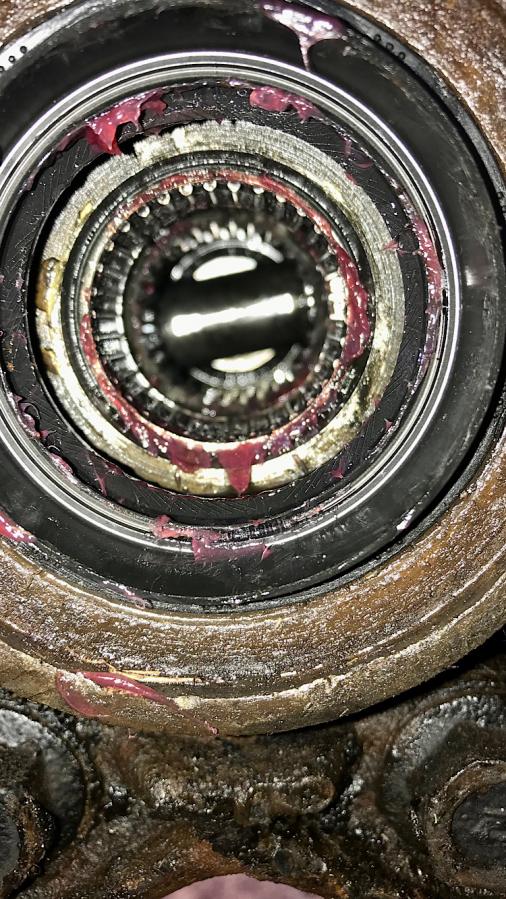

Hi all. I’m new to the forum. I’m replacing both CV axles in my badly rusted 08 Limited that had close to 180k on it and noticed a discrepancy inside the differential. The driver side seems to have a smooth metal shaft lying horizontally inside (see pic), while the passenger side is just an empty housing. Is this by design or am I dealing with a larger issue?

I THINK you're seeing a cross shaft that is part of the internal gear set, so don't think it's a worry. Someone with more front diff knowledge will chime in I'm sure.

What you're seeing is the differential from the drivers side. The cv axle interfaces directly with differential. Because the diff is offset to the drivers side, the passenger side requires an intermediate axle/stub shaft. It plugs into the passenger side and extended the housing outward. This is why you're not seeing the same thing on the opposite side.
