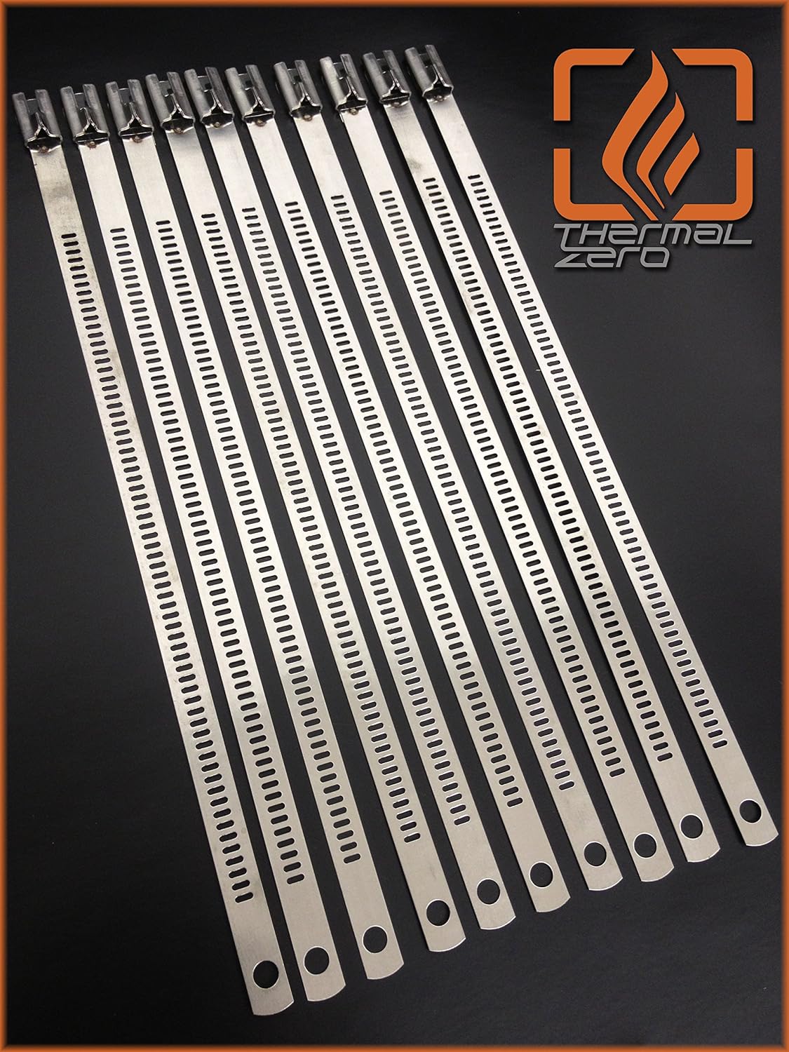

My question is: Would I be OK replacing it with a steel zip tie (which i could do without removing the axle), or should i yank the axle and install a new toyota clamp?

Zip tie
I haven't used those steel zip ties before but I would assume they need a tool (maybe just pliers?) to tighten them properly. If you have the tool I would think they would get plenty tight. You can also use a worm style hose clamp.

I don't see why you couldn't. Just don't use the screw clamps (because those will loosen, or interfere with something), or plastic zip ties that are not UV rated (because they'll break down).
I used an autozone steel ziptie on my inner boot for a period of time. i put a normal plastic zip tie over it to ensure that it wouldn't catch on anything.
Held fine until i caught some rope during an offroad venture and it ripped the boot to shreds.
I did a little more research on the steel zip ties, and apparently it's really hard to get them tight enough since the locking grooves have some (albeit very small) space in between them.
I think i'm going to stack a black ziptie on top of the crappy autozone CV clamp, until i can get a new toyota clamp crimped on.
