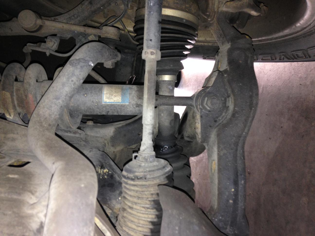

Unfortunately when I was under there I noticed the driver side axle boot closer to the engine had torn right where the clamp was. It is new within the last few weeks and I didn't see oil flung all over. No clicking yet either.

Here is a pick

That should help if I decide to get the thing off and to replace the boot/s. Thanks!
