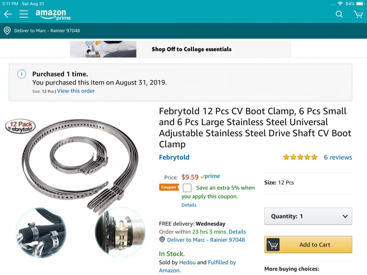

I just clamped mine back up the other day and these are the bands I used with my pex crimped. Worked well so far.

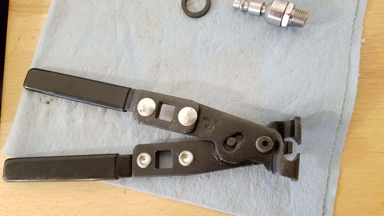

I have Lisle (I think?) clamp pliers that do it but they didn't work as amazing as I hoped from what I remember but did the job. They look like this:
If I had those type clamps, I’d be golden. I have two sets of those pliers. However, the OEM clamps are different.
I ended up using my T&G pliers, pulling as tight as I could, and folding it over itself. It actually ended up tighter than I expected.
