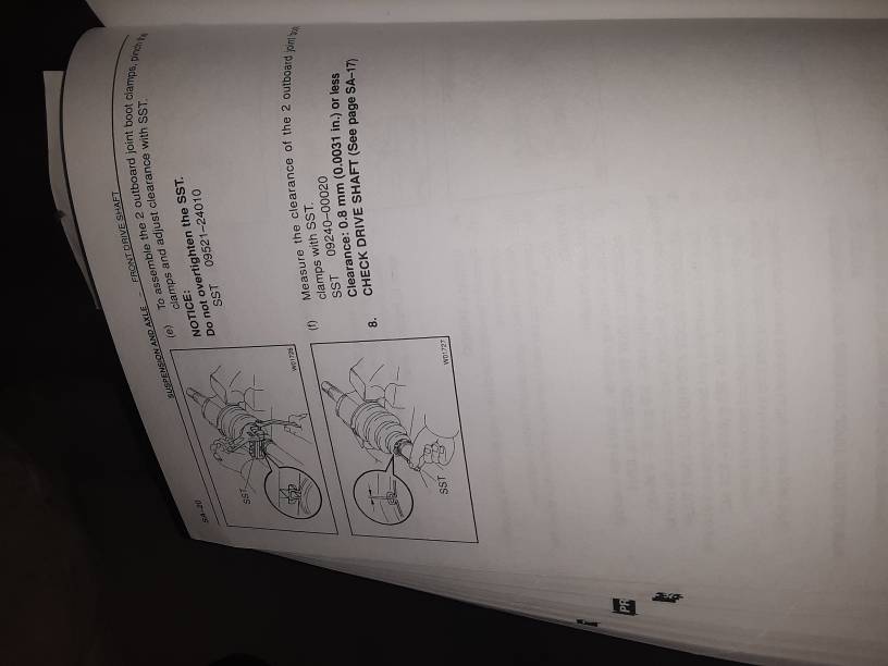

Anyways, to answer the question of this thread title
SST 09521-24010 is the tool for the small clamp
Clearance check tool is SST 09240-00020
Clearance of .8mm [.0031 in] or less

Thanks Brillo
I have two sets of pliers for those type clamps. These are the type clamps I removed from my OEM joints and what I received with the new boots.
41cQeOI0AhL._SR600%2C315_PIWhiteStrip%2CBottomLeft%2C0%2C35_PIAmznPrime%2CBottomLeft%2C0%2C-5_PIStarRatingFIVE%2CBottomLeft%2C360%2C-6_SR600%2C315_SCLZZZZZZZ_.jpg
Oh dear. No way does that match the FSM..LOL You 100% sure those are OEM boots and OEM Bands?? or is someone selling you an OEM Boot with a different Band? Very common for Ebay and Amazon to do things like this.. :-( Sorry, I couldn't be more helpful.. I haven't ran into clamps like that yet. Glad you found a tool for them. :-)
Fairly certain...everything else was. Timmy actually mentions them in his video as well.
Interesting.
I did send an email to my dealer parts department asking about those pliers for cv joint boots several days ago. So far all I got was crickets. It would be a different sst part number for sure then FSM mentions. Most have changed the setup of bands at some point. Most of my rigs all have original front axles still in them but the one as the boots got damaged and starting leaking grease. So I swapped the axles and seals when I had the half shafts out. :]
