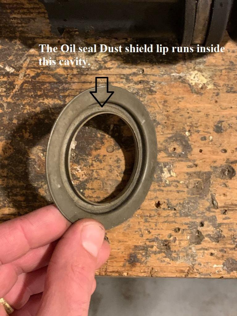

Update: drivers side axle is on the bench, re-booting tomorrow AM. Question for the group. The metal dust cover fell out during removal, which orientation does it go back in? Does it press into the rubber gasket on the differential?
THIS SIDE FACE OUT
THIS SIDE FACE IN

Looking closely at the various CV instal videos, it looked like it was supposed to be attached to the CV, so I tapped it on lightly with a brass drift to the end of the axle in the orientation you suggested. Sound right?

See the image. The oil seal dust lip should run inside the cavity so this cavity should face the diff.
Very helpful thanks, I’ve installed the axle with the shield in this orientation. I tapped the shield onto the end of the axle, seems like it just clamps on with a bit of pressure.
