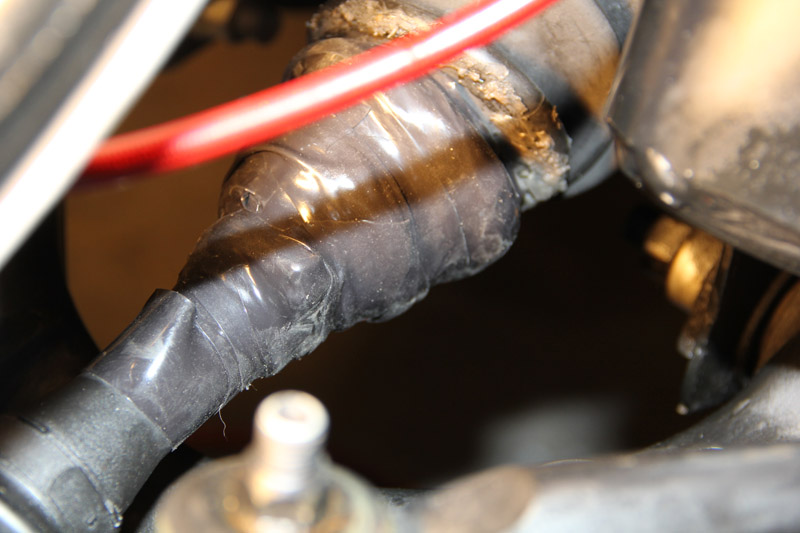

Fusion Tape Repair Still Holding Up
For those that are interested...my field dressing for my CV boot repair is still holding up. Nothing more than Shoe Goo (Goop) and Fusion tape.
Who needs CV boots when you got tape?!!....haha :dancin:
