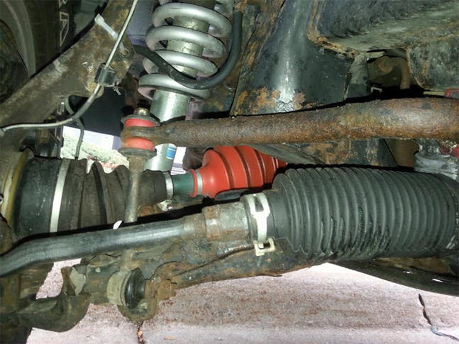

CVJ Reman CV Axles w/ Silicone Boots
Here's a pic installed. Took me a while to find it. This is on my old truck. Don't mind the rust. Currently the same axles are on my '98.
