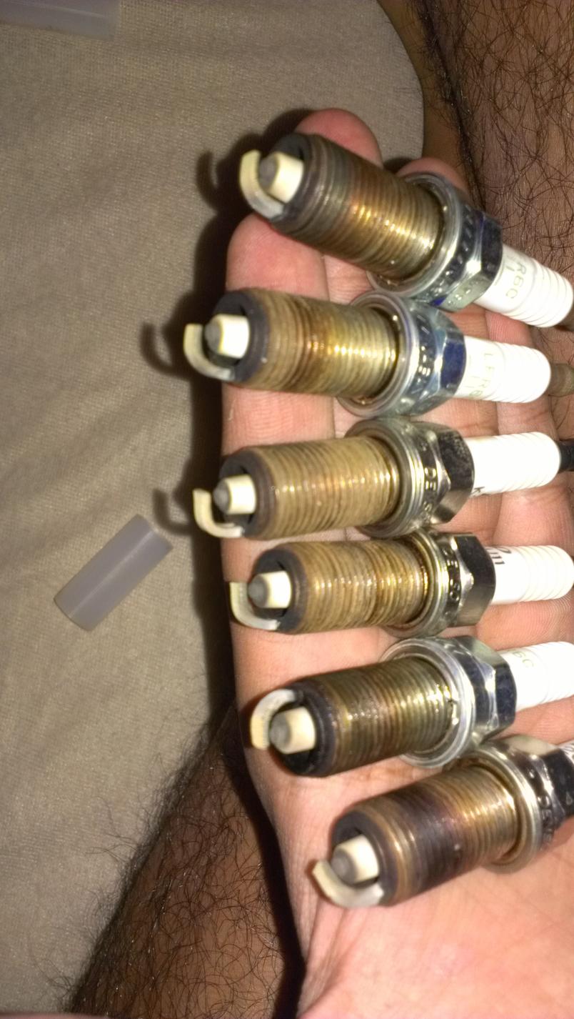

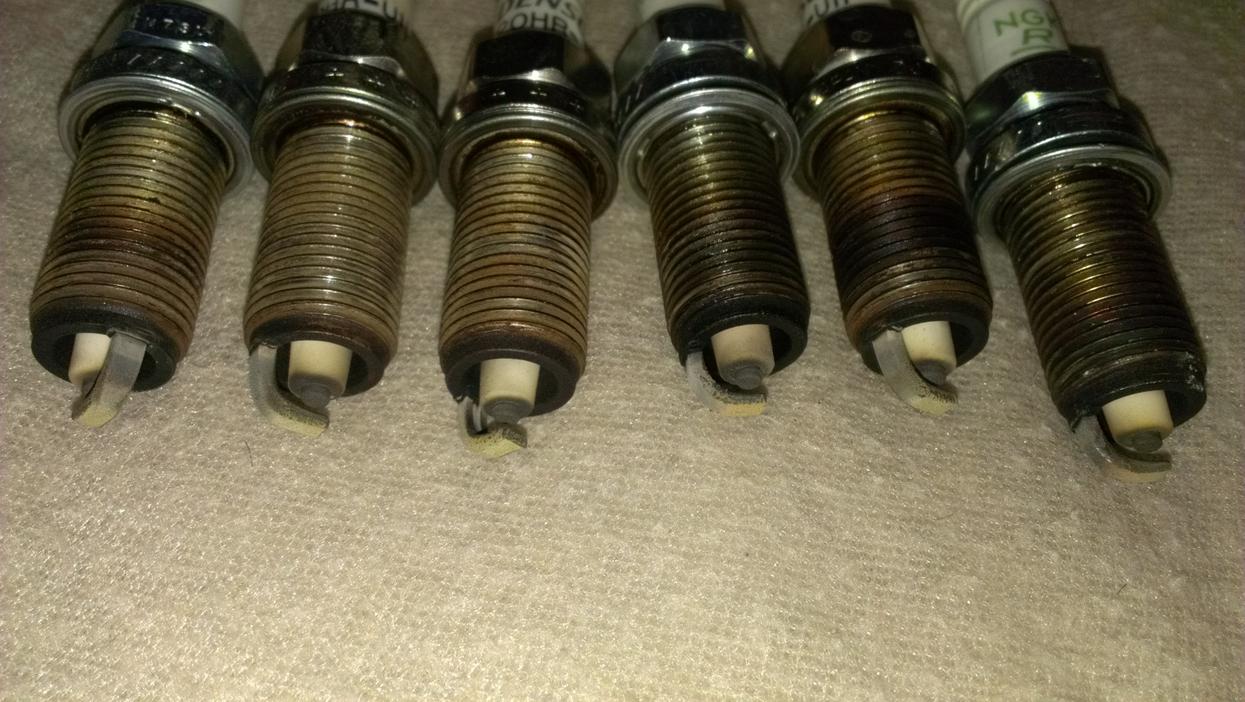

How many miles? Got pics of the old plugs with their locations?
i believe the NGK on ones were on the right when facing towards the engine
