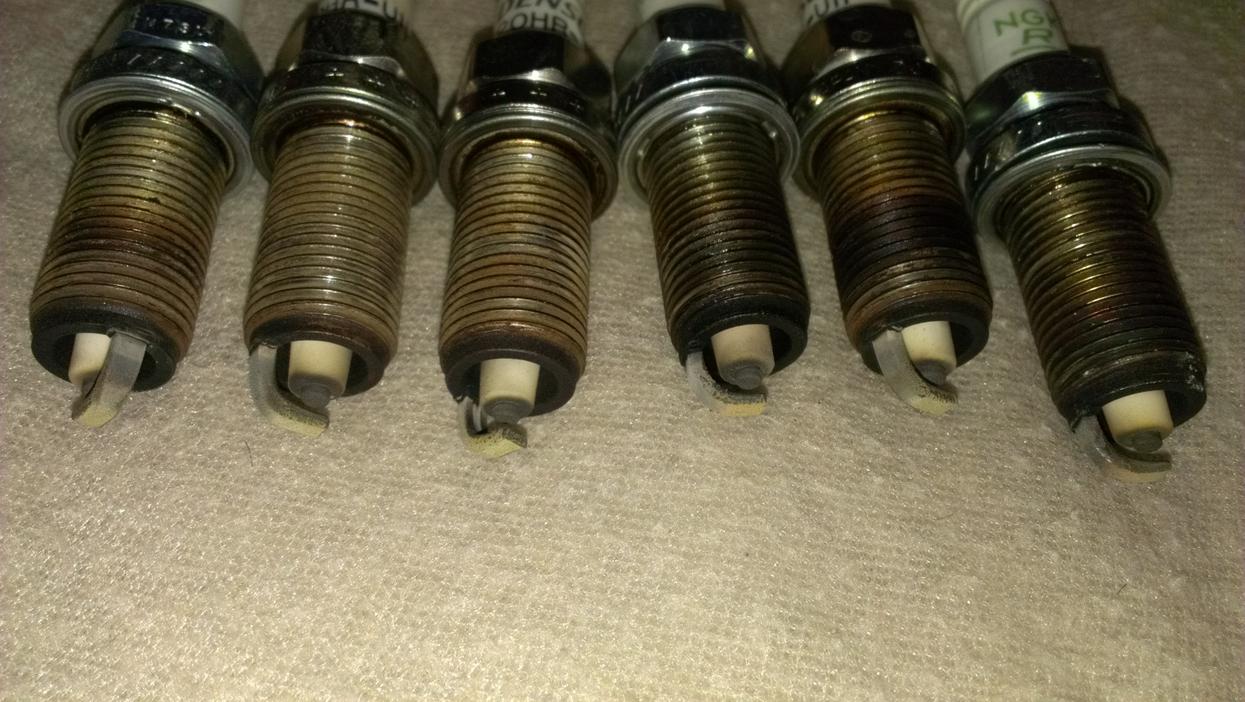

Cylinder 5,6 Misfire HELP!!!!!1
Just noticed a little oil on one of my plugs, I have a 03' V8. Im running full syn Oil and just replaced the plugs with the recommended Denso plugs.
My 4Rnner is running great! but the little bit of OIL i found worries me... I hope you get this resolved my man.
Update the guy at the local shop was just gonna keep charging to replace everything that he though was wrong so i had it towed to the dealer i was actually sad to see it towed away
they asked me if i want to replace 2 or all 6 and it want much difference in price and im starting to doubt my work so i just had them replace all 6 im just hoping the tech is right and i dont have to spend any more money
See if they can save you the cracked plugs to show you. I'm curious if it's easily visible to the naked eye. Sounds like they might have either been dropped before you installed them or you over-tightened them. Did you use a torque wrench when you put them in?
yea i went and bought a tq wrench just that day and 15 foot lb right?
