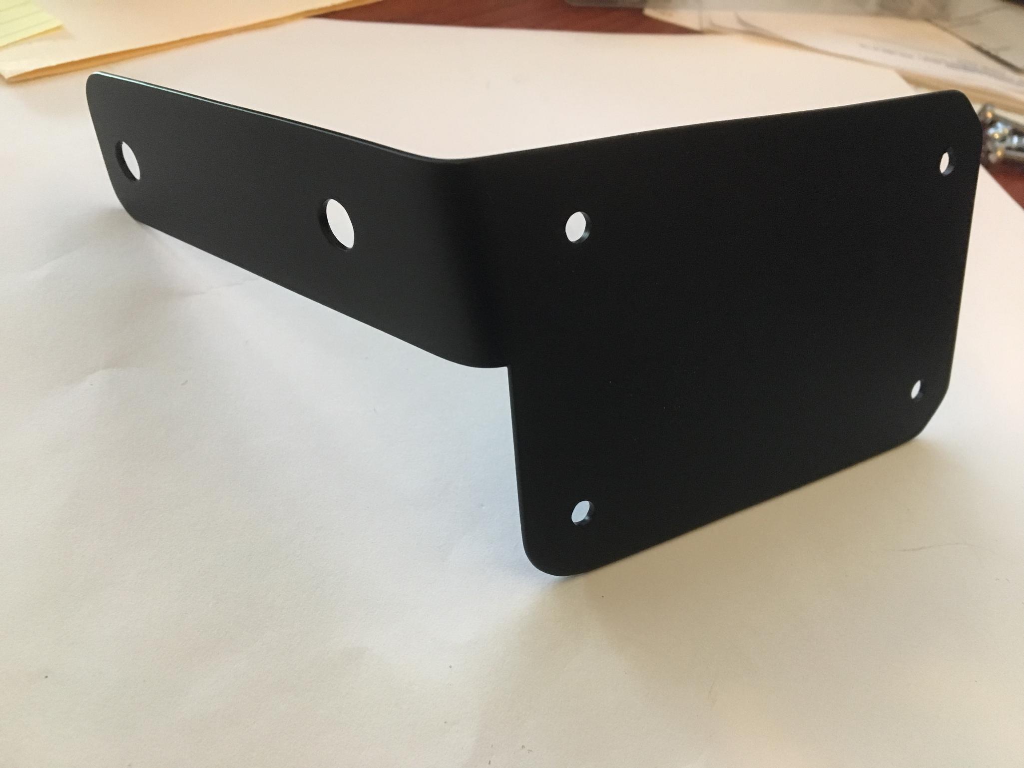

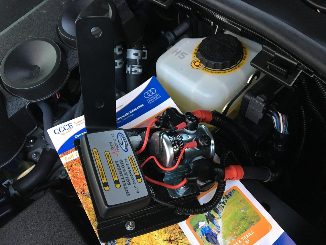

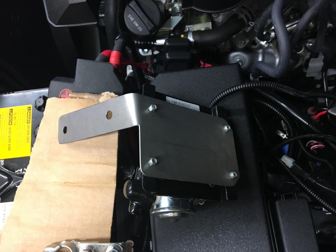

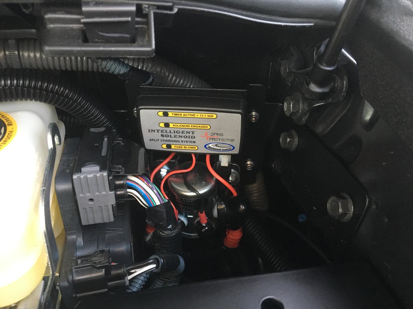

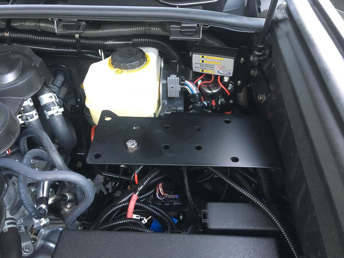

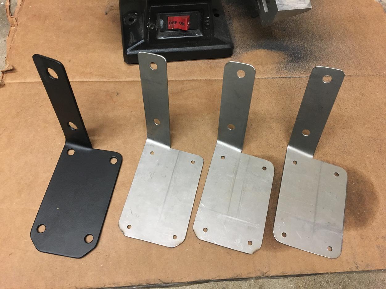

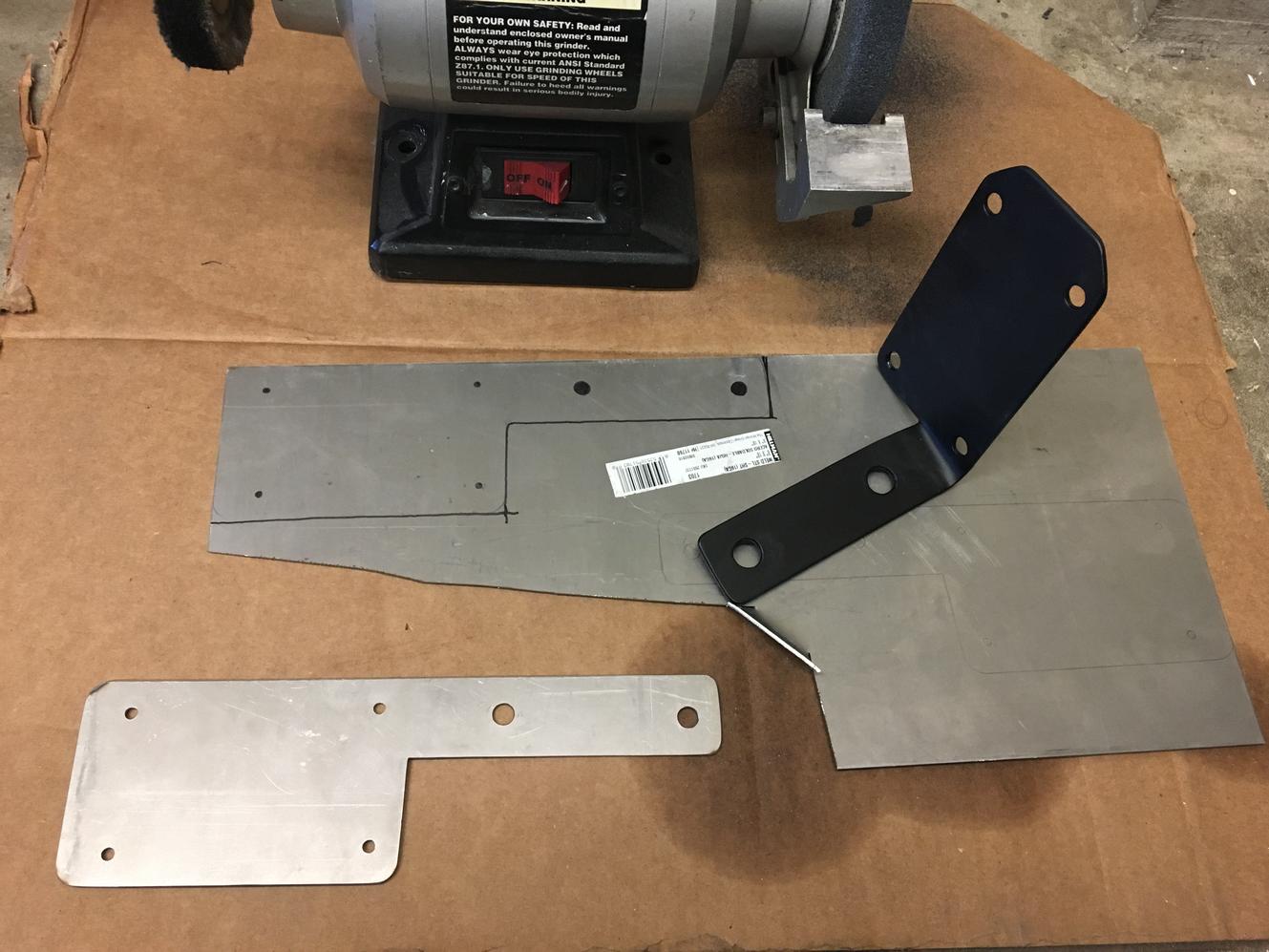

New and improved National Luna isolator bracket installed!
I finally got around to installing the new bracket and it works beautifully. Also got the sPOD mounted to the larger bracket and the isolator indicator lights are still visible above the sPOD as planned. Really happy with this location so far.

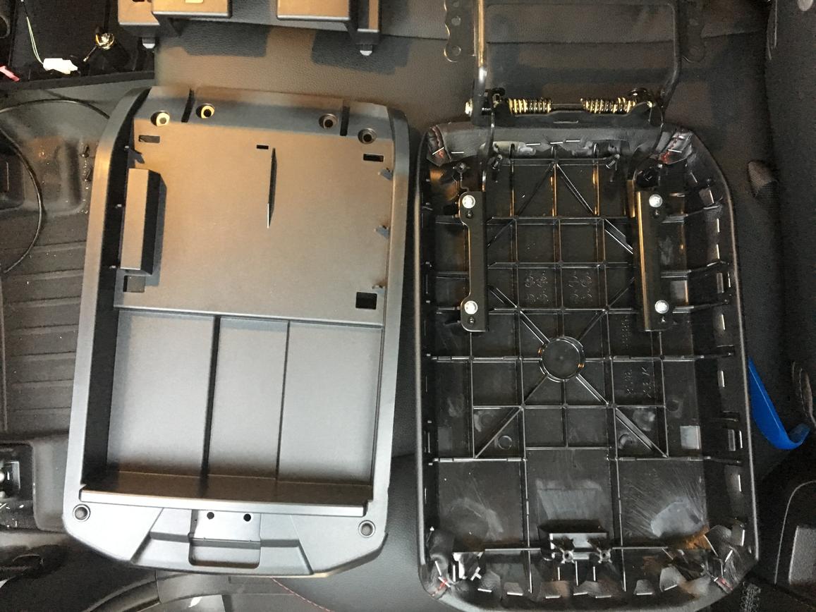

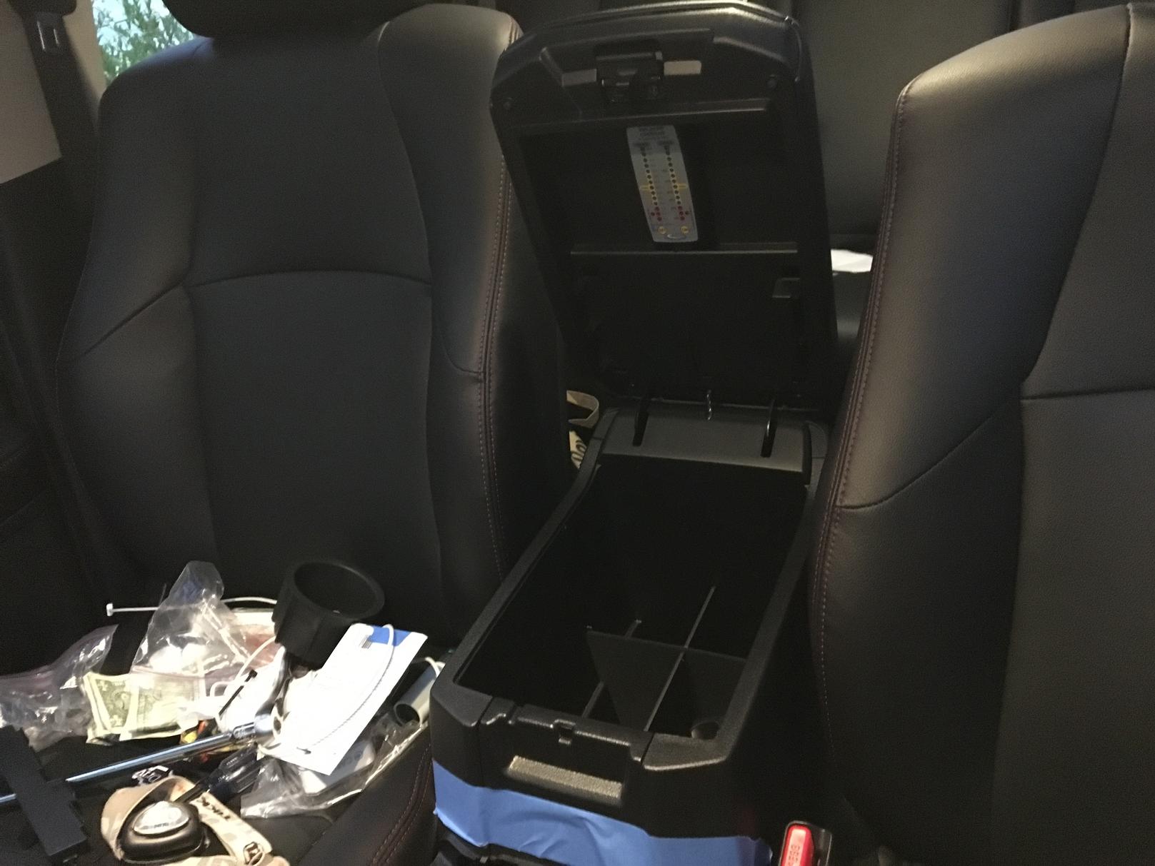

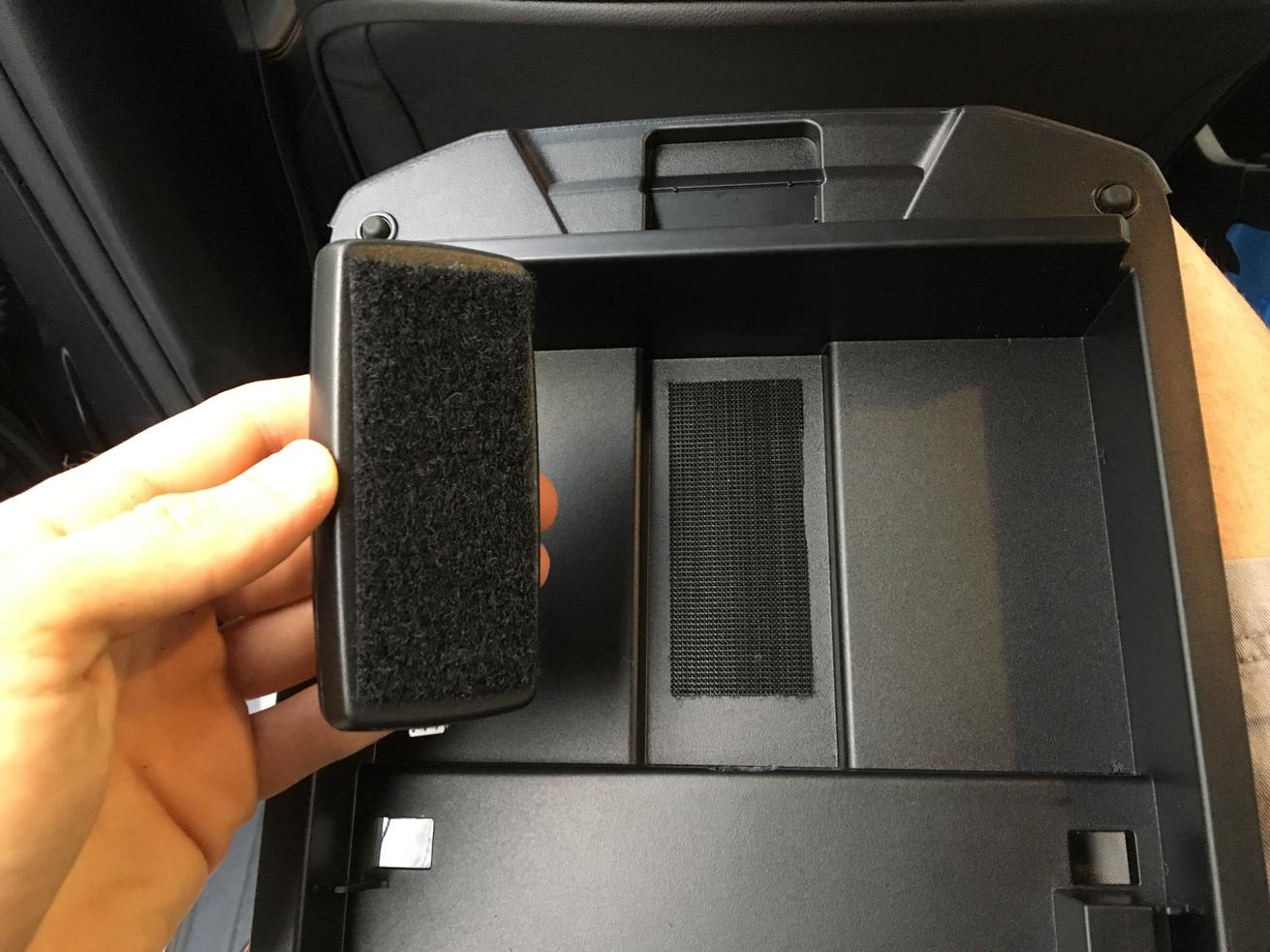

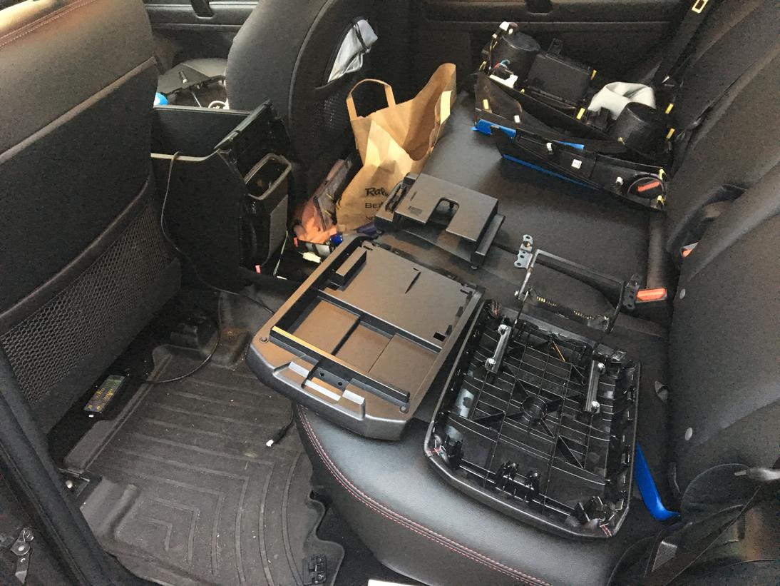

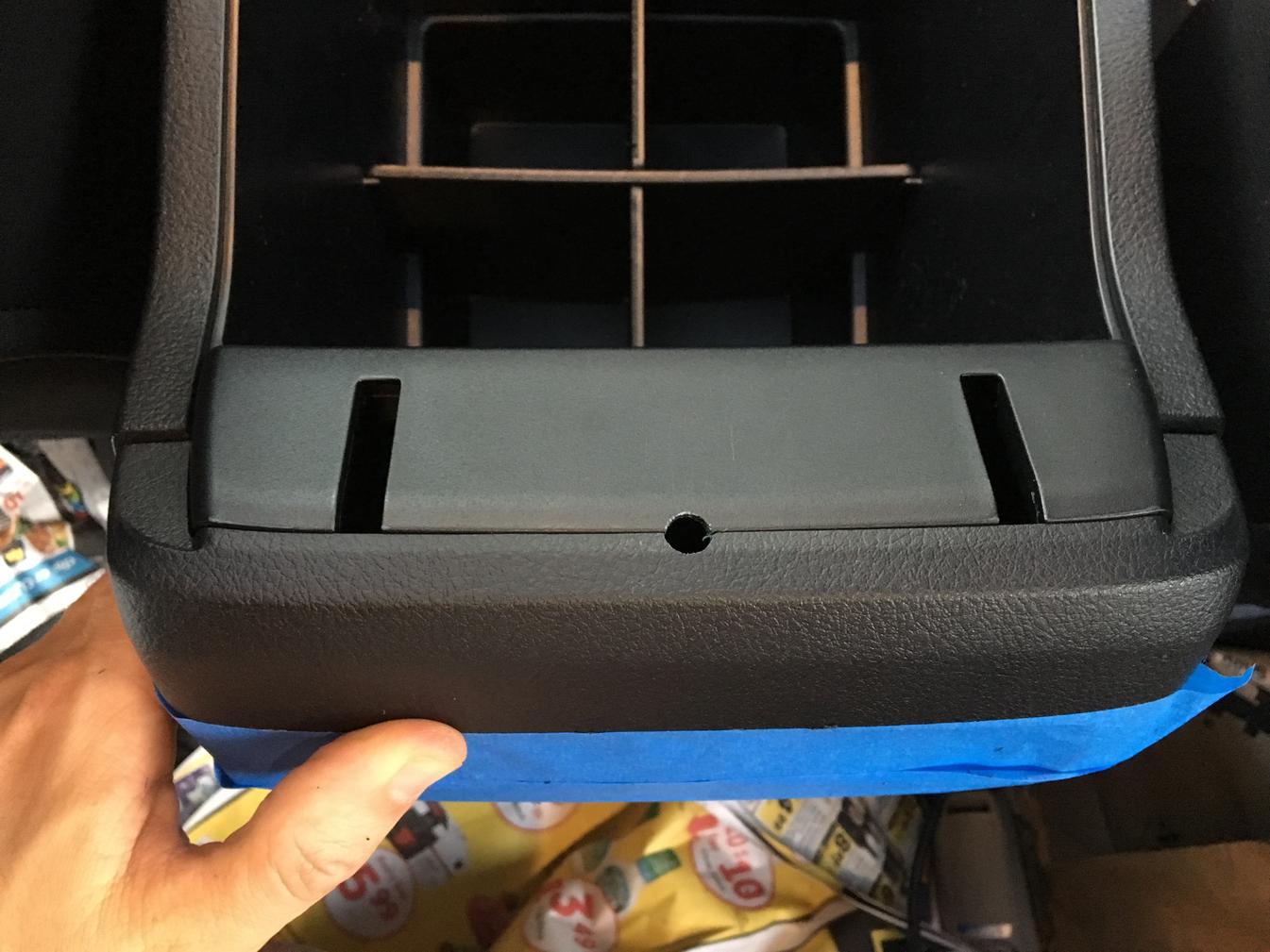

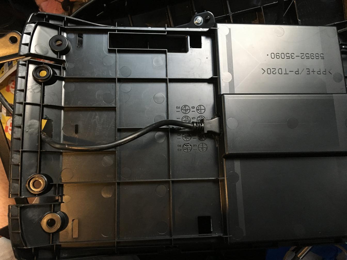

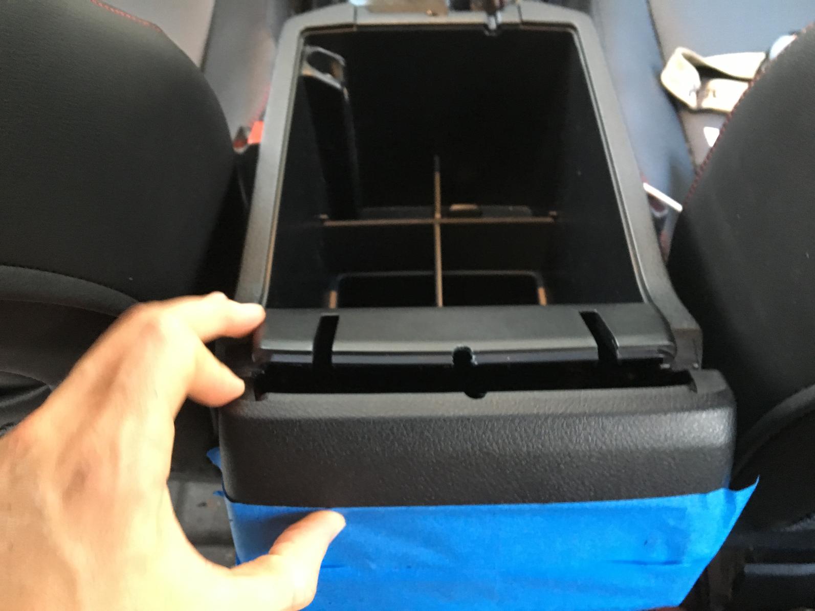

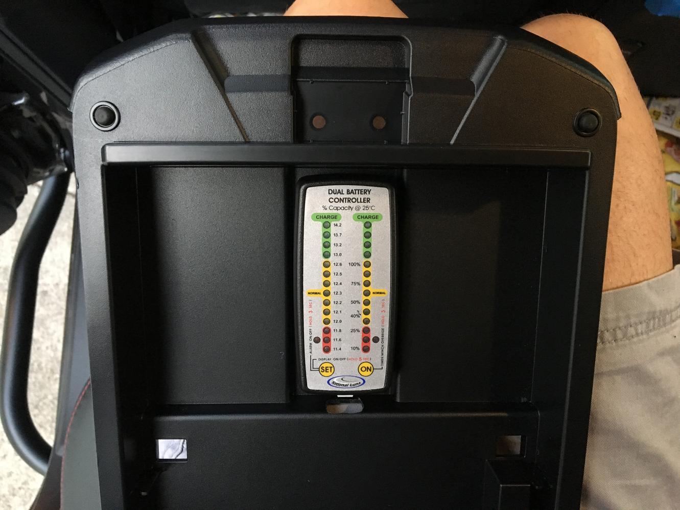

National Luna controller stealth install in cabin
I found a great place to route the cable and mount the dual battery controller - under the center console lid. Very easy to do and my favorite feature - one button jump start from the aux battery.
I'll only be turning the controller on when I do trips since the lights are always on even without the key in the ignition. I don't drive the 4Runner daily so I don't want the battery to die.

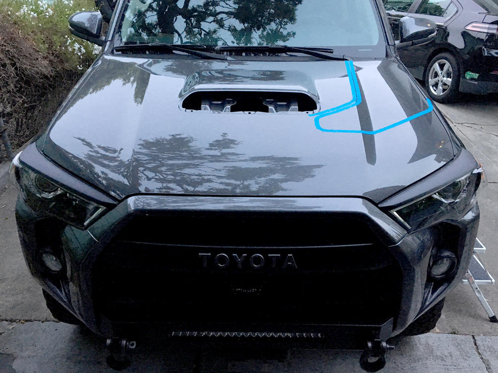

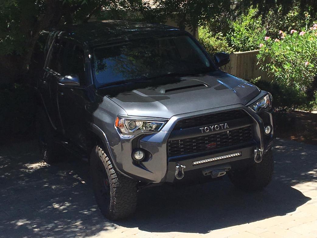

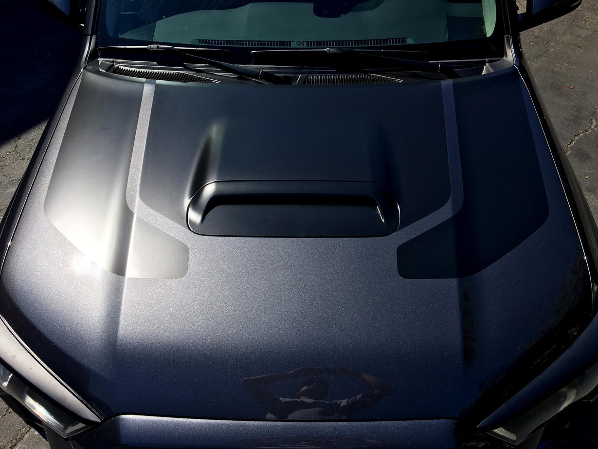

Hood vinyl to prevent light refraction into cabin
I've been intent on laying down flat or matte black vinyl on the hood to prevent light refraction into the cabin. I've seen 2 problems where this occurs: 1) sunlight reflects off the hood scoop at just the right angle and 2) overhead, roof rack mounted LED light bars where the reflection of the lights in the hood weakens the driver's night vision.
I wanted to come up with design that would provide full coverage of the hood from the driver's position but also give it some styling that would flow well with the vehicle. I used the existing angles of the front end and hood, the hood creases and the Toyota truck "T" as inspiration. The "T" is sort of visible at the front of the hood, upside down.
I'm sort of on the fence with the design after having it on but it's functional. I may do some side designs later to provide some protection for pin striping and opening doors. My bad on the low quality photos.
