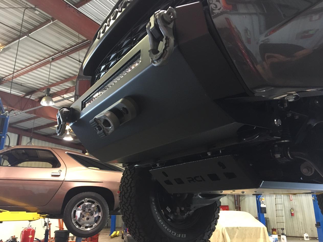

RCI 1/4" Alluminum Skids Powder Coated and Installed

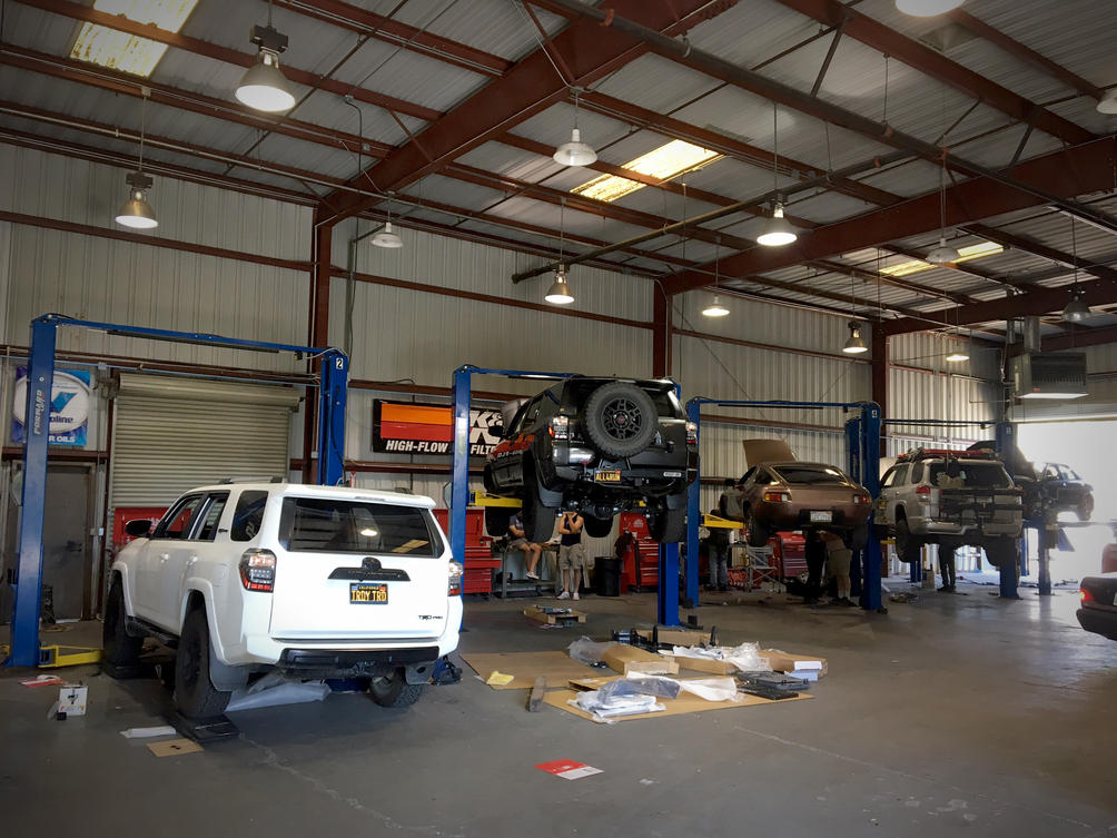

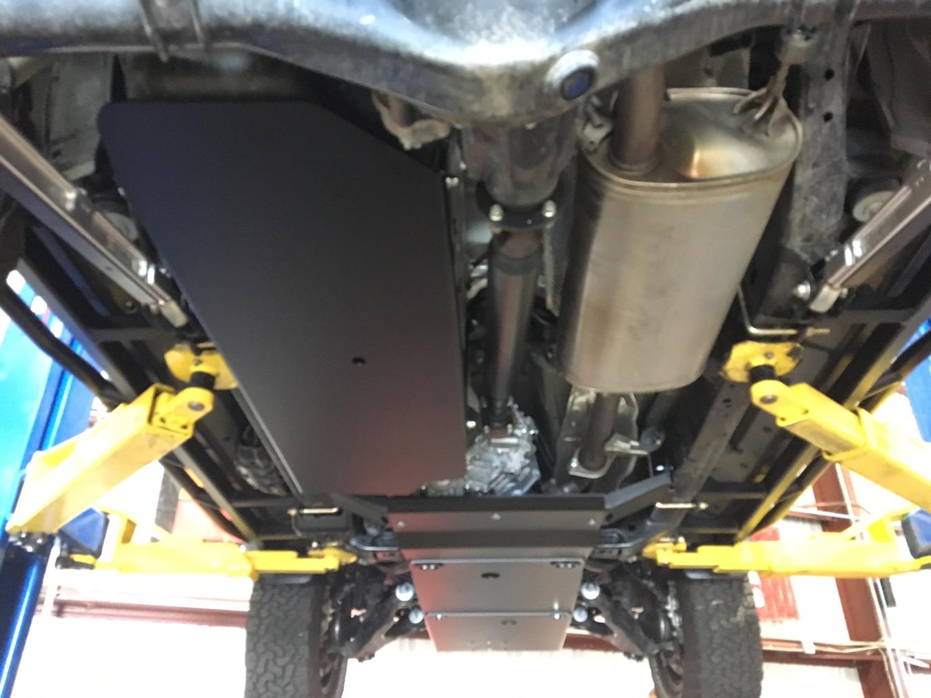

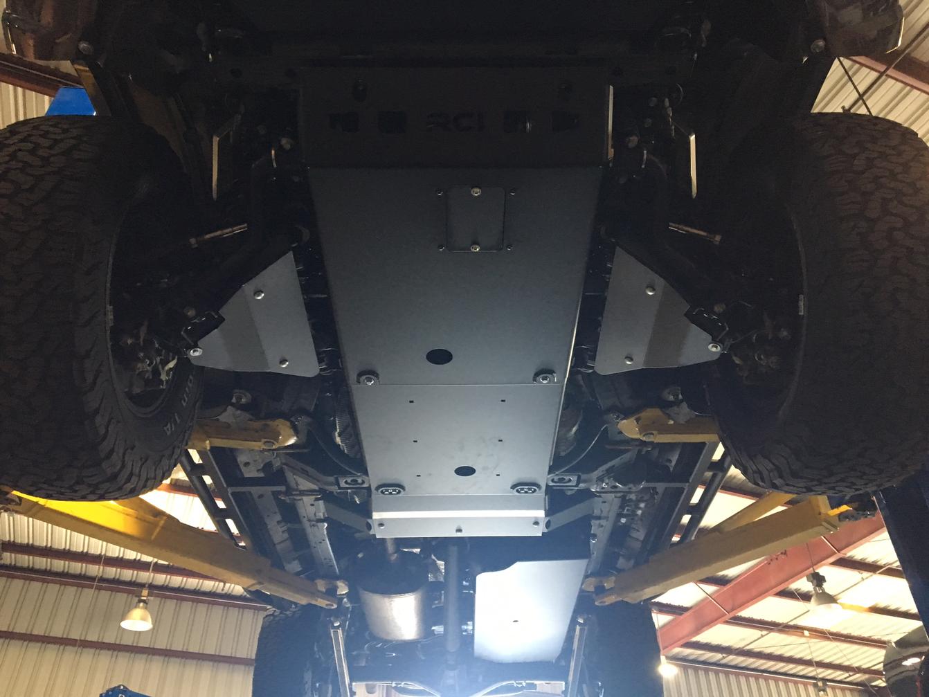

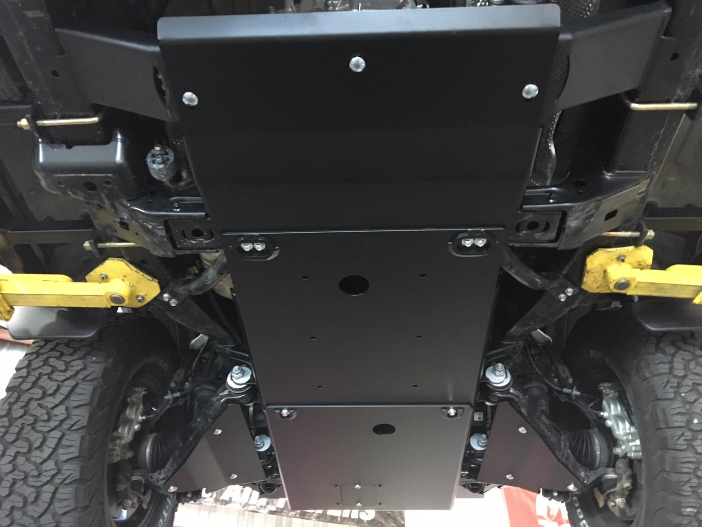

This past weekend, a few forum members and I went to town at Pit Row, a local shop that rents lift bays and tools by the hour. Myself and my twin brother, IN4RNO, with the Inferno Red TRD Pro installed our RCI skid plates. TRDYTRD installed new sliders and XTREMELUCK got his new ICON stage 7 components installed. As usually, the always-willing-to-help good friend, InfamousRNR, helped everyone out with their installs.

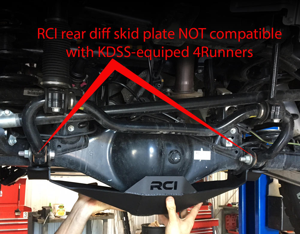

I was bummed to find out the RCI rear diff plate will not install on a KDSS-equiped 4Runner, however, RCI confirmed they are currently beta testing one now, though not sure when it will be available to market. Today, no company makes one so we'll have to wait for RCI to be the first but I'm glad they're stepping up to design one for us.
Another small disappointment was that the rear most U-bolts on each of my White Knuckle Offroad sliders prevents the RCI rear trailing arm skid armor from going on. They could be cut shorter and welded on but we'll see about that another day.
I had my skids powder coated matte black to match my SSO front bumper to coincide with the vehicle's black and gray theme and to serve as an indicator of where I hit things based on where paint scratches off, making it easier to spot and survey damage. Skids included A arms, front, transmission with added supports, transfer case with frame cross member and fuel tank.
We forgot to wrap our exhaust pipes with heat shielding wrap to dampen the rattle banging of the exhaust against the skids so we'll be heading back to Pit Row this weekend to wrap the pipes and get TRDYTRD's skids on his white TRD Pro.
Overall, I really like the quality, design, engineering and simplicity of RCI's 1/4" aluminum skids plate package and very happy with the purchase. We'll have to review how they perform on the trails in a later post.

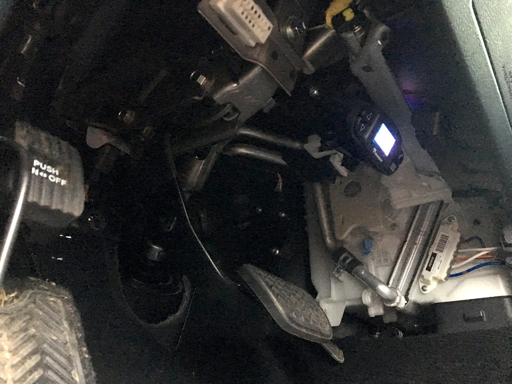

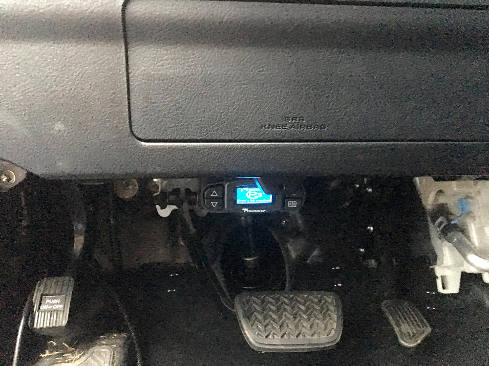

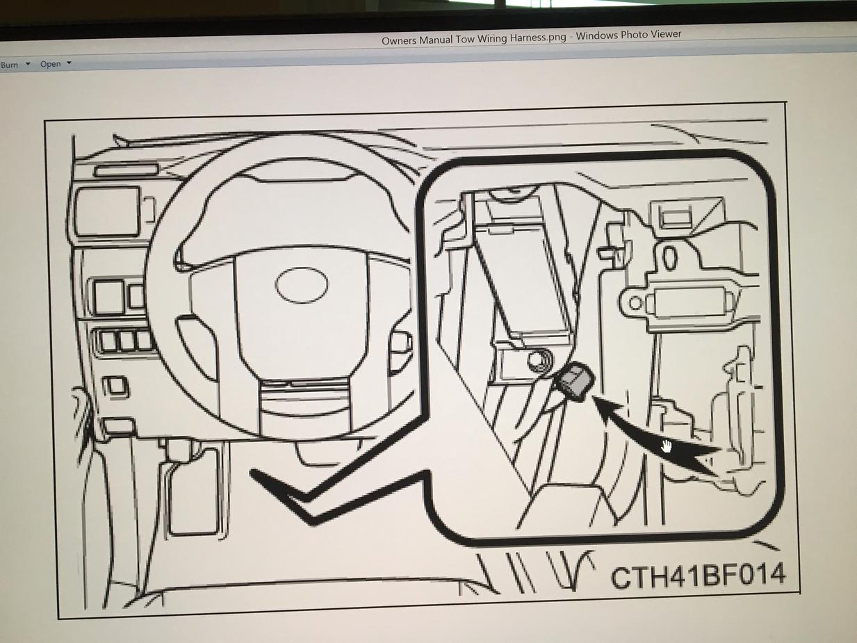

Installed Tekonsha P3 90195 trailer brake controller
Today I installed the Tekonsha P3 trailer brake controller in a rather stealthy location, directly under the steering wheel in the foot well. Luckily, the controller bracket bolts right on to 2 factory bolts that appear to hold the lower air bag unit in place. Very easy and fast install.
I'm a tad concerned about the location not providing ease of visibility to the display screen for info/alerting but the buttons for brake boost and increasing or decreasing trailer braking are easily found without sight due to their large tactile shapes. I do like that it's out of the way and keeps the cabin clean and neat but I'll asses the location after actually pulling the new camper trailer home in early September.

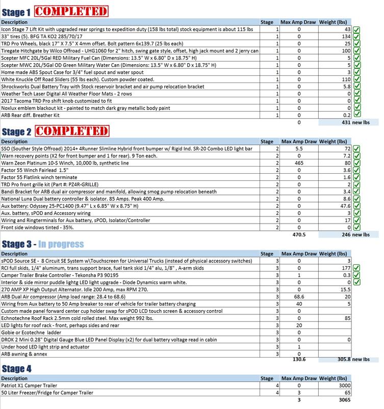

Build stage list updated...
On to Stage 3!

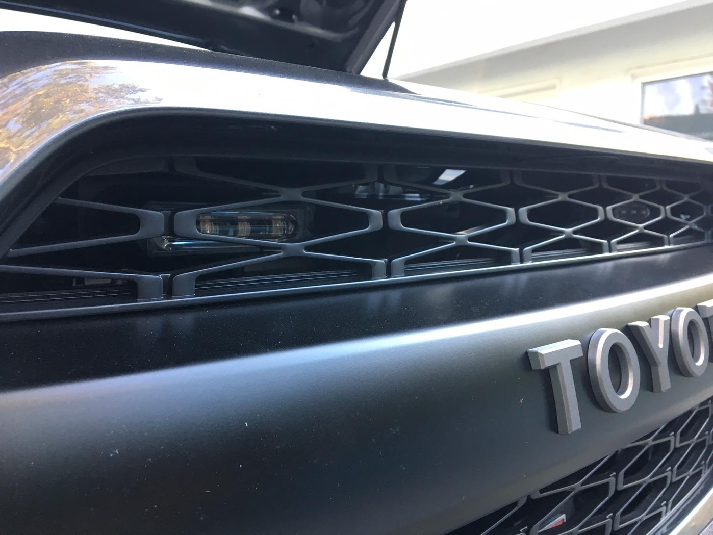

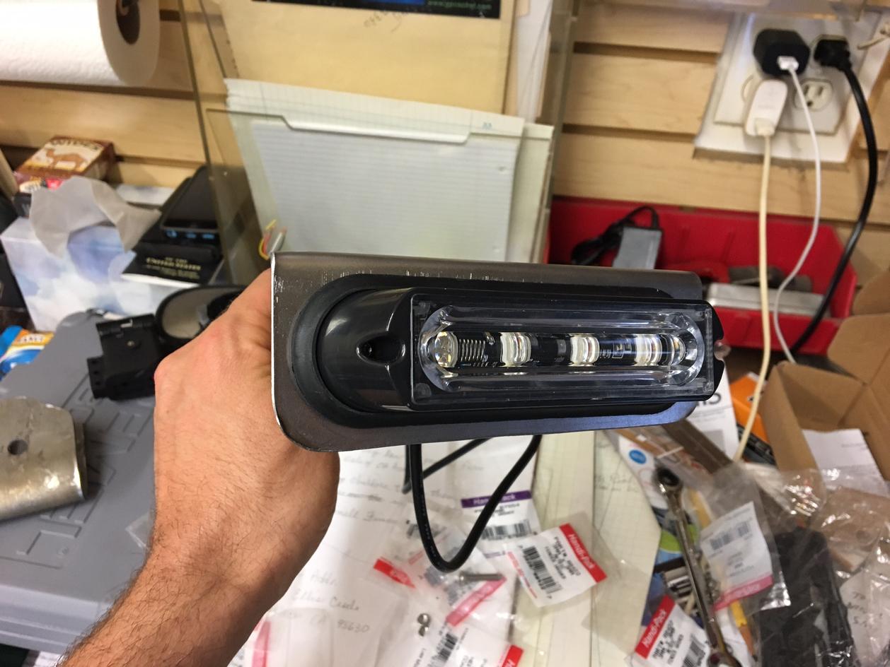

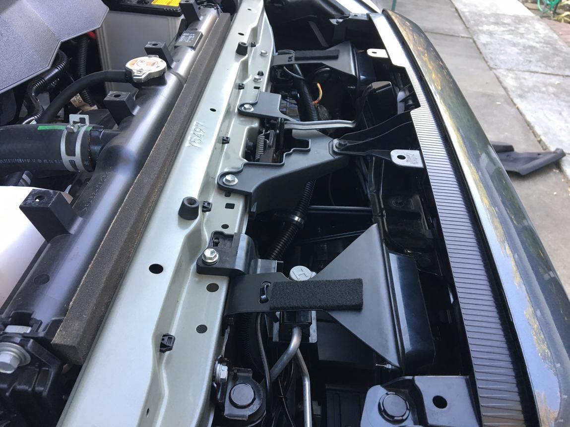

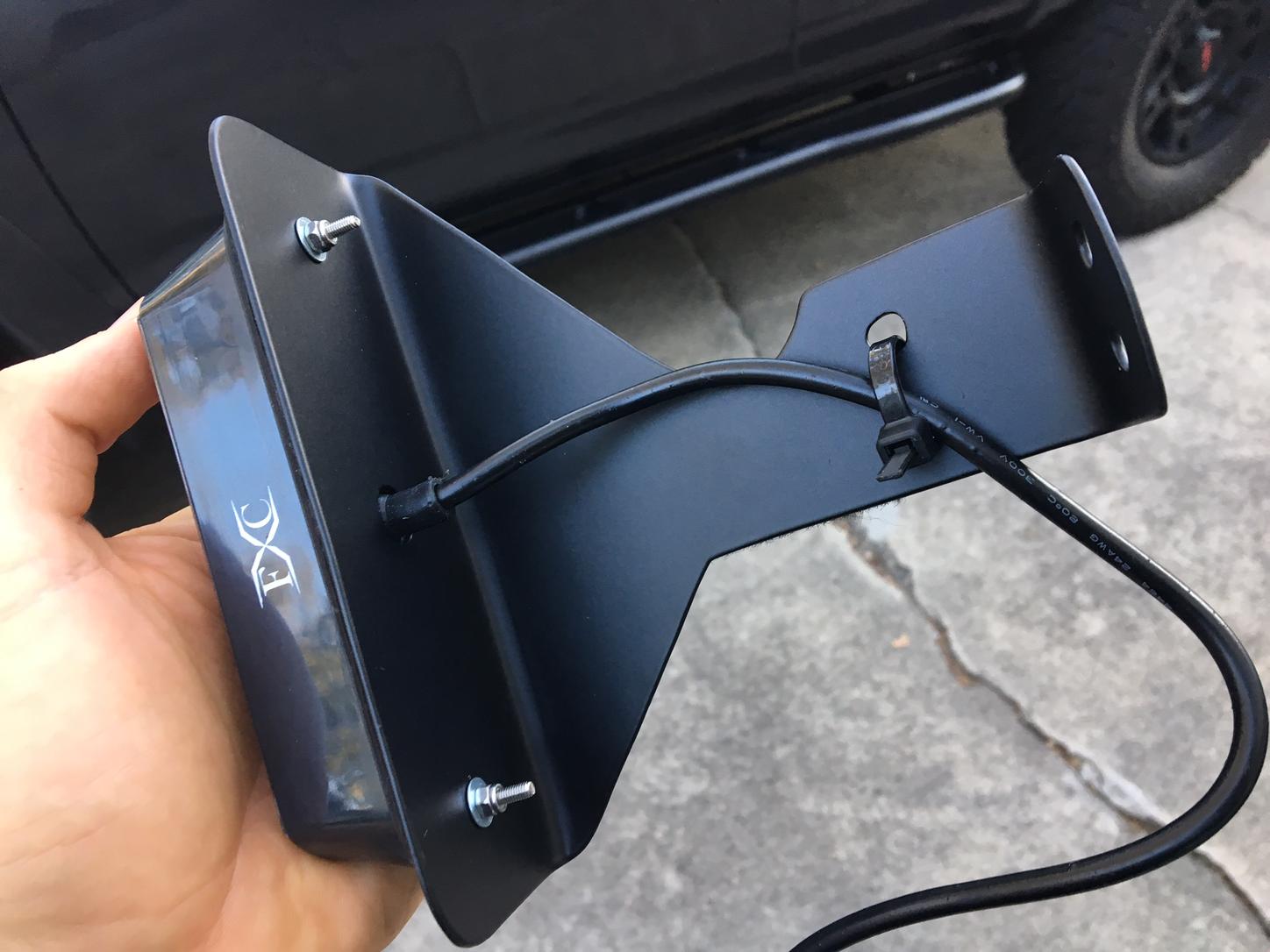

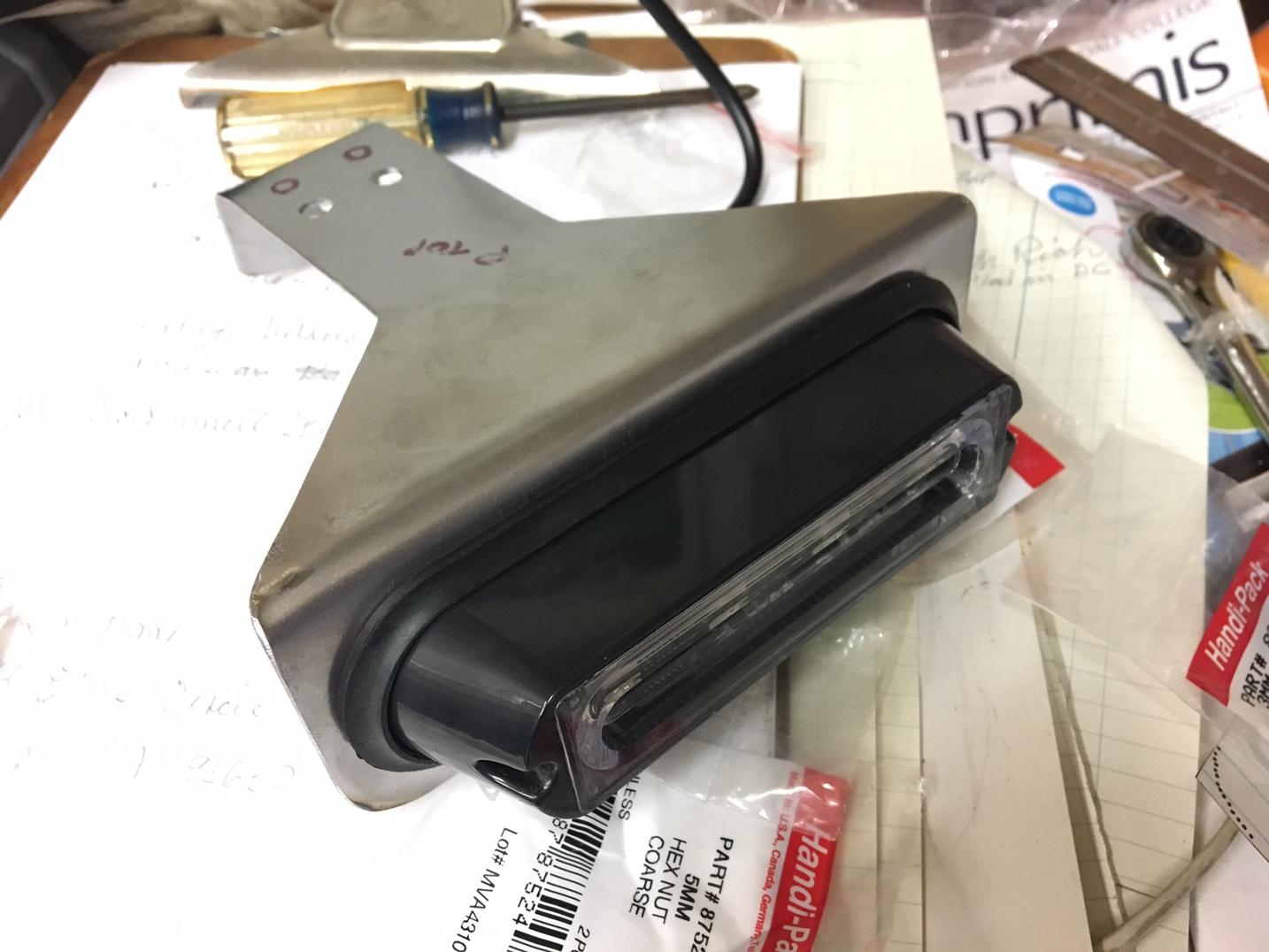

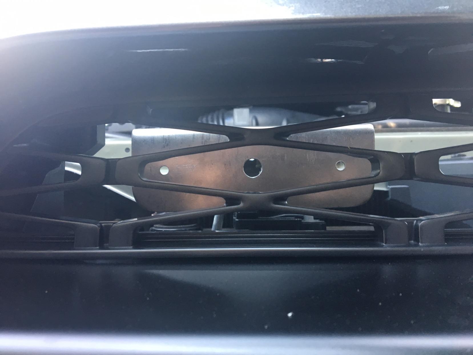

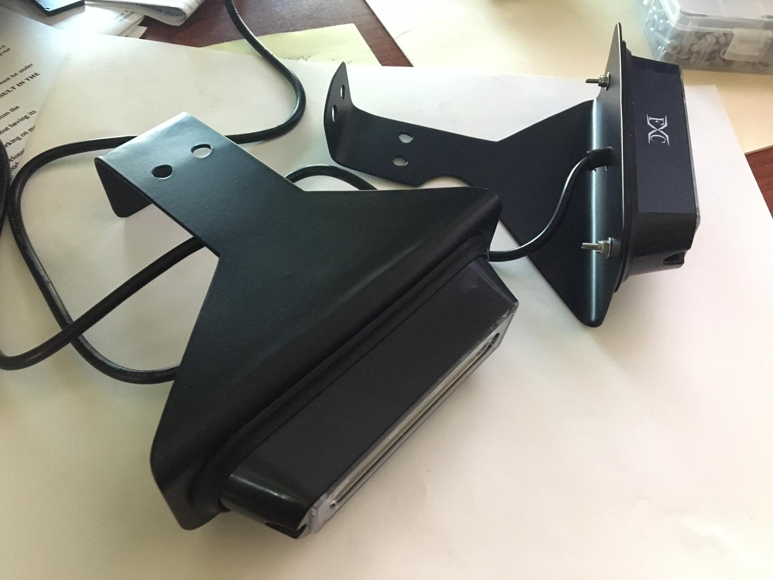

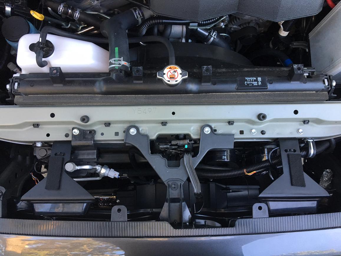

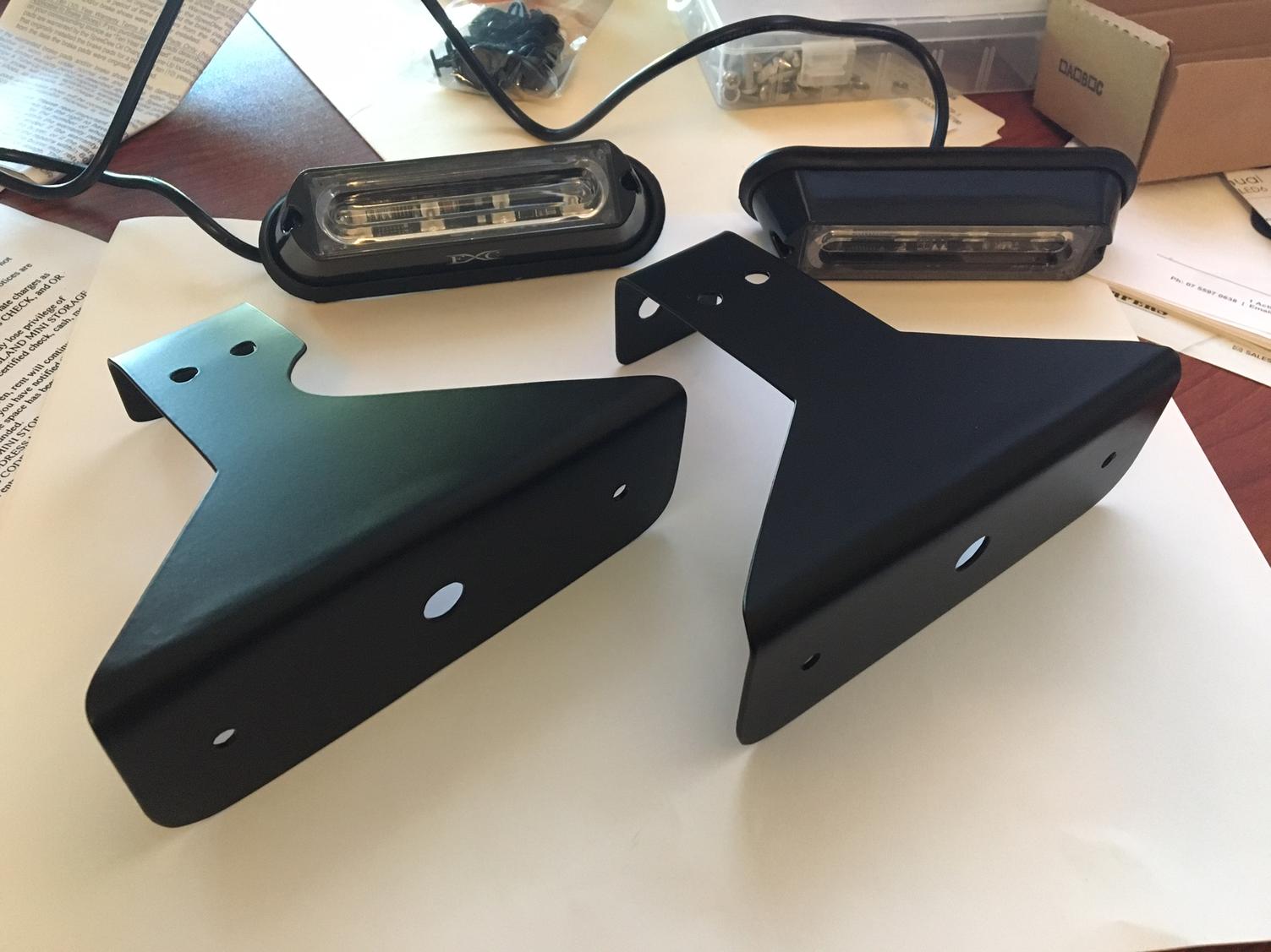

Brackets for emergency amber LED lights

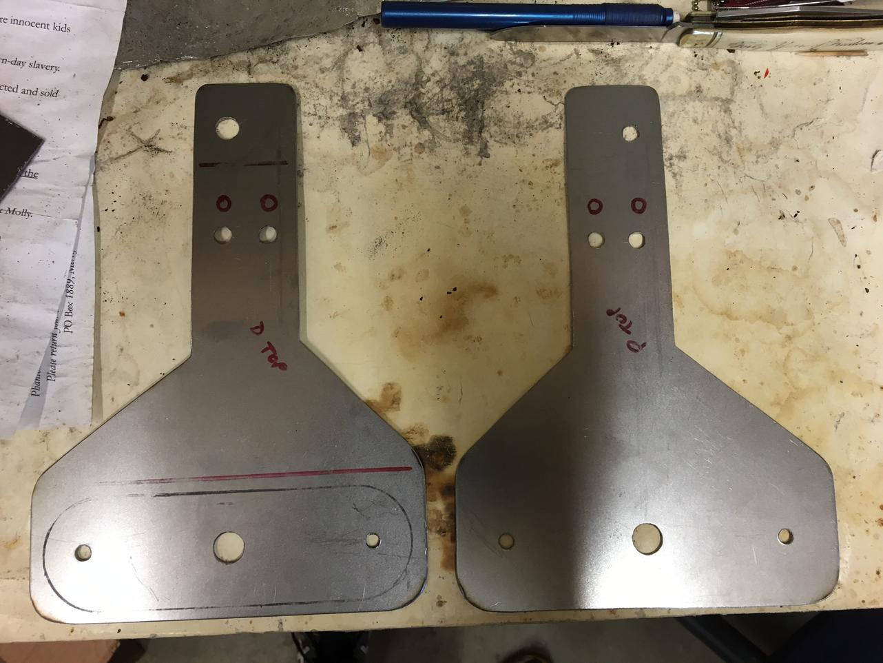

This past weekend I made some brackets for emergency amber LED lights.
The lights contain 4 bright LEDs on each, have an excellent water proof housing and a dark appearance when off, which lends to the stealth look behind the grille.
I picked these up on Amazon here: https://www.amazon.com/gp/product/B01D4282LO/ref=oh_aui_detailpage_o01_s00?ie=UTF8&psc=1

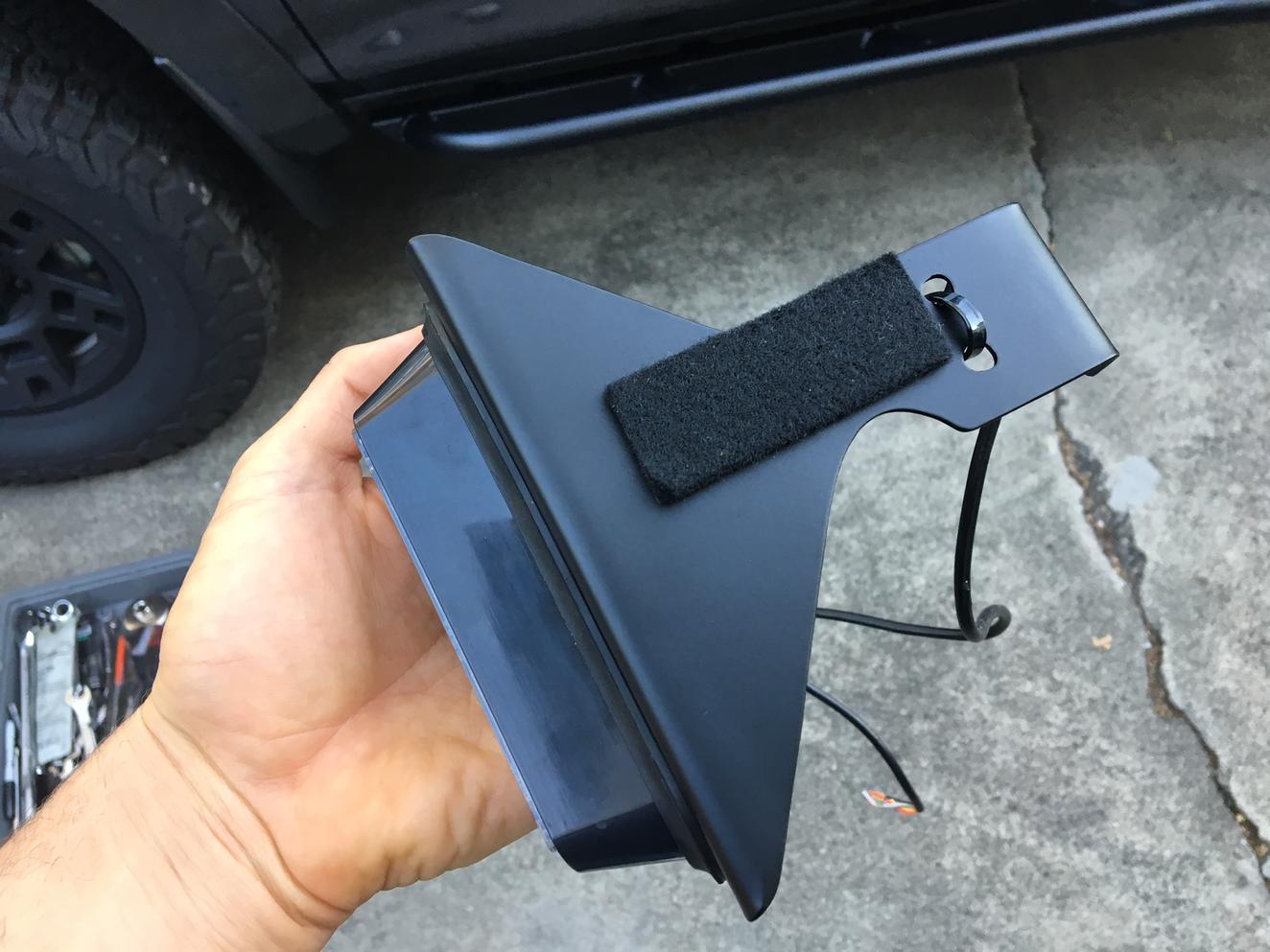

The brackets I fabricated allow the lights to be mounted behind the upper grille mesh using existing threaded holes on the upper radiator support. Because they're mounted and wired separately from the bumper, the bumper can come off and back on without unbolting or unplugging the lights.
Once I get the roof rack on and a few other emergency lights installed, I will wire them all up together to the sPOD and create strobing effects.

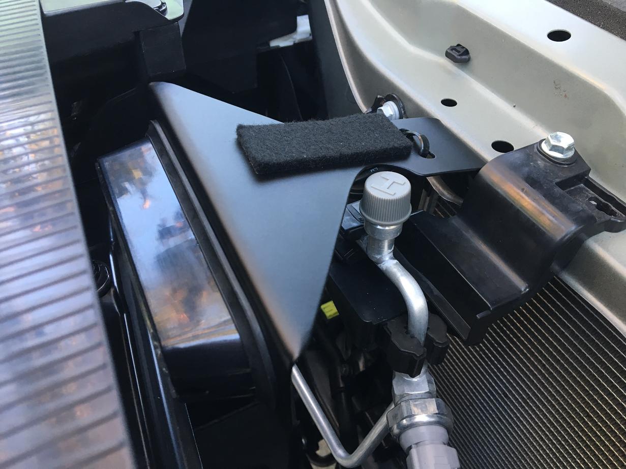

Amber light brackets continued...
Each bracket naturally points up a little higher than the intended position. I added little soft pads with adhesive to the tops of each bracket, which when the large plastic tray is installed above, pushes slightly down on the brackets putting the lights right into the position I wanted behind the grille. This tension between the bracket and upper tray prevents the bracket and lights from vibrating or bouncing up and down on rough terrain, which would just look flimsy and silly on the trails and possibly damage the lights or shake them loose over time.
