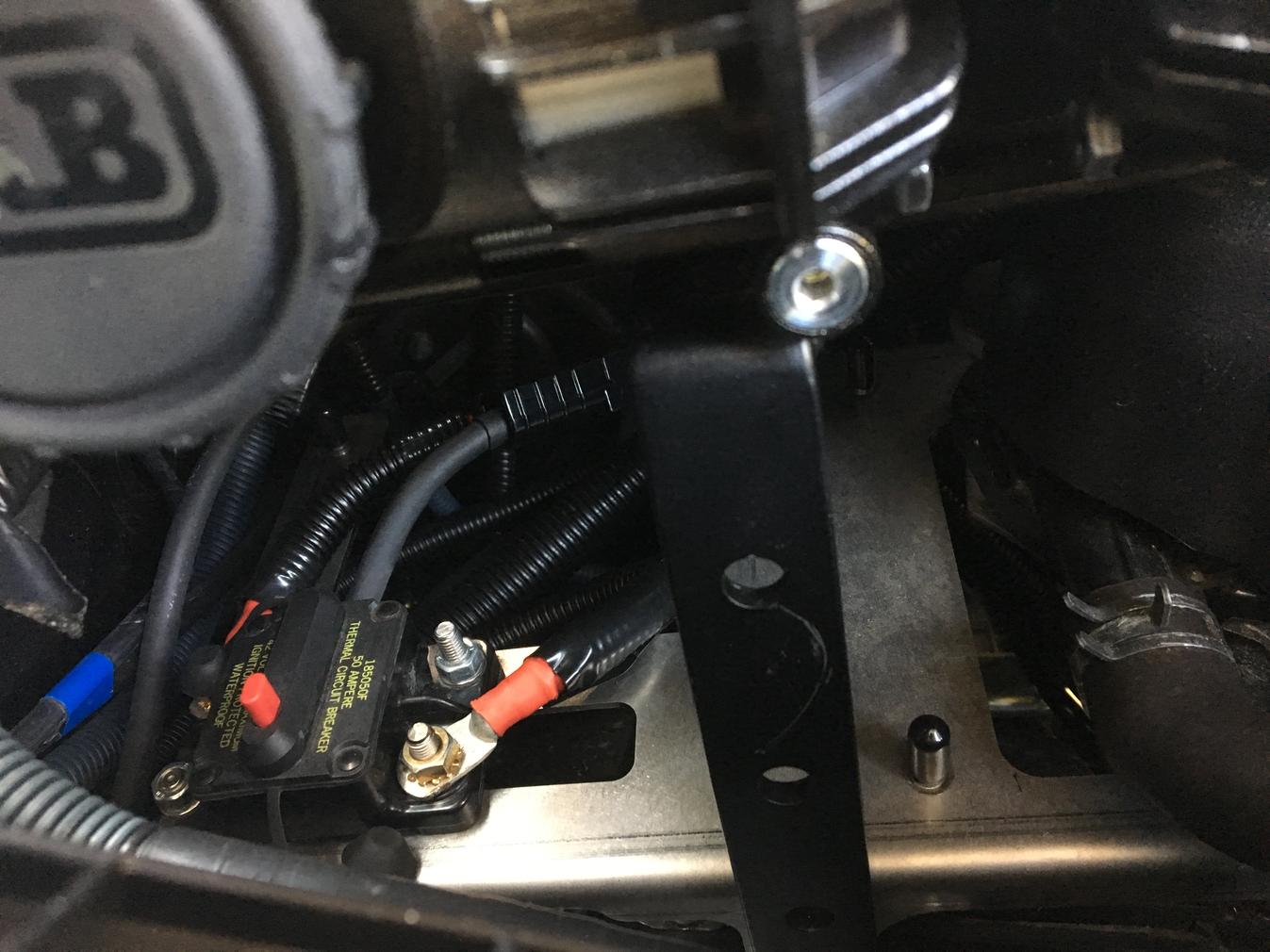

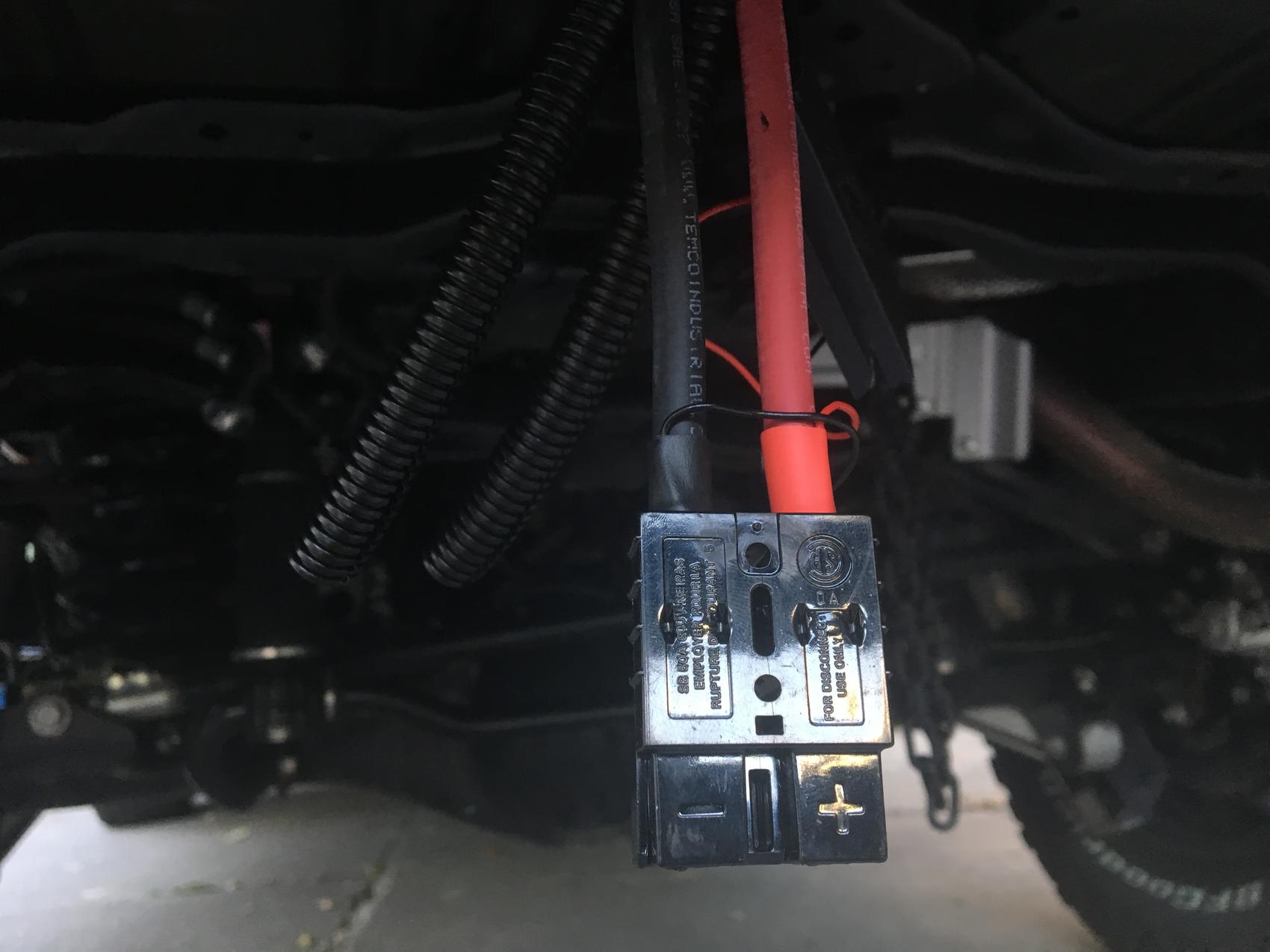

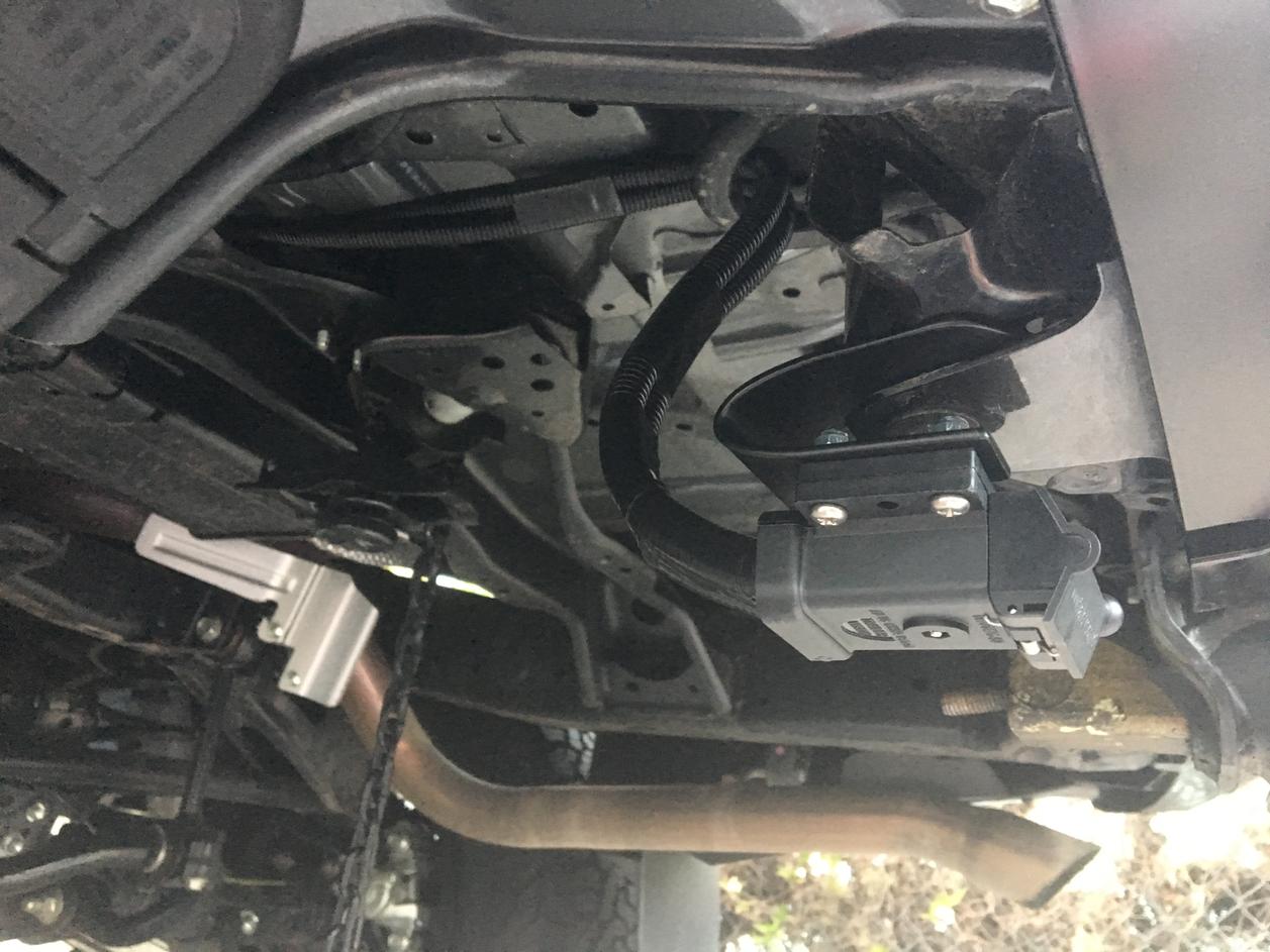

Camper trailer battery charger installed

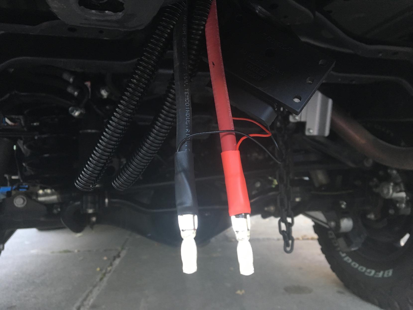

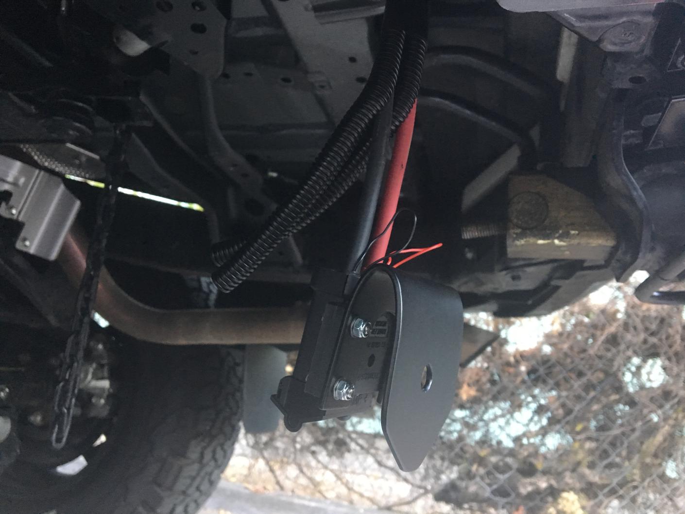

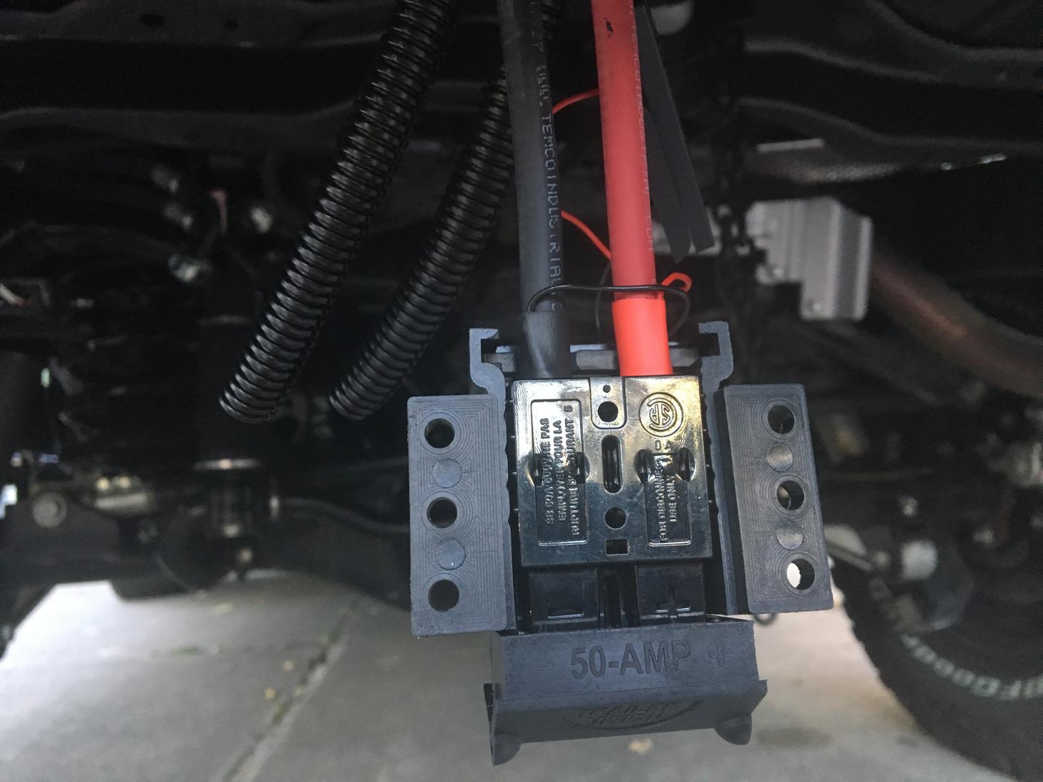

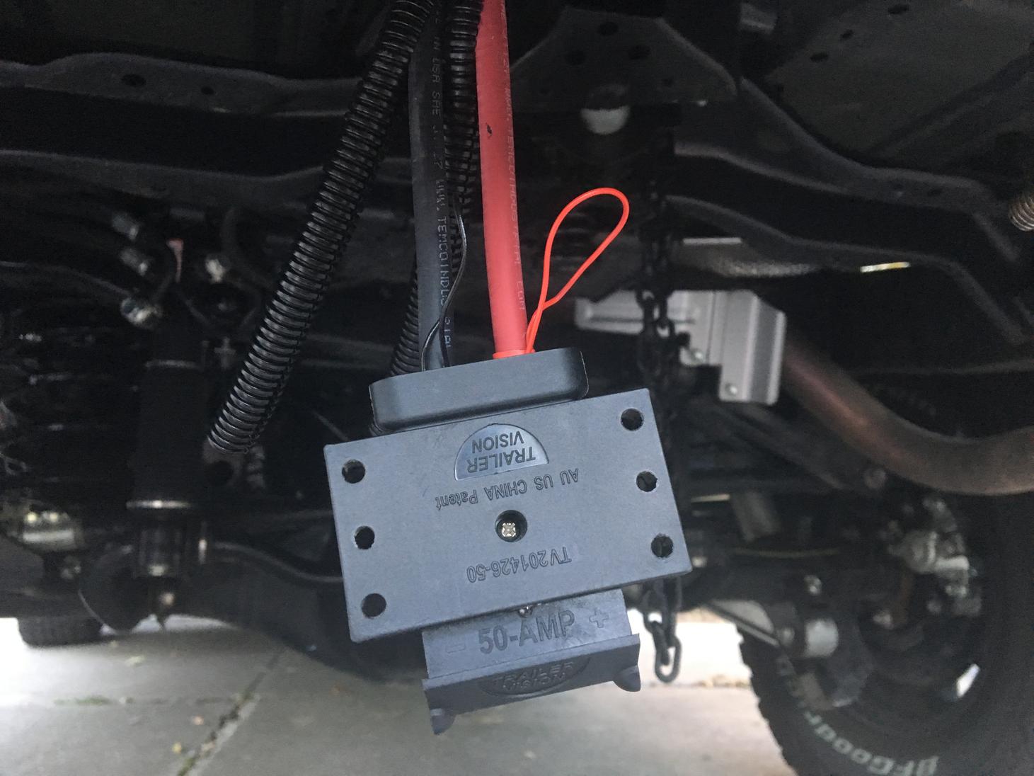

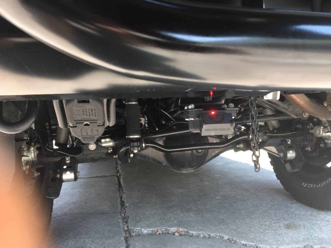

Today I added new 6 AWG welding wiring from the aux battery to a 50 amp circuit breaker with wire running to the rear, terminating with a 50 amp Anderson plug and weather proof TrailerVision housing with spring loaded, sealed door and a nice red LED light indicating power. I made a custom bracket to hold the unit which can mount in multiple locations if need be.
This will charge 2 lithium polymer 12V batteries on a camper trailer that I'm taking delivery of this weekend in Las Vegas. I'm pretty stoked but not about the 20+ hour round trip drive.
It was important to have a circuit breaker in line so that when doing water crossings where the plug at the rear may submerge, power can be cut by maually switching the breaker to prevent a short. I'm planning to leave the breaker "off" unless I'm pulling the trailer.

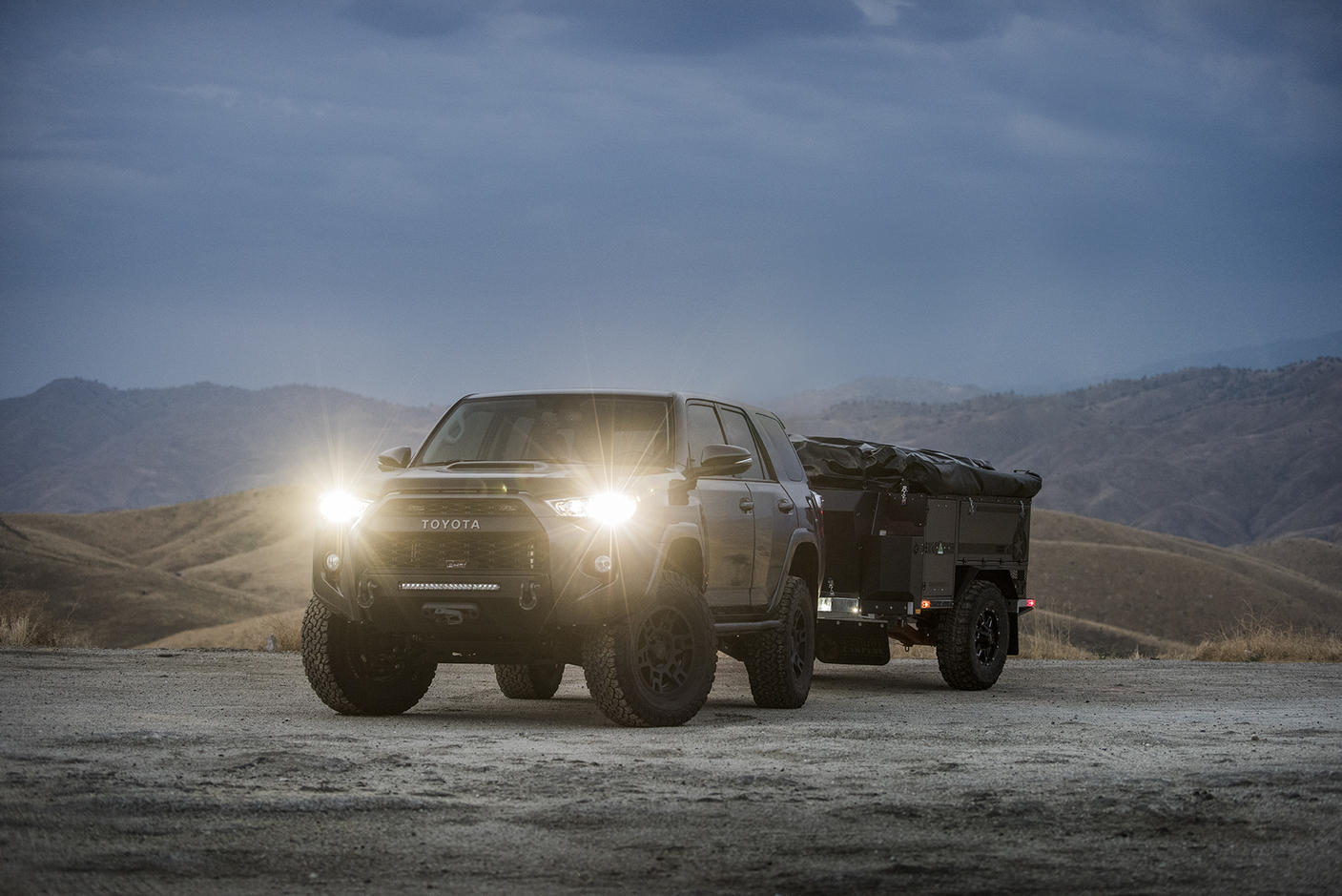

Camper Trailer Acquired! Patrior Campers X1 GT
Well, I've gone and got a camper trailer. I decided on the trailer after considering adding a fridge, roof top tent and other items to the rig would add too much weight, raise the center of gravity, making it more difficult to handle the 4Runner in moderate to aggressive off-roading, especially with passengers.
I've been a big fan of the Australian-made Patriot Campers for over a year, after finding them on YouTube. I haven't been really enticed with the U.S. camper trailer market so far, so I looked into importing an X1 but it was too complex and costly so I thought I'd wait and see how the nascent U.S. market develops over the coming year or two. But then I heard the news at SEMA early this year that Patriot Campers would be coming to the U.S. this summer.
I ordered one in early spring, becoming their first U.S. customer. Justin, the owner/founder personally delivered the first U.S. shipment with a full run down of the trailer operation. He's a class act and a great guy with a tireless work ethic.
I have to admit, photos don't do this thing justice. It's truly a masterful work of engineering, refined metal craft and a practical, makes-sense design all around. The attention to details are incredible and I'm stoked to take it out to remote locations where no running water or bathrooms exist while still being able to enjoy a convenient outdoor experience.
I wanted to be able to camp, set up quickly, unhook and roll out on the trails during the day, and that's just what I did with the X1 this past weekend for its first camping adventure at Shaver Lake and Bald Mountain.
I learned a lot about using the trailer efficiently, or rather inefficiently on this first trip. I'll share more photos of that trip soon but first,for the sake of linearity, the NV desert photos from delivery day where I drove it home from Las Vegas to the SF Bay Area. I took a short detour out in the desert to see how well it handled and it barely felt like it was there.
More soon!

I'm starting in on the research for deploying a dual battery set up. Here's what I have so far:
Design considerations:
-Aux battery: Odyssey 25-PC1400 (850 CCA, 65 Hrs at 20 Hr Capacity)
-Aux battery tray: Shrockworks with air pump relocator
-National Luna Isolator and battery controller
-Support all non-factory accessories via an auxiliary battery
-Ability to jump start from the auxiliary battery
-Support Warn Xeon Platinum 10-S Winch (311 to 465 Amps)
-Support ARB Dual Air Compressor (CKMTA12) with room for bracket
-Power sPOD Source SE with 8 channels for smaller sub-30 Amp accessories
-Support future accessories: Inverter, camper trailer anderson plug, upgraded sound system
Per National Luna, no fuses are to be installed between the isolator and batteries, to ensure the winch may consume high non-continuous amperage draws from the system. Per Warn, no fuse or circuit breaker is installed between the winch and battery.
