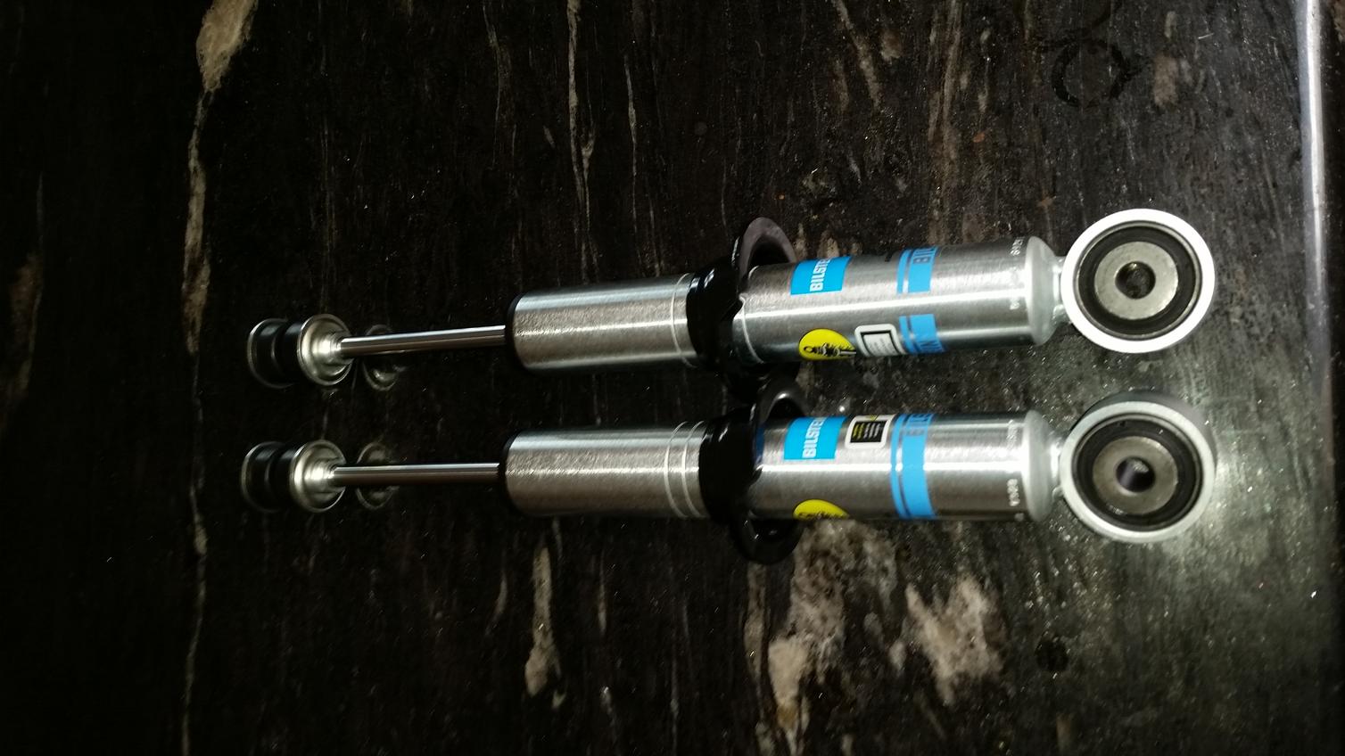

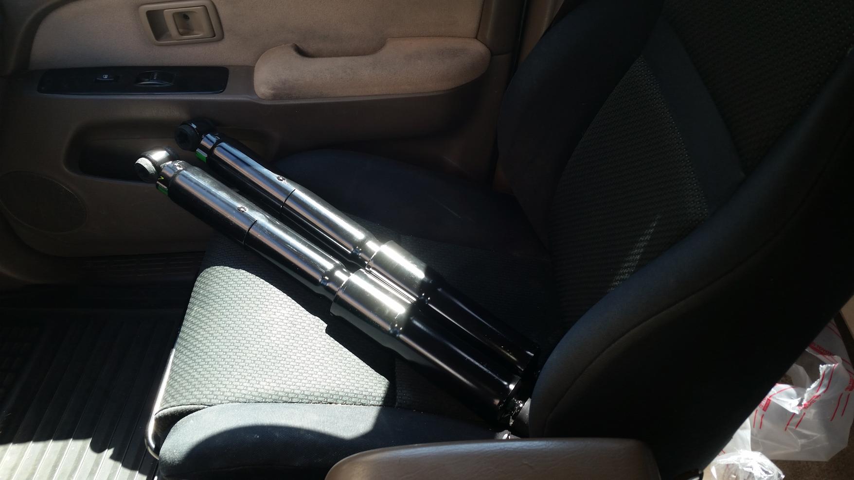

Finally haha, just waiting on the coil isolators. Bilstein 5100 adjustable in front 80 series rear tokicos in the back. Oh also look what seats the black shocks are on.

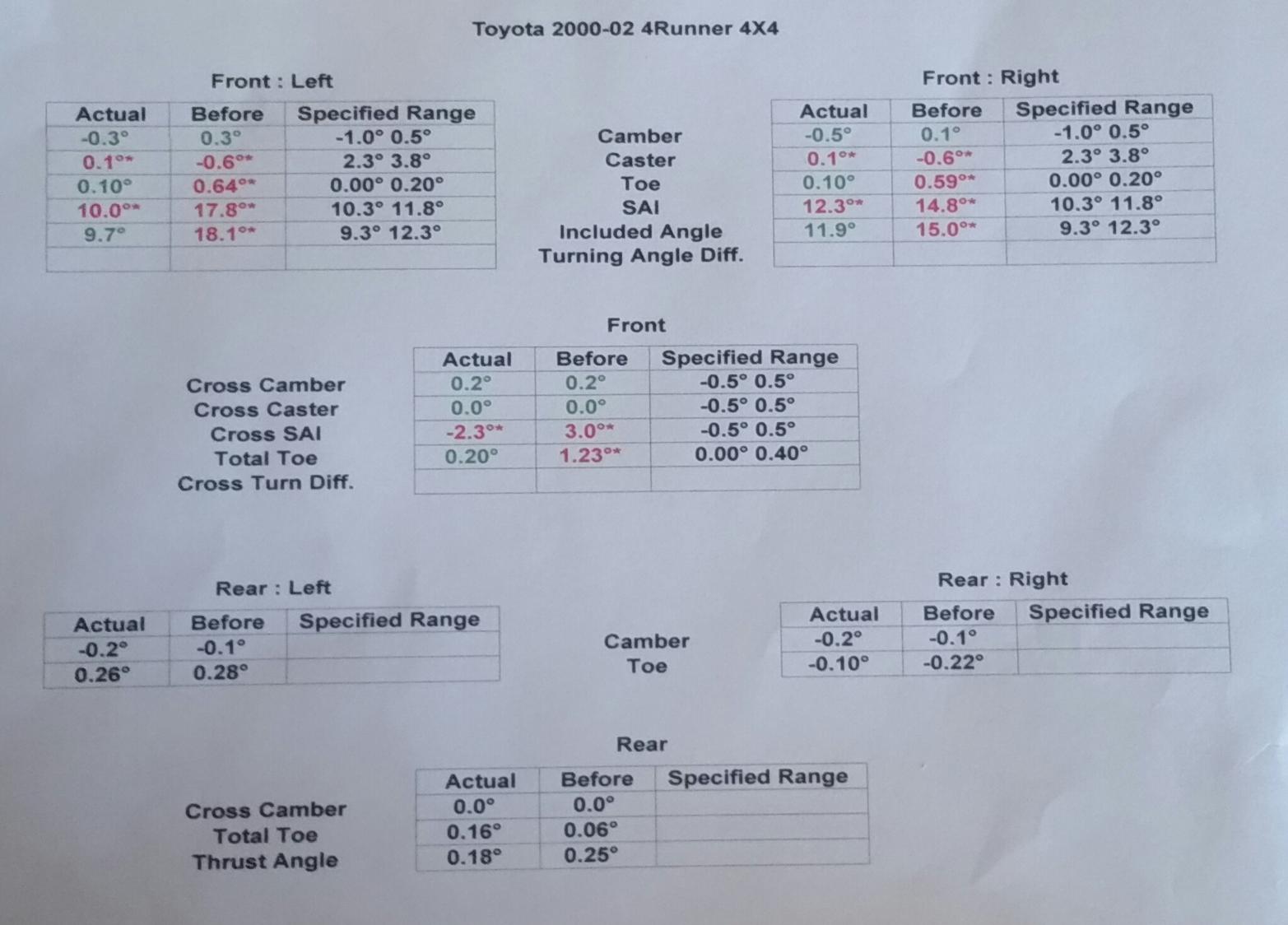

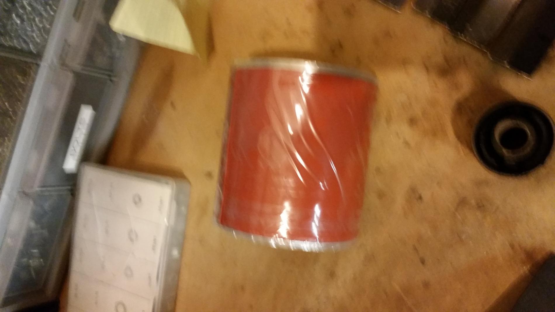

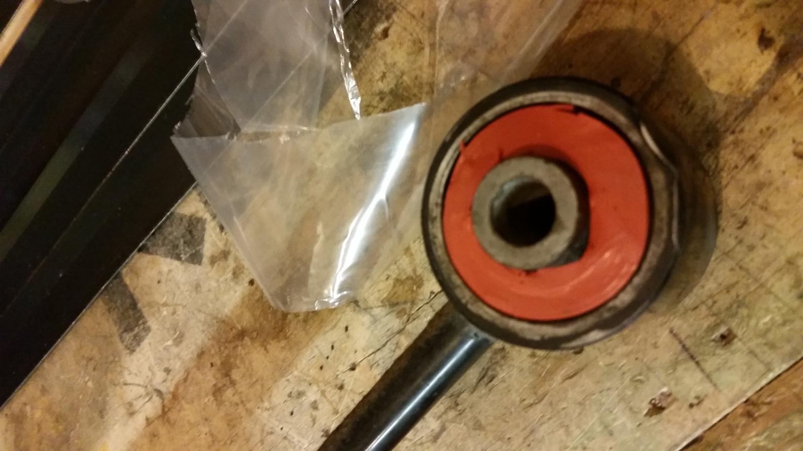

So before I did the alignment I replaced the steering rack bushings, and I had to basically make an upper control arm bushing because it had somehow come out and the link was rattling around, I used this rubber tape that sticks to it self when you stretch it, it worked flawlessly, and got rid of the clanking and slop in the rear end. I'm having trouble finding the right bushing so this will have to do for now. Earlier today I got the alignment done and the truck feels great now. The caster is not even close and that's all caused by the lift, the front being lifted affects the actual caster, also because the rear is higher it angles the entire truck by 1.3 degrees so the caster will be negative by 1.3 degrees. So if the back was lifted the same as the front I would have a caster angle of 1.4 degrees

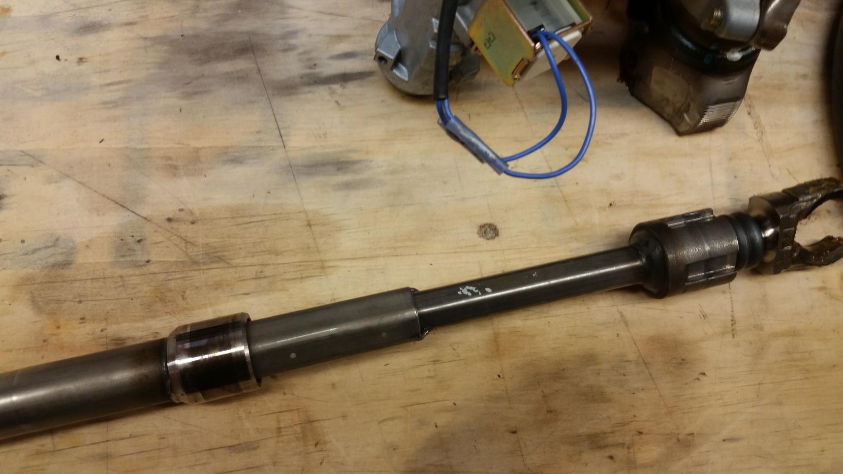

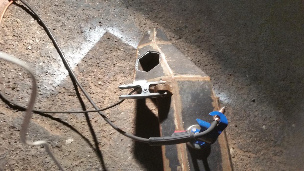

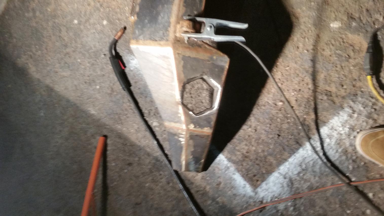

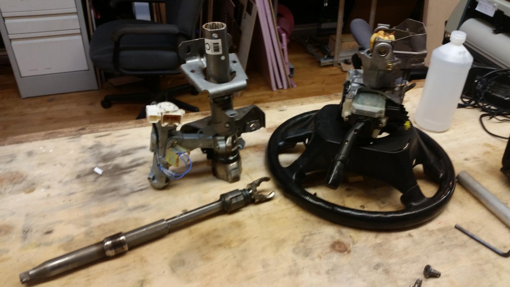

So on my first real off road trail in tucson about a year ago I noticed this terrible rattling coming from the steering, after doing a bit of research I found a thread on ttora where someone tracked the problem down to the slip joint attached to the steering wheel. By grabbing the steering shaft under the dash I found the clicking. Earlier today I took the whole thing apart and did a couple tack welds on the slip joint, I also added a rubber shim into the ball joint in the steering wheel tilt joint. The clicking is gone and the steering is way tighter now, tighter than it was when my dad bought it according to him. On the highway it used to sway back and forth out with the slightest amount of wind, now its like its on rails. I highly recommend checking out this thread if your having slop in your steering and have replaced your rack bushings, it only takes a second to diagnose. I went ahead and added the shim in the ball joint even though it probably was not nesesary, it was hot and I didn't want to spend more time sweating than I needed to if it was still sloppy. Heres the link to the thread on ttorao, the ball joint shim is detailed in post 140 here Clunking steering column/shaft? - Page 5 - TTORA Forum

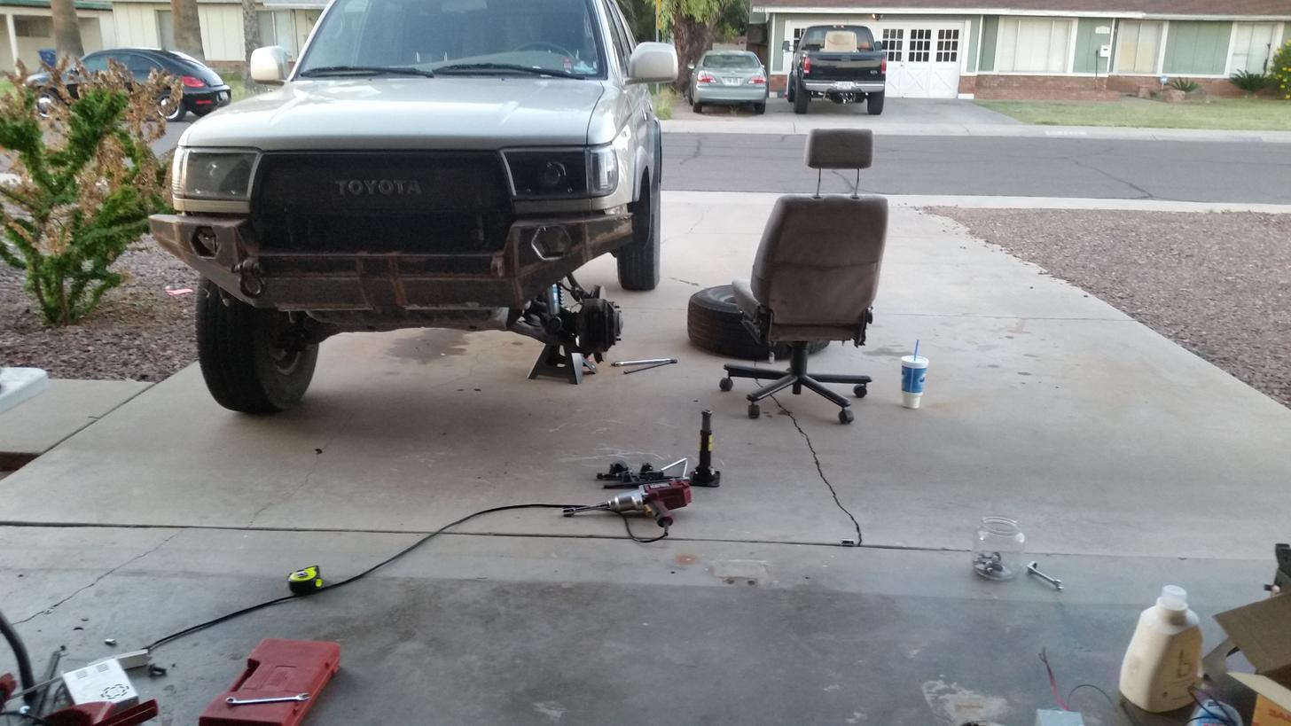

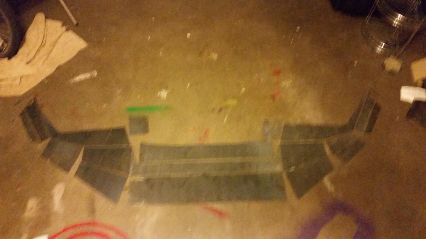

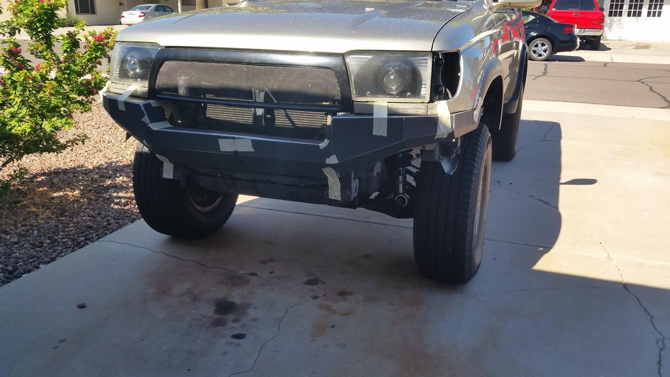

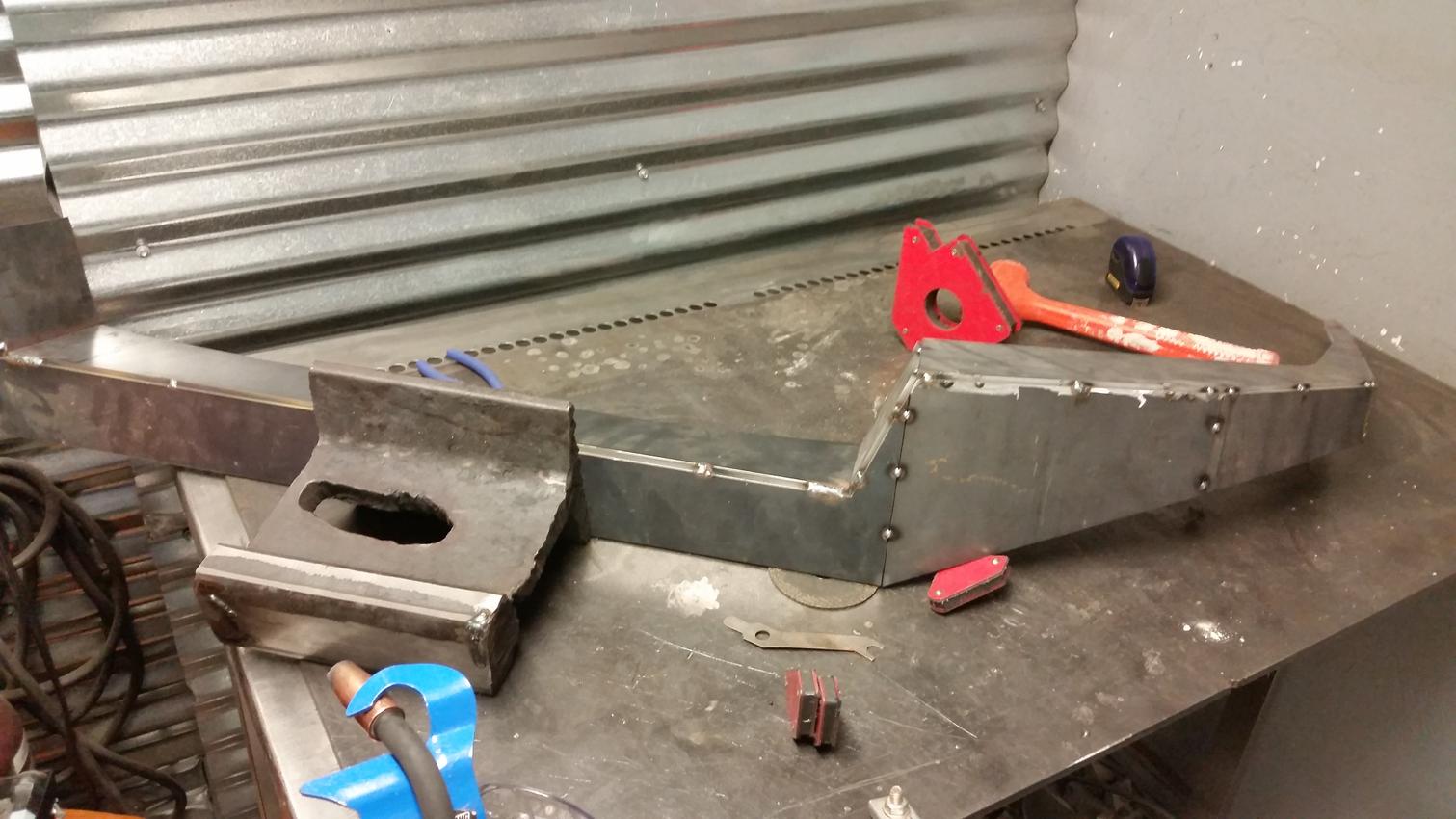

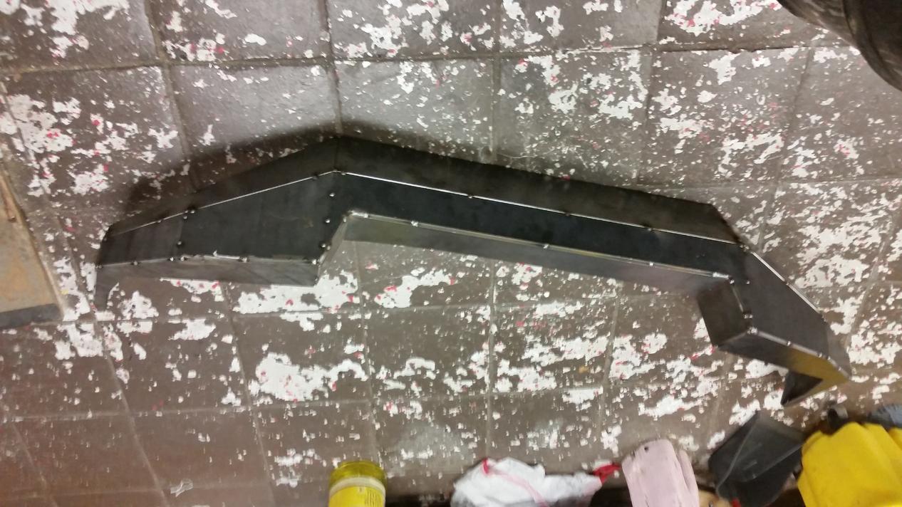

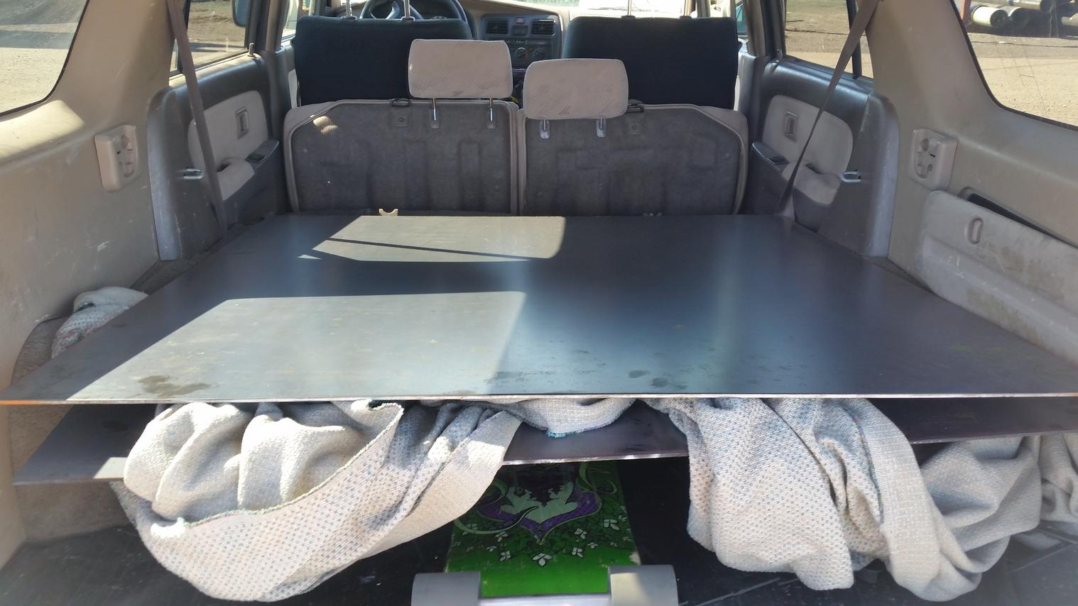

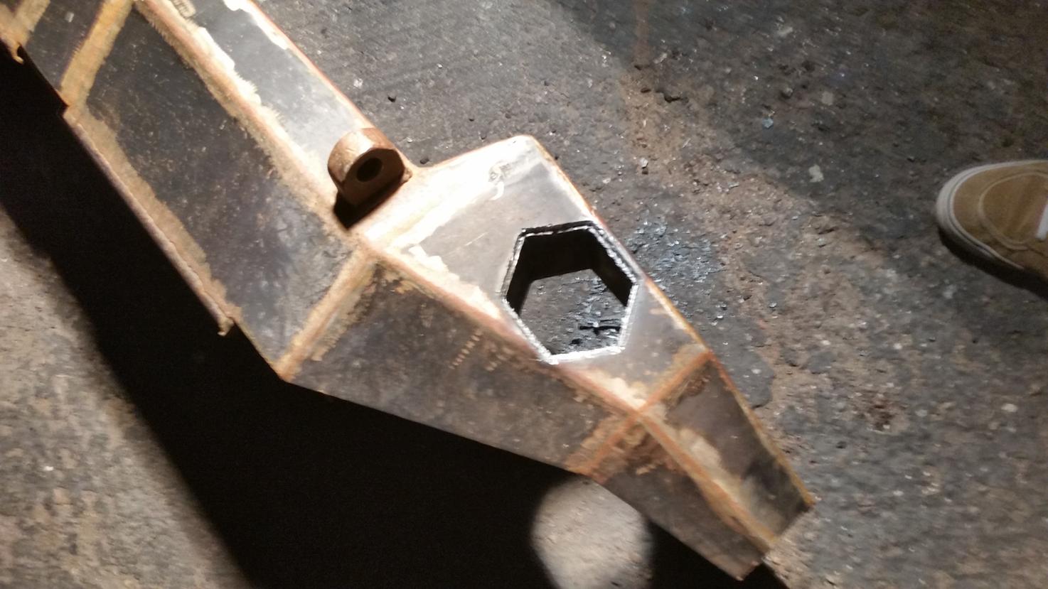

So my parents went on a trip to sandiego with my grandma, my grandma lives in santa fe and she was going to fly out, but since the ebola scare she wanted me to drive over and get her, so i drove over 1000 miles in 24 hours to get her. Anyways she helped me buy some steel and other stuff for my truck in return for driving. So i got 2 4x4 sheets of 3/16 a36, designed a bumper, cut it out on a waterjet, and got the main part of it tacked together. Just need to design the internals and then itll be done.

Hey another arizona 4runner guy, whats up. Saw the pics of you wheeling and thought that looks like az desert so looking at your sig you are in Scottsdale, im out in east mesa. Only about 15 to 20 minutes from sycamore creek and saguaro lake, some decent off road trails. We should have a 4runner meet sometime and hit some trails. I just need to get my control arm bushing, alignment and tires. Im a mechanic btw so if anyone needs help let me know i have the tools and know how to do just about any repairs or mods.
Really liking the front bumper. Looks super clean with all of the angles. I'll be waiting for those pictures of it finished!

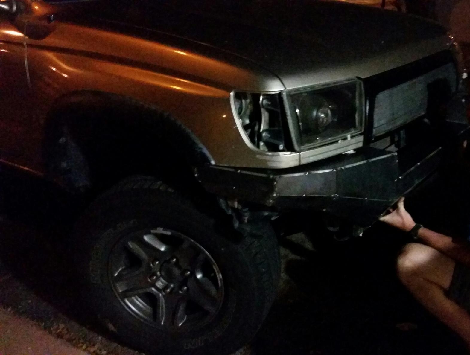

Im working on finishing up the bull bar and getting it all tacked into place, should be pretty badass with all the square tubing.

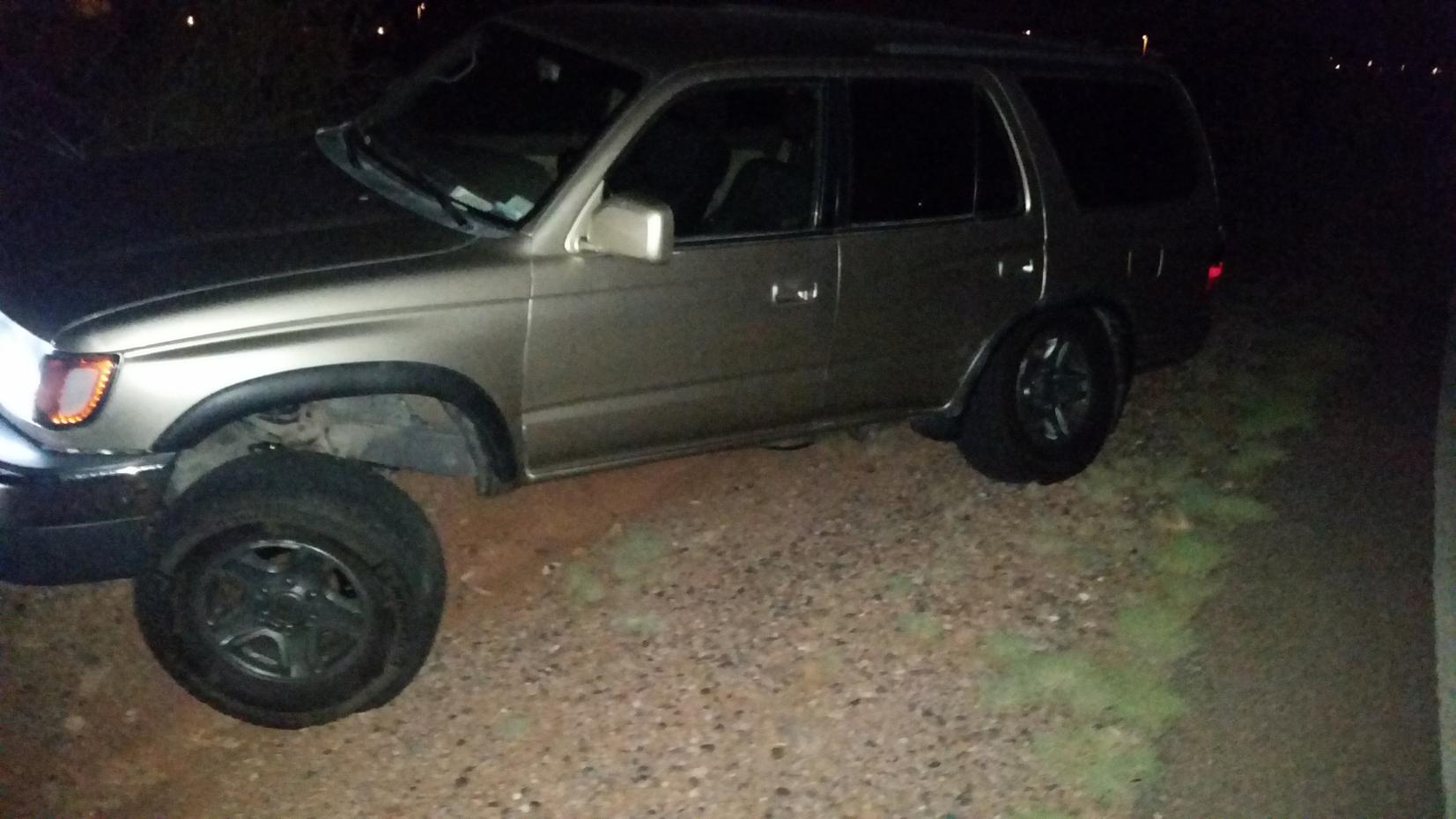

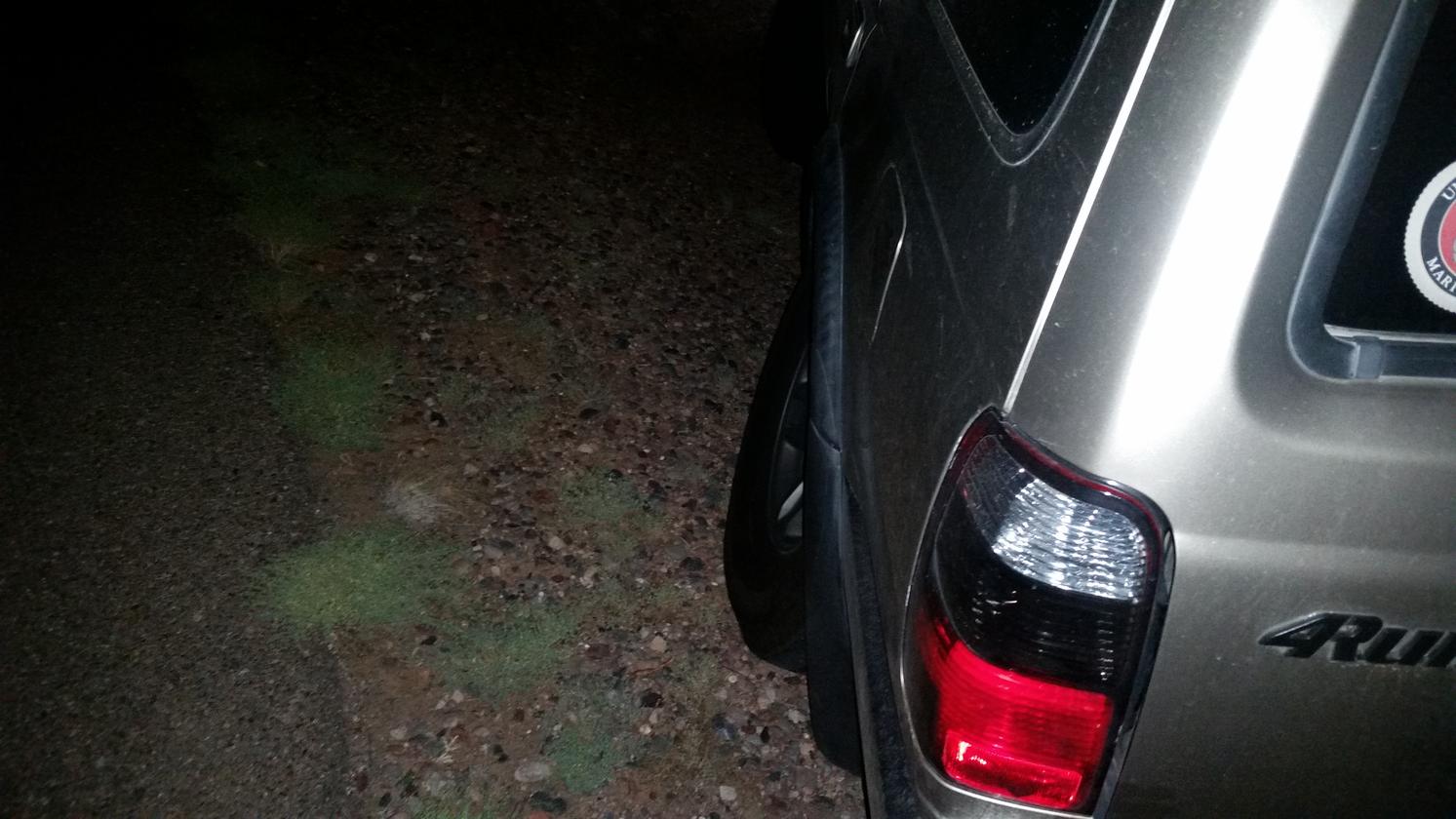

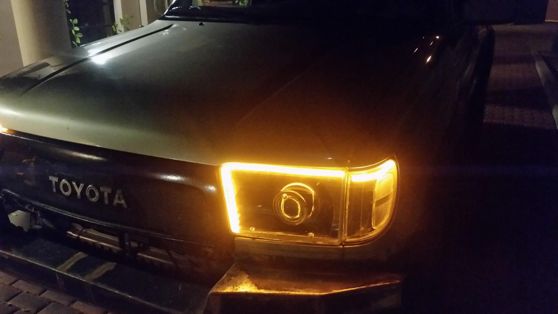

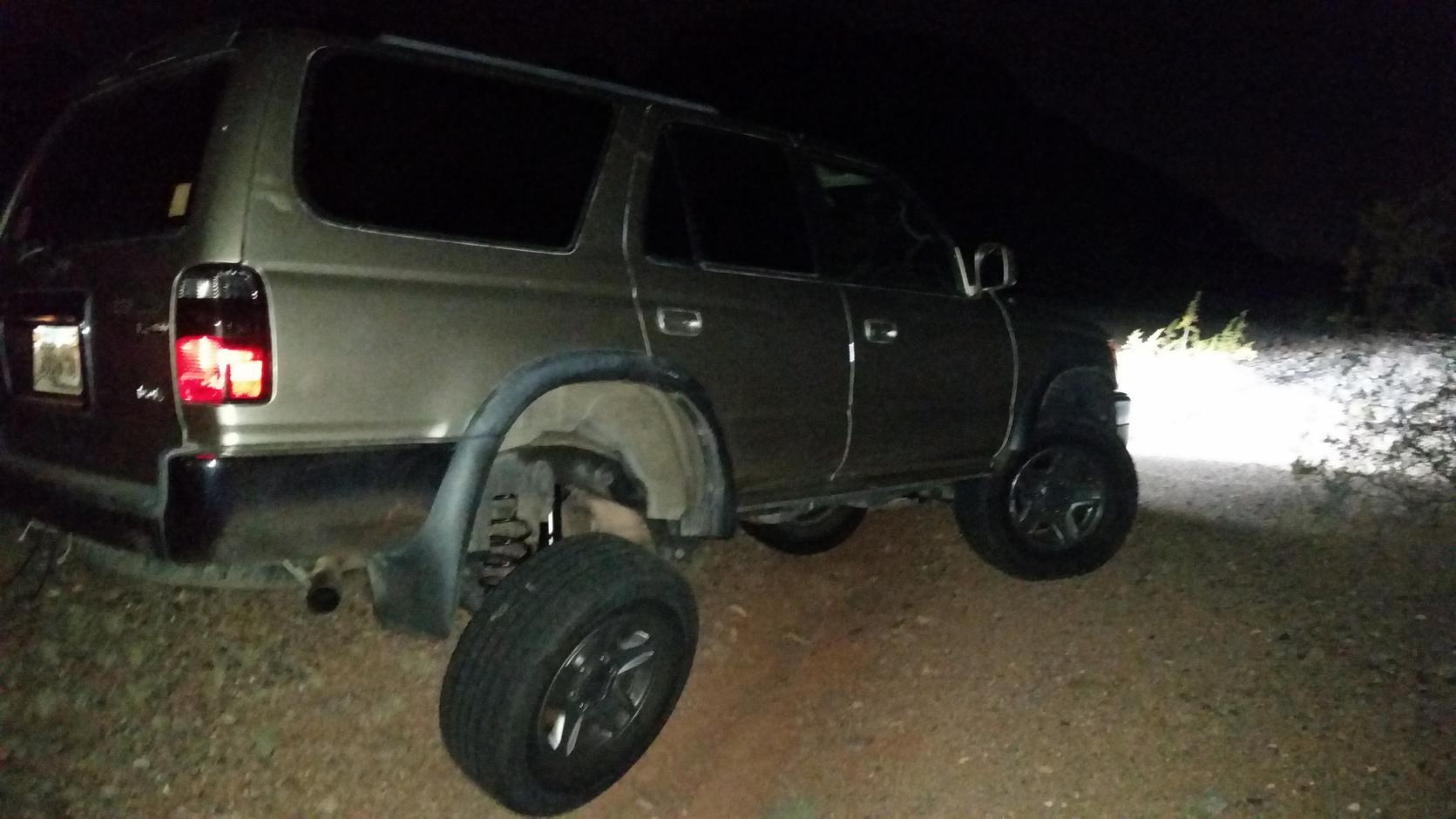

havent updated the thread for a while. ive chopped the bumper mounts and made tacoma style mounts, widened the middle part of the bumper and chopped off the sides of it and also chopped off the bull bar. ill be putting the bull bar back on but im looking for some tube at least 3/16" and 2" square. a jackass moved forward after we had all pulled over on the trail stalled and rolled back into me, and didnt pay for my headlight he crushed. i swapped the lens in less than an hour. my rear upper bushing makeshift finally failed, so i pushed the rubber out of a lower arm bushing and pushed it into the upper slot. I retrofitted corolla leds into my dads 5th gen.

That is looking really really good... awesome work! Those light cutouts are sweet!
