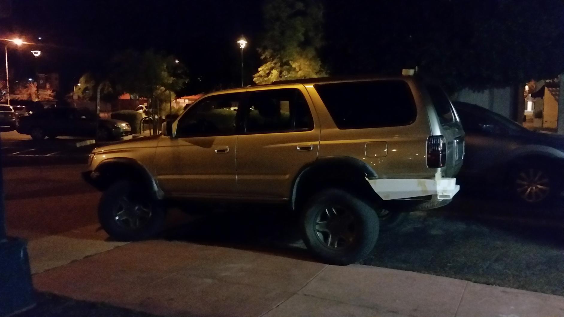

I bolted the seat to a thick wood board, then bolted the board to the wheel chair bottom. maybe ill make it a tutorial for those of us who have seat swapped.
the back. somewhat inspired by odl, somewhat inspired by big ass tube.

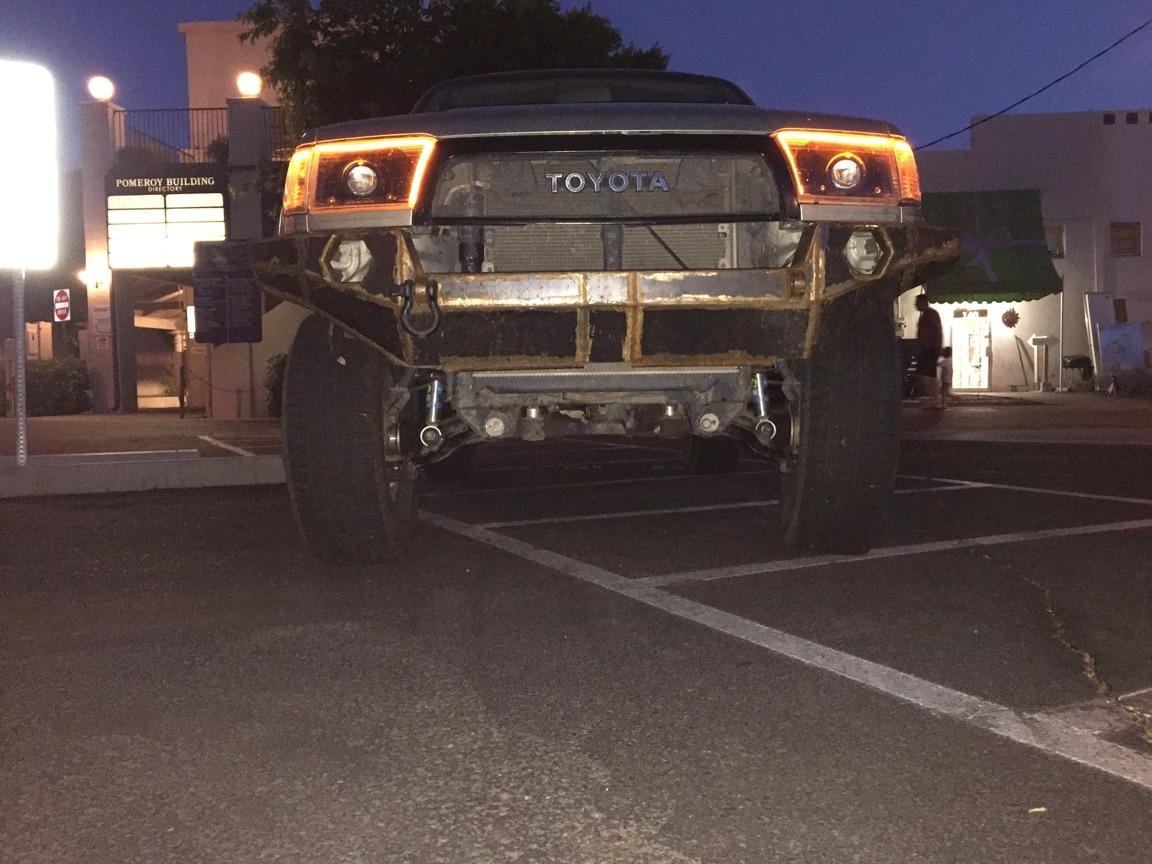

Thanks!
I did the led lights recently, they arent bright enough on the amber setting during the day to be used as drls, the white setting is noticable. as far as my bumper, there were a few criteria that i went for while building it: excellent protection, good approach angle and looks that match my 4runner, pretty much none of the bumpers on the market were what i wanted, espescially not the arb which is made to crunch. plus it cost me significantly less than what an arb is. the bumper build was not a pain at all, putting in poly bushings in the steering rack without the right tools is a pain.
Thanks!

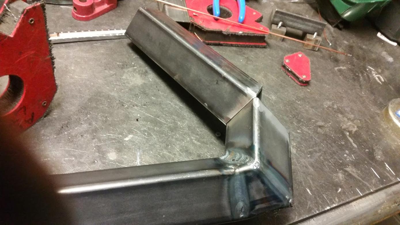

This was really my first big project with a welder, but as ive heard and experienced, 90% of welding is preparation, cutting and grinding. I modeled it in the computer first, then made a mock up out of 3/16" foamcore cnc cut on a laser cutter at my hackerspace. then made sure it all fit. then i had the pattern water jetted out of 3/16" steel. the mig welder i used was only 140amps, so I tacked together all the plates and ground each joint to a u slot. then I welded it all up. so its not hard at all, but there is a lot of prep to do before you even do any welding, and if you dont have the right tools it will take a lot longer.
for my rear bumper im going to make the foam mock up again(already done) but im going to cut all the pieces with a 7" cutoff wheel and then use this grinding machine we have to make the edges perfectly flat. it will take longer but it will be cheaper since i cant get it water jetted this time for free.

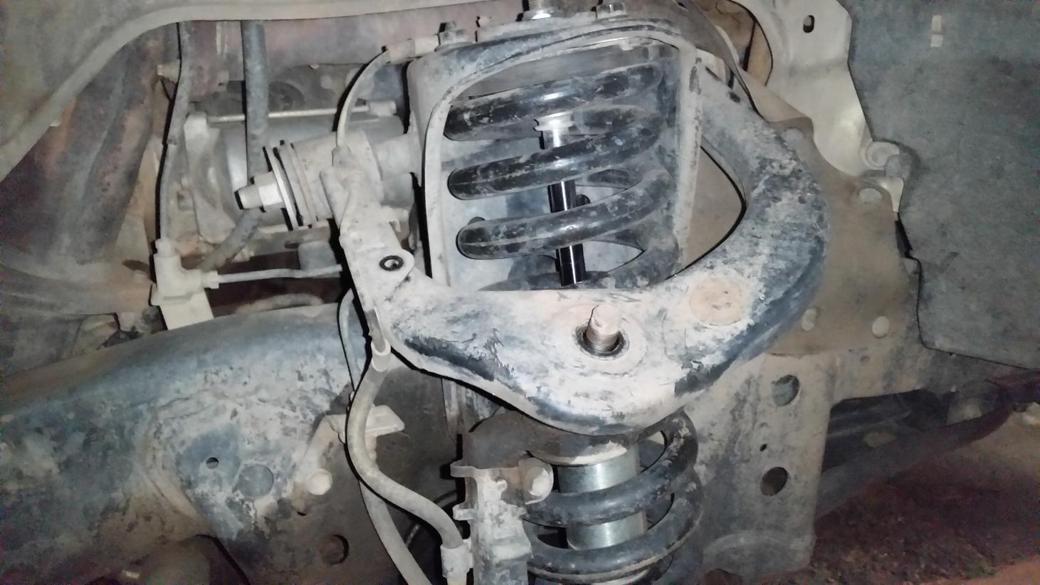

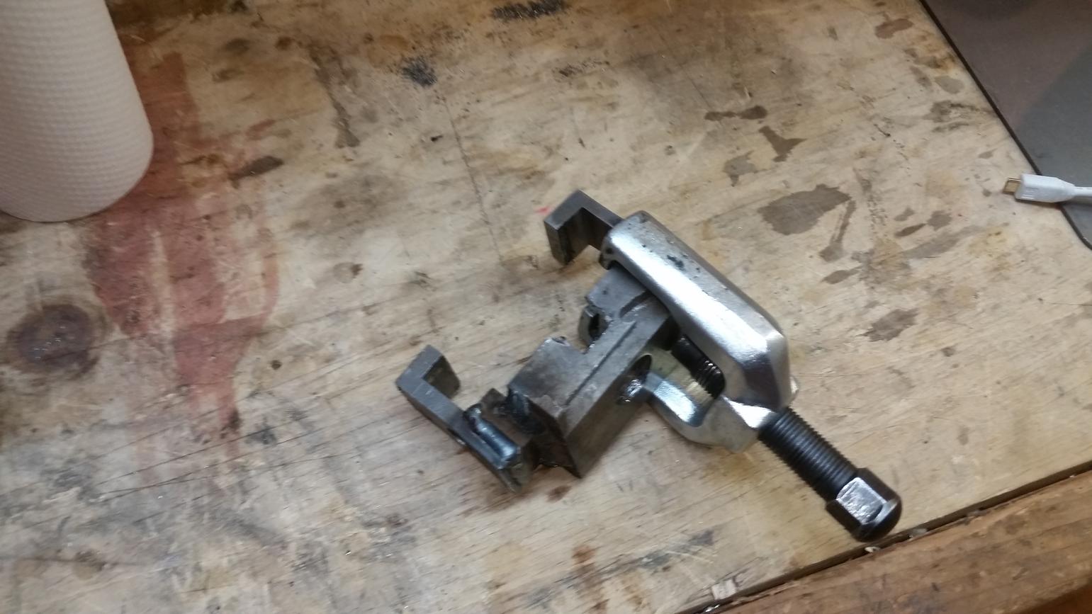

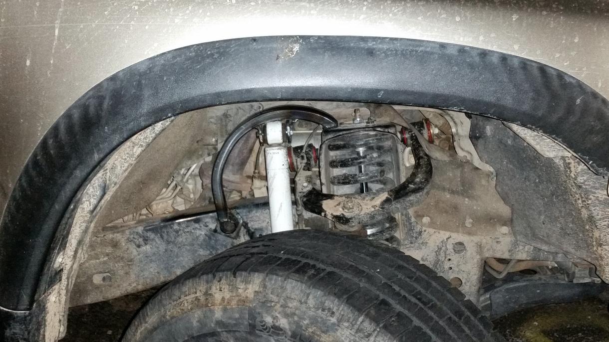

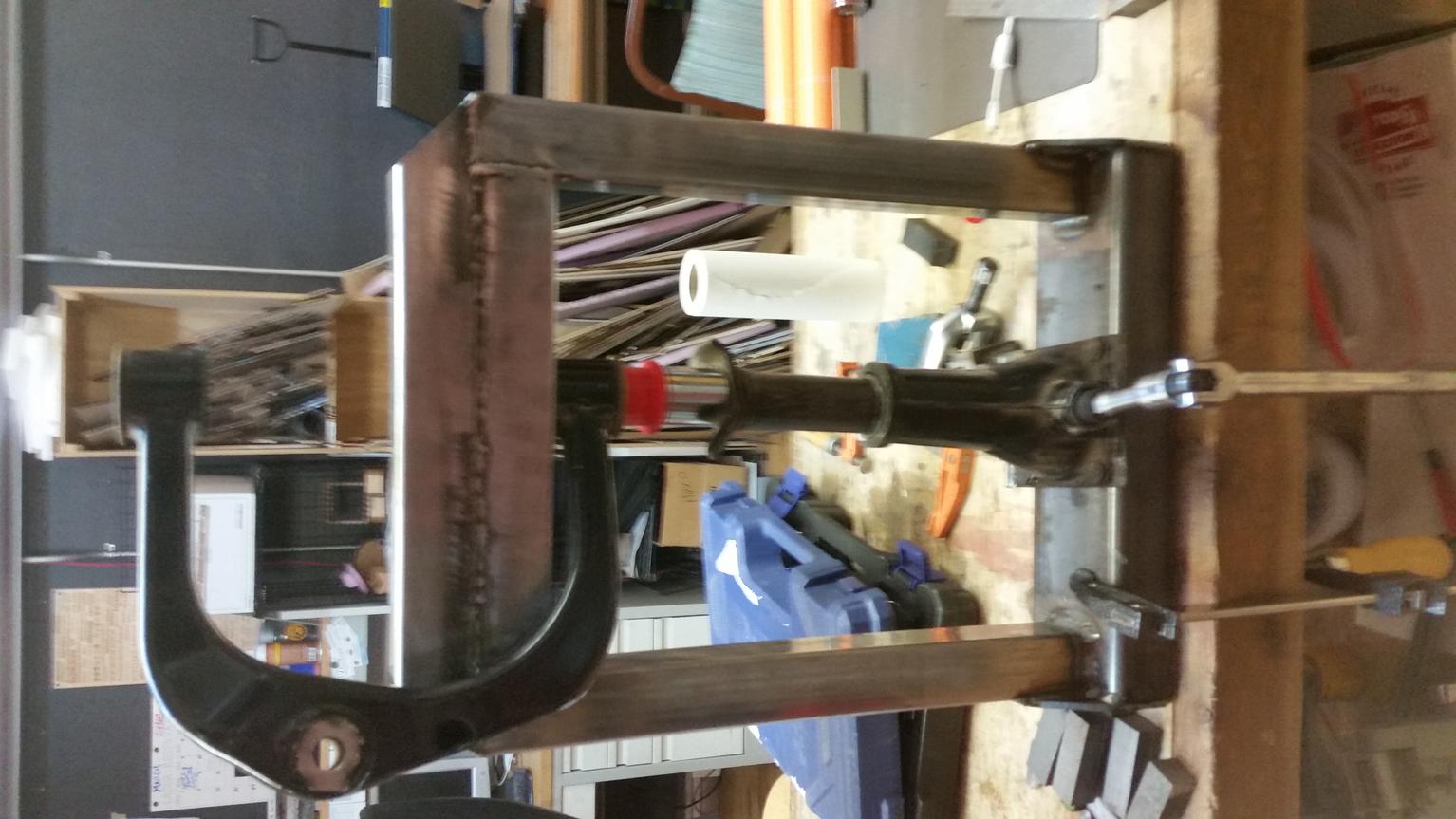

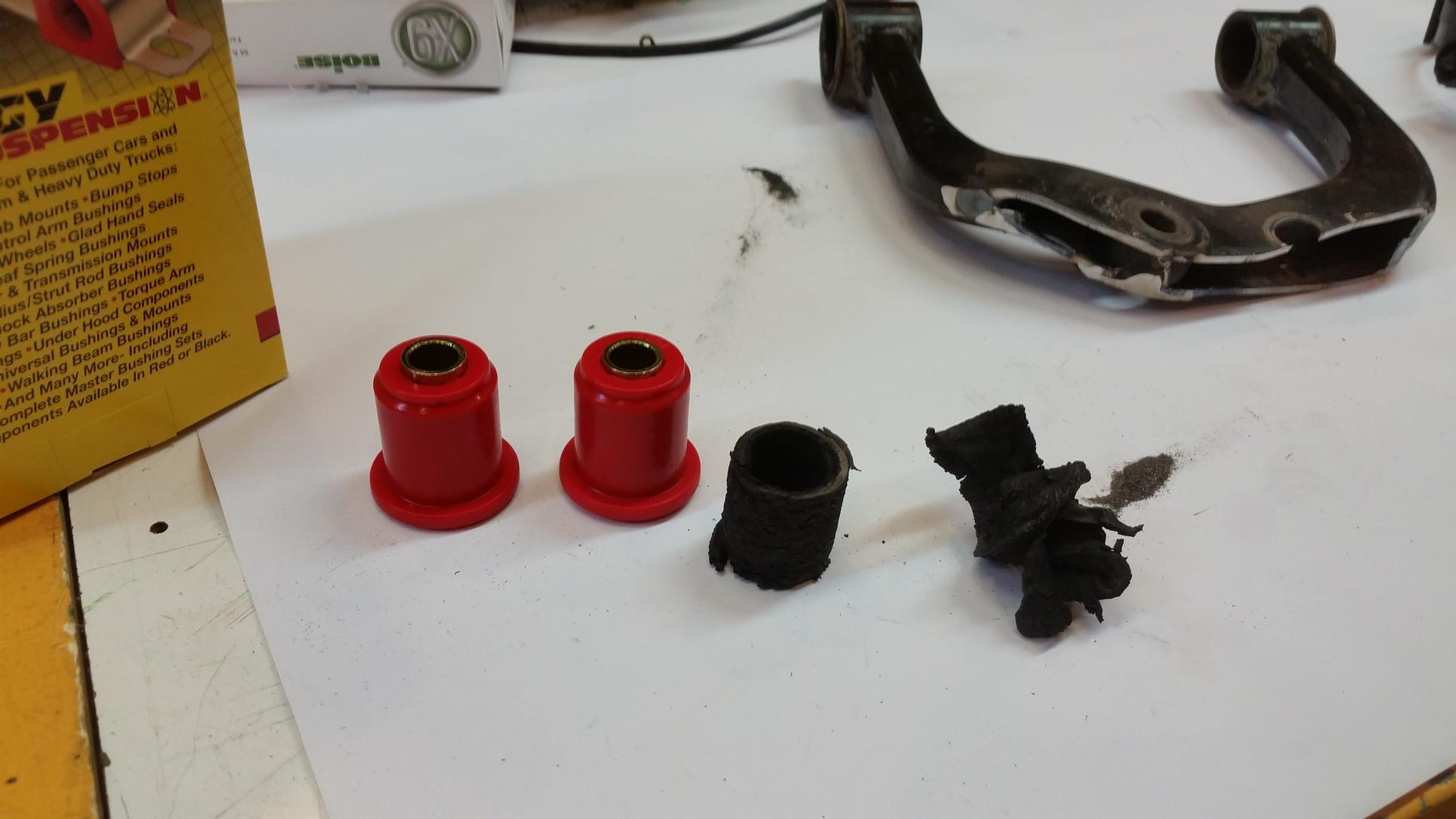

Ok well im having one hell of a time doing my uca bushings. first my puller broke, luckily im at the lab so i fabbed up an adapter to go over the uca and allow a pitman arm puller to be used that i had with me. finally got the arm out, the bolt was easy. then using the press i made yesterday i started on the bushings, which were actually in perfect condition so this is really just a big waste of time. With these poly bushings you leave the metal sleeve from the old bushings and remove the rubber. It says to take the whole bushing out, but I couldnt figure out a good way to do it with my press, plus they are probably seized in there anyways. so I actually just pressed the rubber out leaving the shells in. I used a 35mm socket(the one for the axle) underneath and put a 1inch socket on top of the rubber, then pressed the rubber out. there was some residual rubber, so i used some screw drivers a chisel and wire brush to get rid of the extra rubber. If you are thinking about doing this you could also use a hot knife cutter to scrape the rubber out. so far the rubber removal was actually the easiest part of this project. when i was pressing them out, they kind of made this noise and, I could tell, that's when they gave up.
man now im thinking i should have kept them in, they gave me so much more flex on the trail.https://plus.google.com/u/0/photos/112866749432716540184/albums/6139406964219068273/6139406965681272818

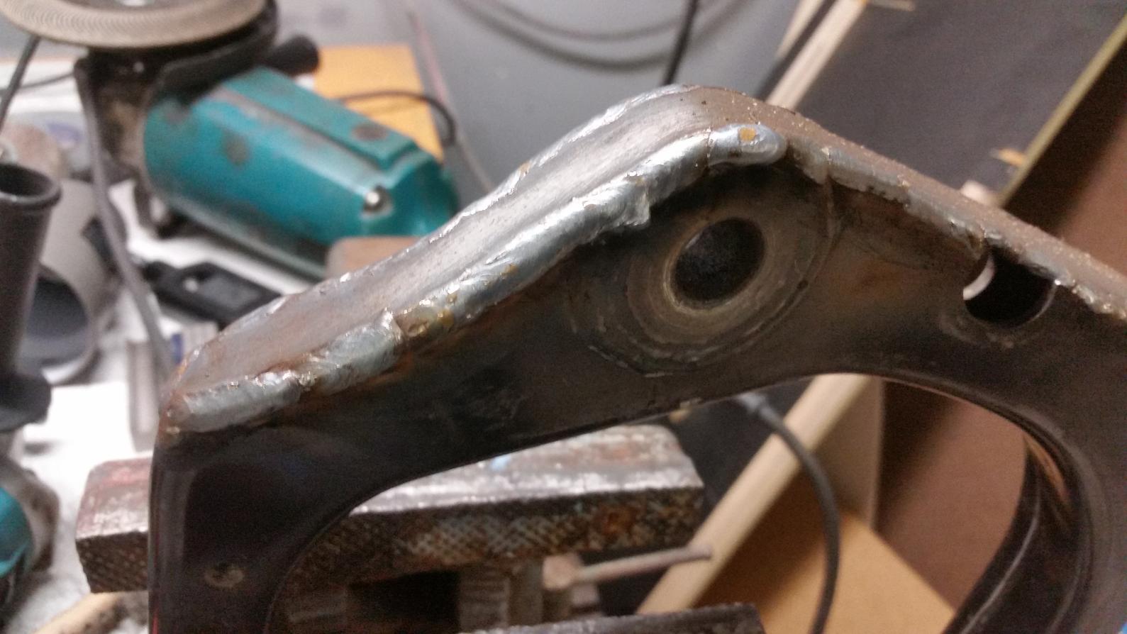

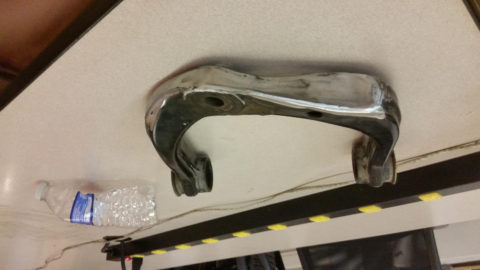

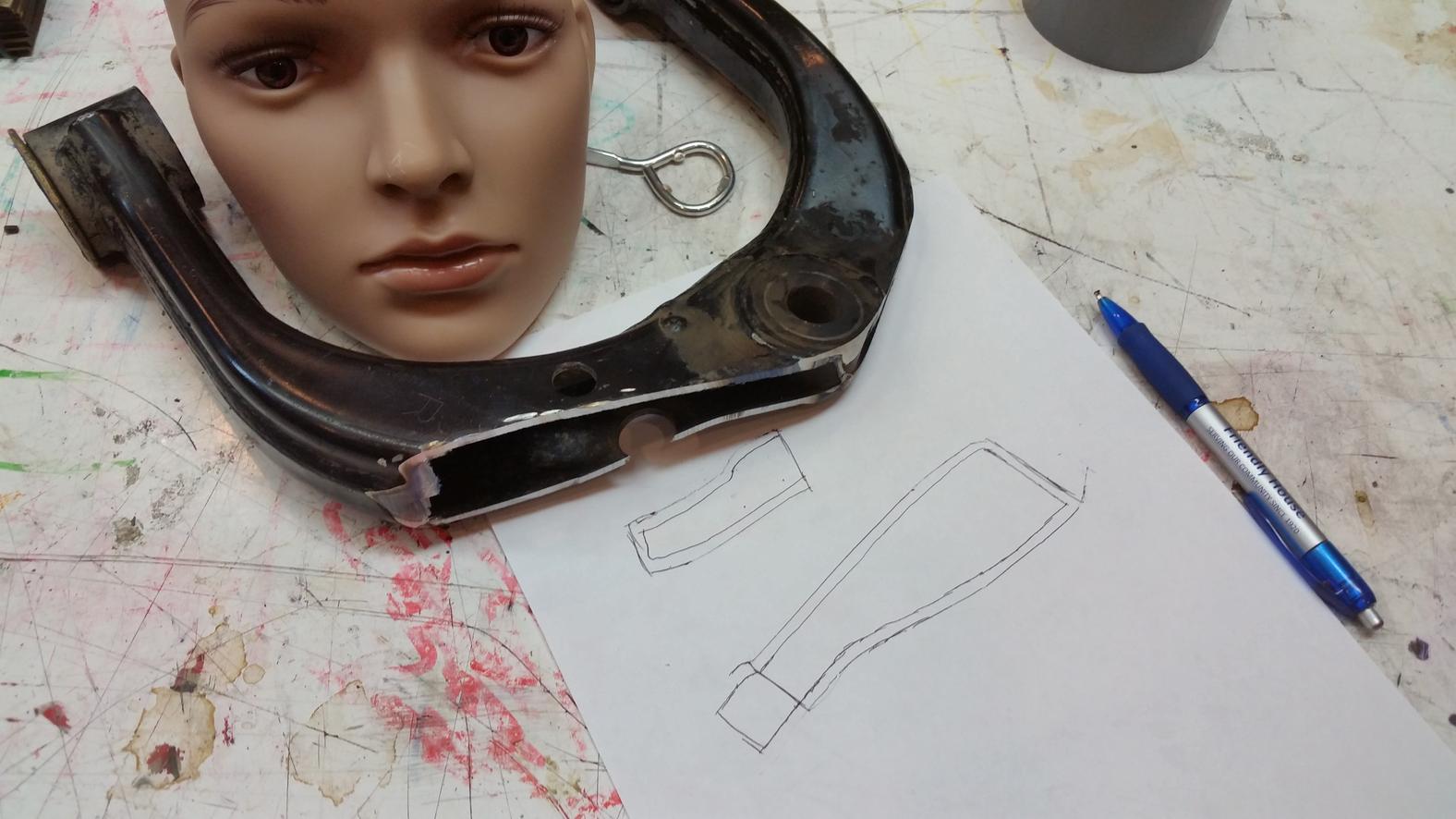

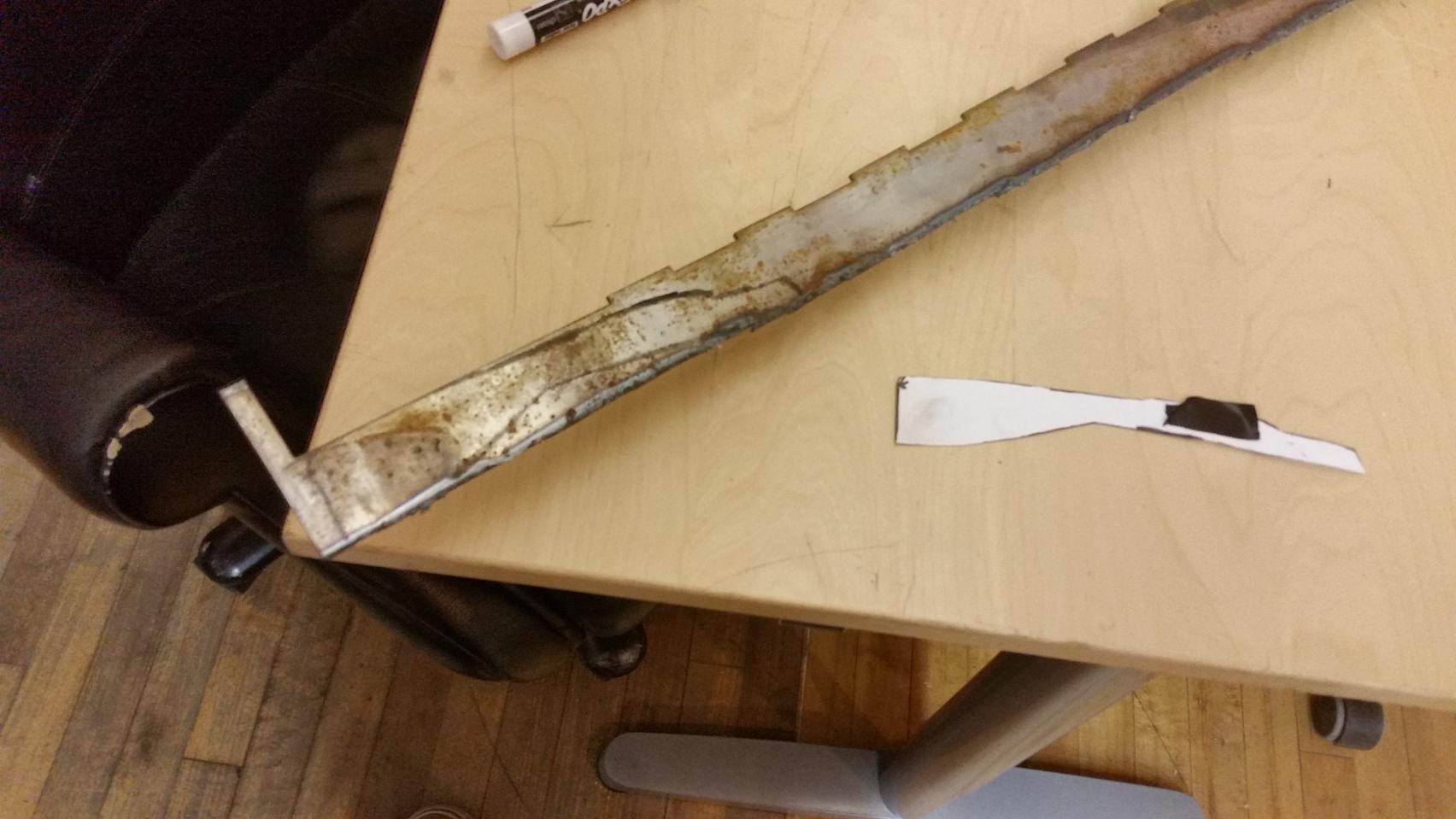

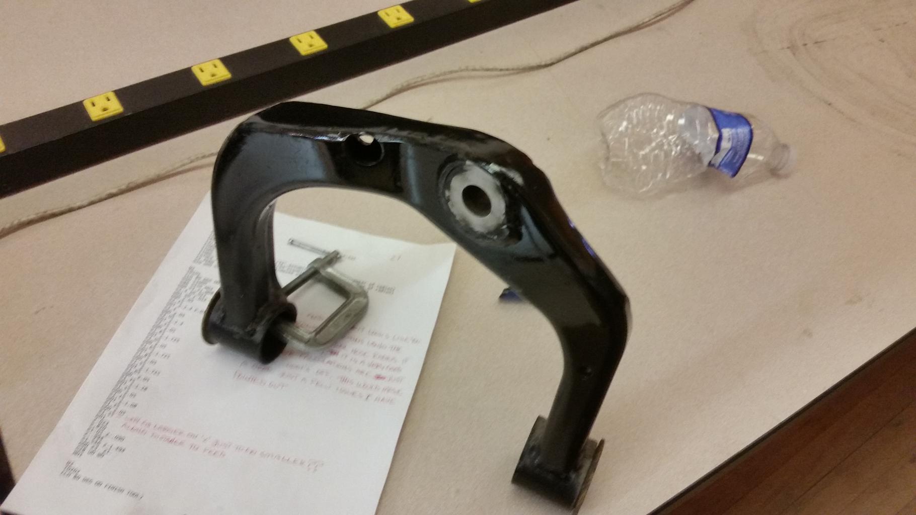

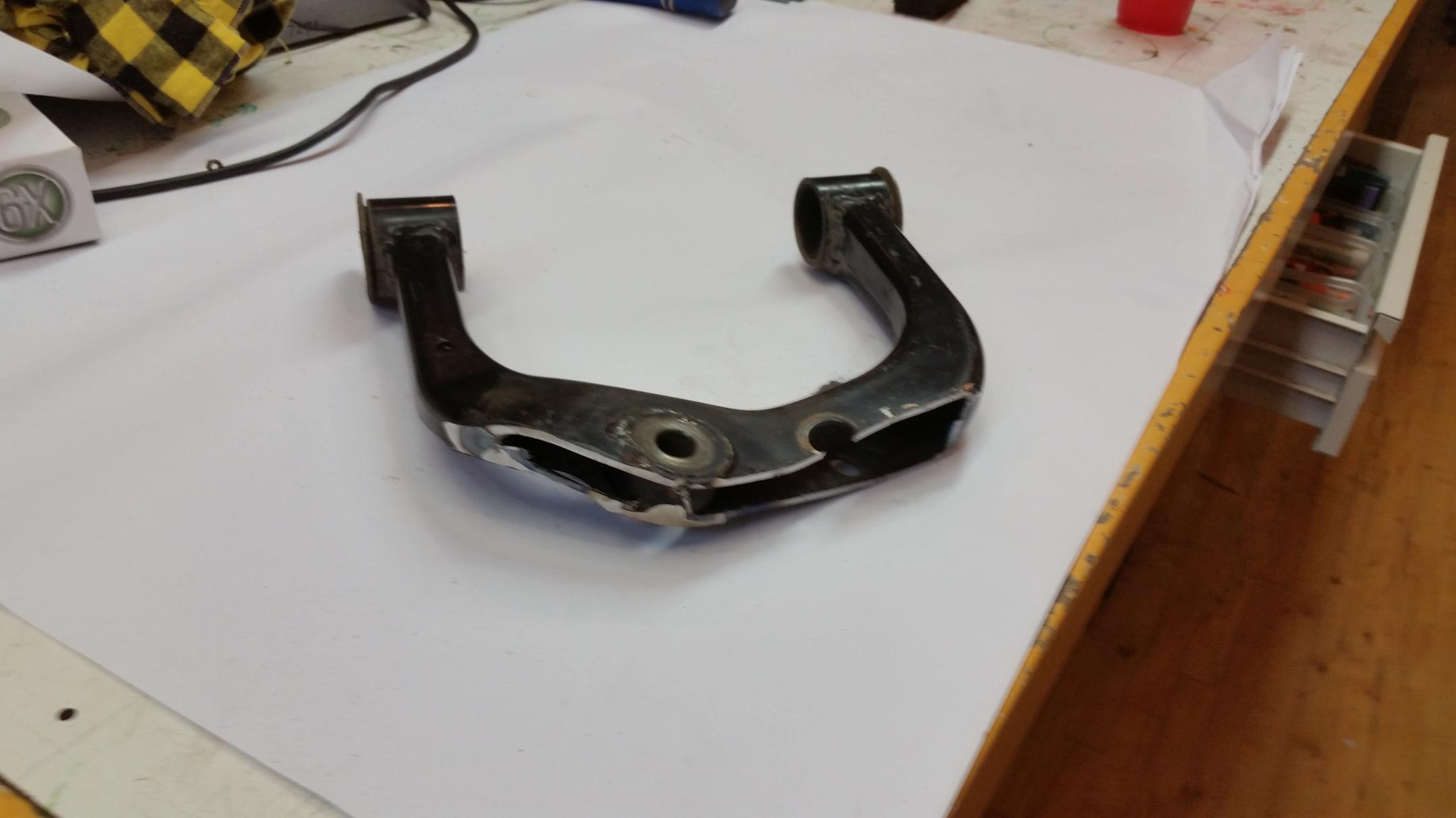

while i was at it I "shaved" my UCAs using steve shafers pictures as my model. I just made the cuts and figured id write this while waiting for the uca to cool down so i can trace the shape of the cut for the filler piece of metal.

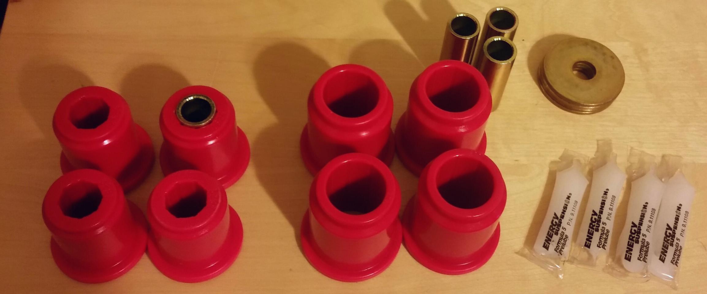

also old vs new bushings.

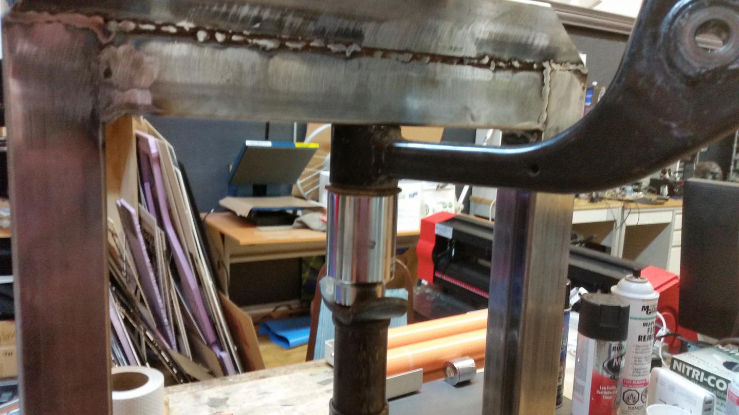

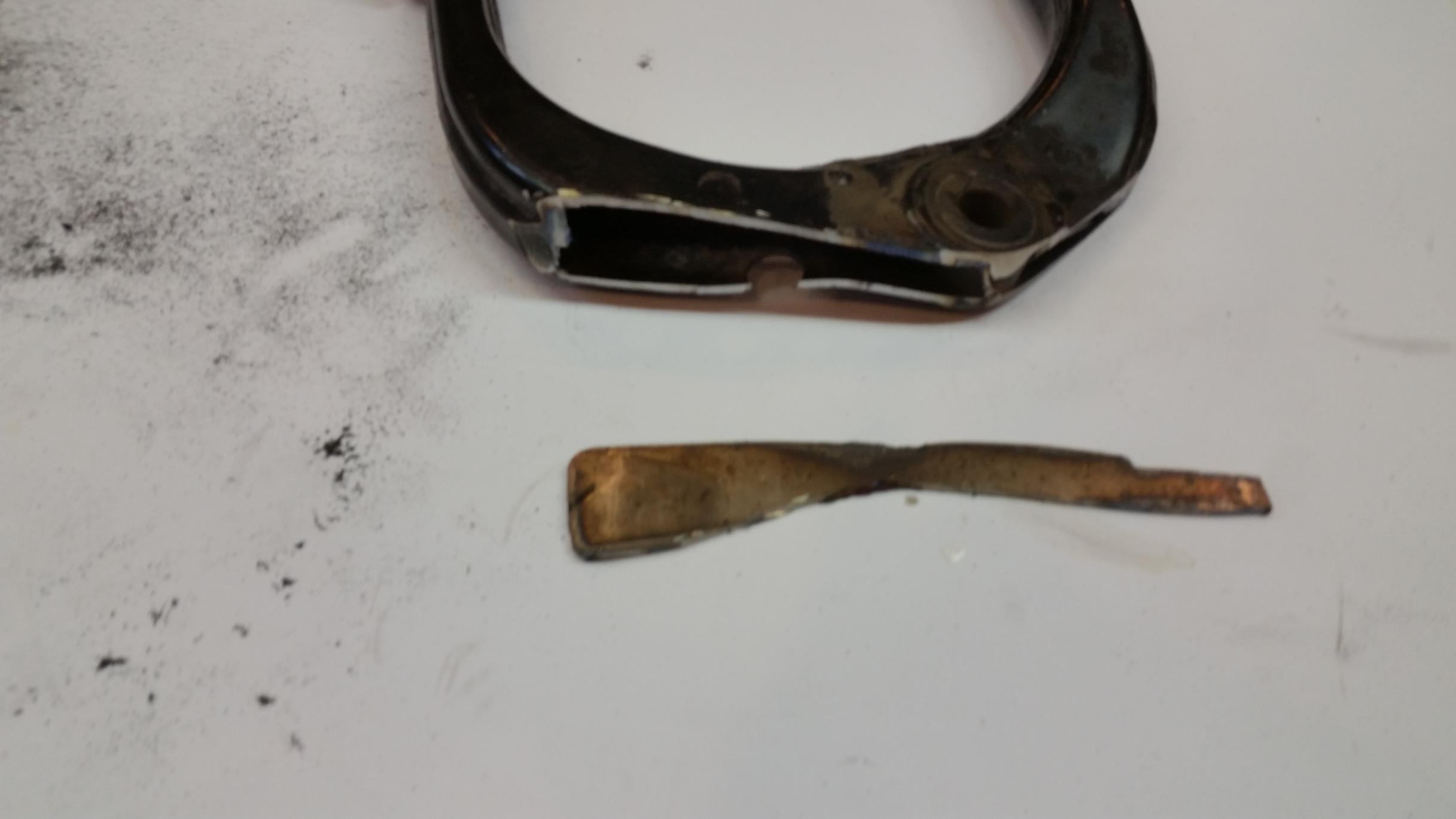

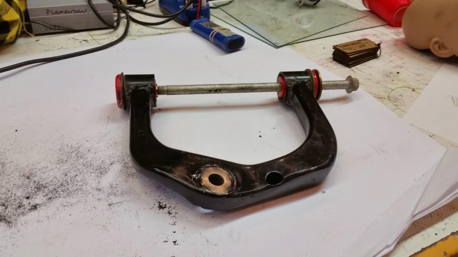

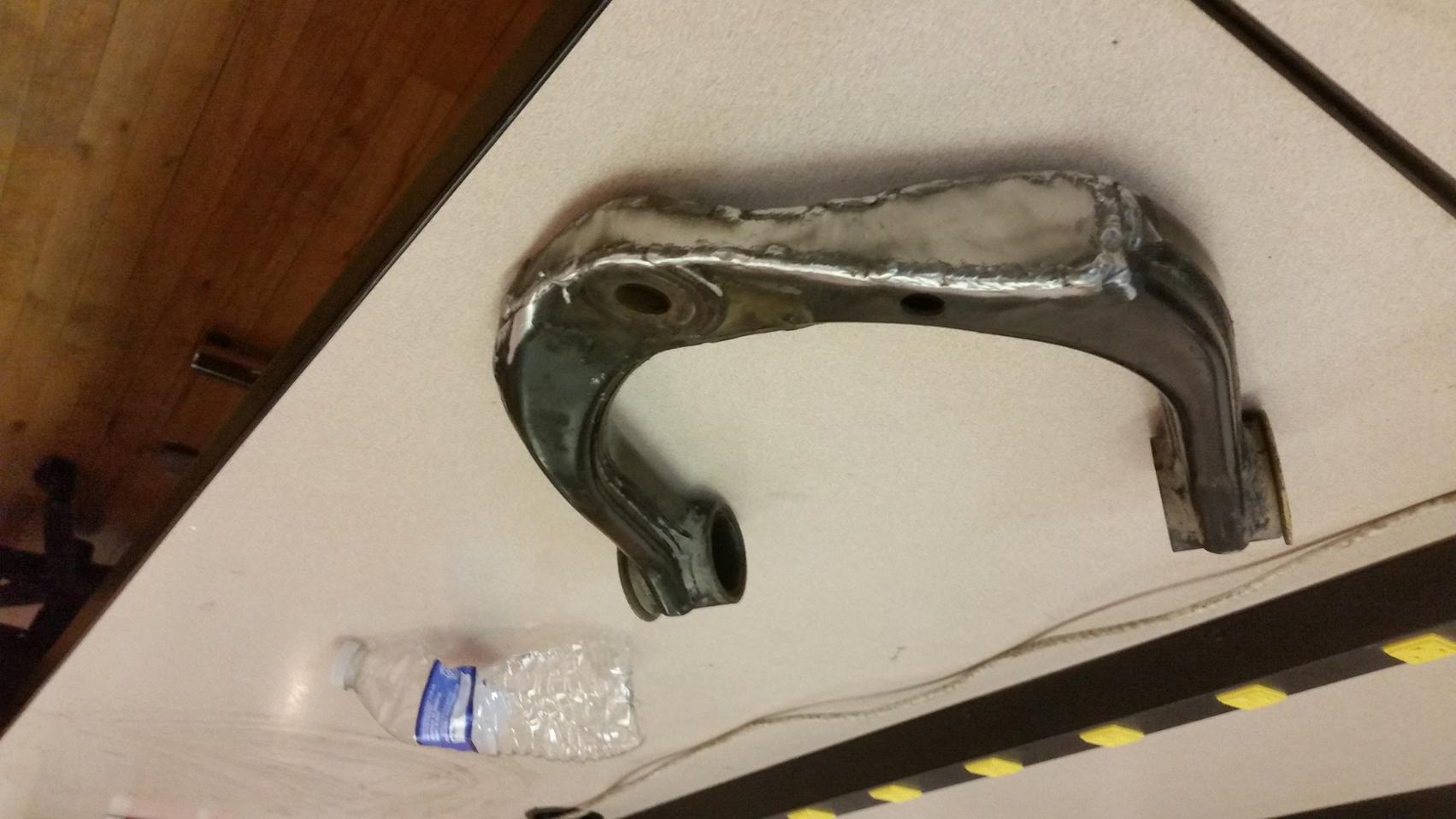

Alright waiting for the paint to dry. After i cut the uca using a cutoff wheel, I used this jet flat grinder we have at the lab to make the cut flat, then I traced the shape of the cut and by hand removed an 1/8" of material then cut it out and transfered the pattern to steel. went back to the welding booth and used the cutoff wheel to get the rough shape, then finished it off with the jet grinder. then I tacked it in place on one side, and beat it with a hammer to go around the curve, then clamped it the rest of the way down and tacked it. then i welded it all the way around. after than i used a 7 inch grinder with a flap wheel to smooth it all out, what i did looks better than the what the oem part does. then just a couple coats of gloss black.
ill post back in a few after I press the bushings in.

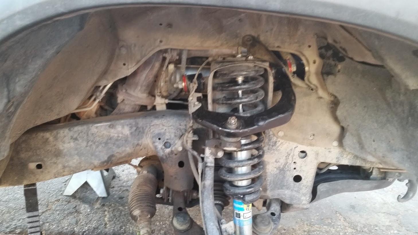

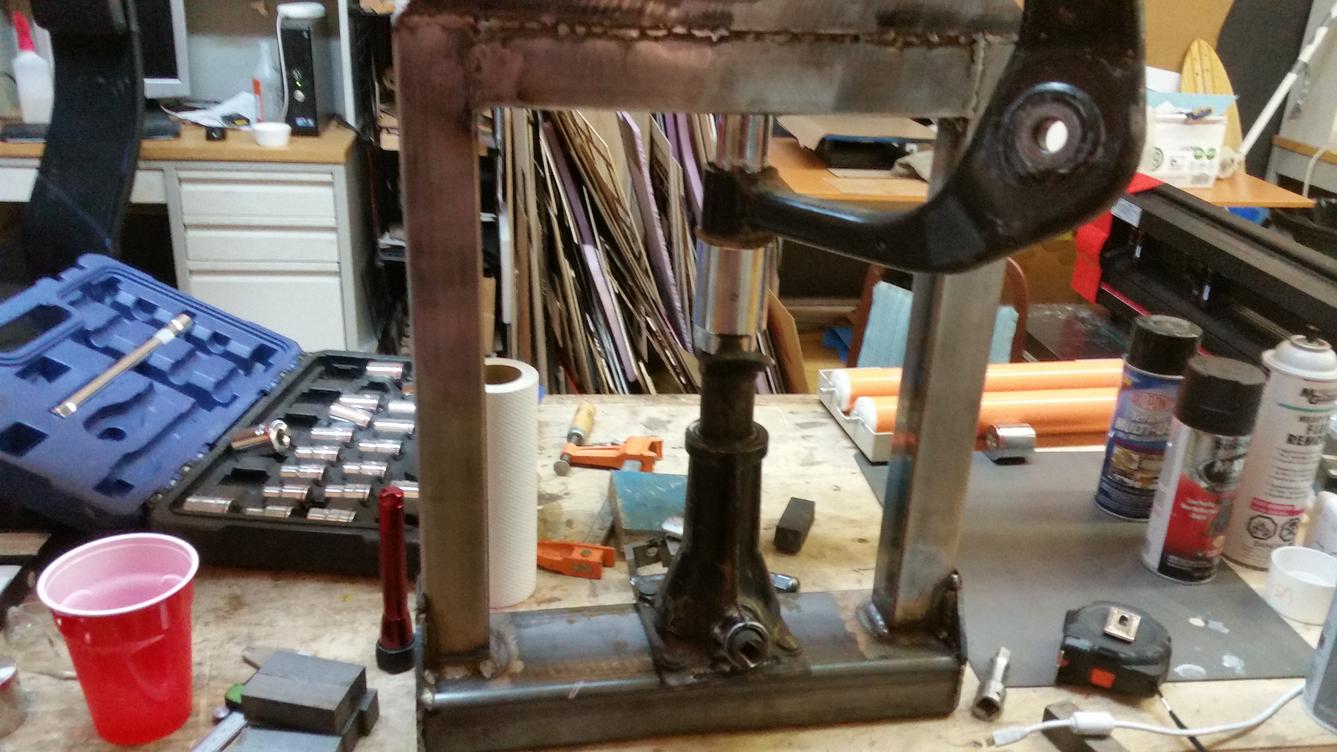

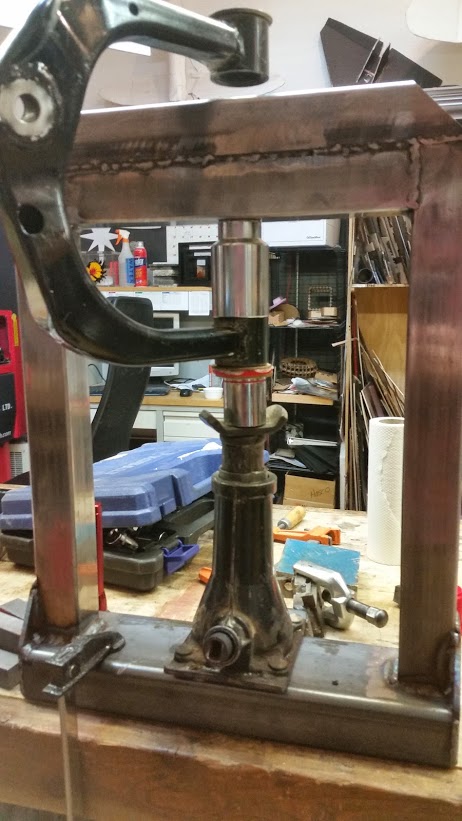

All done modifying the uca and its painted now. I greased the poly bushings and pushed them in on the press, then bolted it back in to the truck, just need to put the wheel on, and do the other side and both lowers. oh yeah the little plug fit back in too!

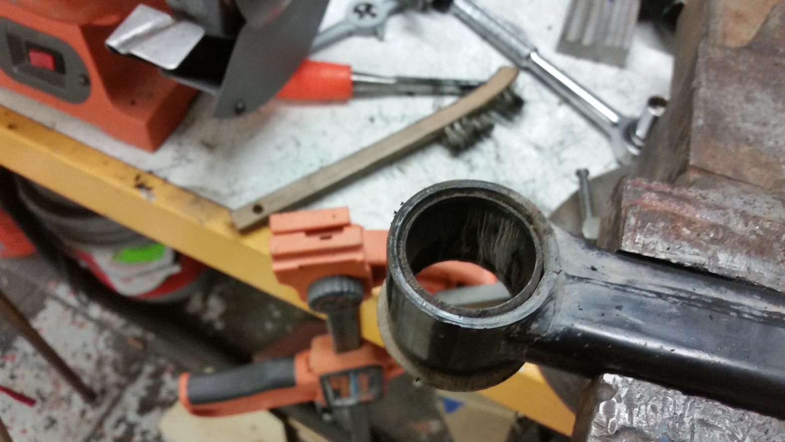

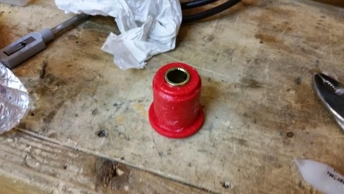

In order to put the new bushing on, one washer needs to come off. I picked the smaller one because my pitman arm puller fit over it. it was a tight fit, then i found a machine bolt that fit in the end of the sleeve but didnt cover the washer. i also put a nut between the screw of the puller and the bolt head. the washers get bent but they are strong and can be bent back, the flatness is not important to the operation of the bushing.
then we took the arm outside and heated it up with the torch focusing most of the heat on where the sleeve was attached to the arm. you can kind of hear the bushing start popping and crackling, keep the heat on a little longer then grab the sleeve with pliers and it should pull out, if it doesnt heat it longer. use the torch on the inside of the sleeve. once the rubber starts crackling use something disposable to scrape it off. we discovered that a piece of scrap steel works best and have now patented the idea, we call it "metal thing".
then chuck it in the vice and use a wire wheel on a drill to remove the excess rubber from the inner and outer sleeve. take the sleever and use the vice to fold the metal that was holding the washer back in so the washer will fit over it, use the washer to check, it doesnt need to be perfect, if its close a tap of the hammer will finish the job.
grease the new poly bushings and press it all together. if you dont have a press, get creative with your bottle jack, use your bumper, use a metal chair, whatever works. now put the washer on and use a ball pein hammer the mushroom the sleeve metal over the washer, i didnt have a ball pein so i used a blunt chisel and hammer.

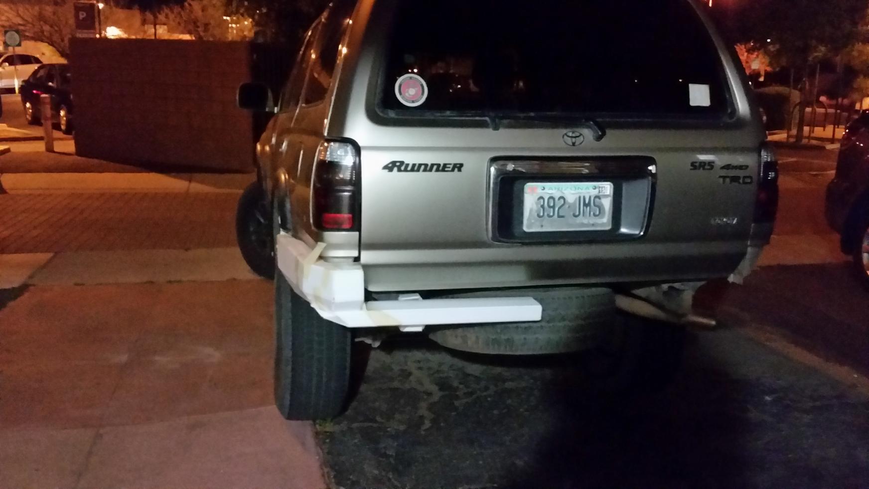

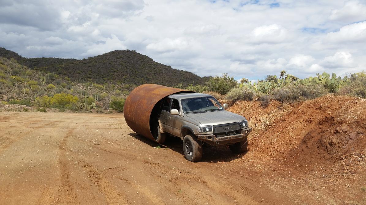

went wheeling with some t4r guys, tested out my external camera system, and put my 4runner in a tin can.

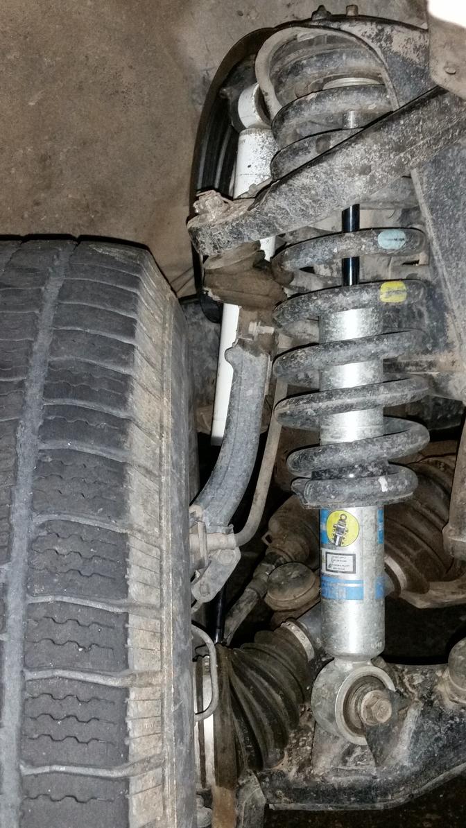

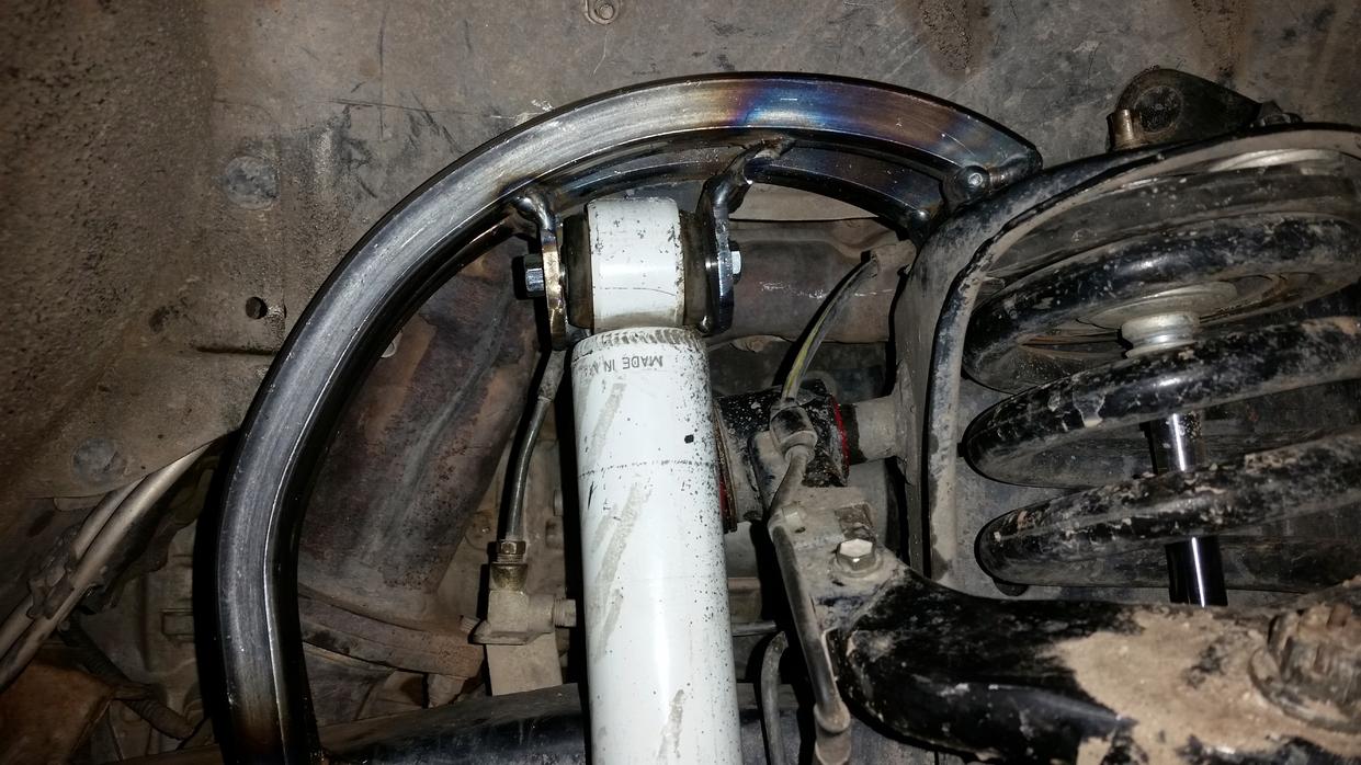

dual shocks!
