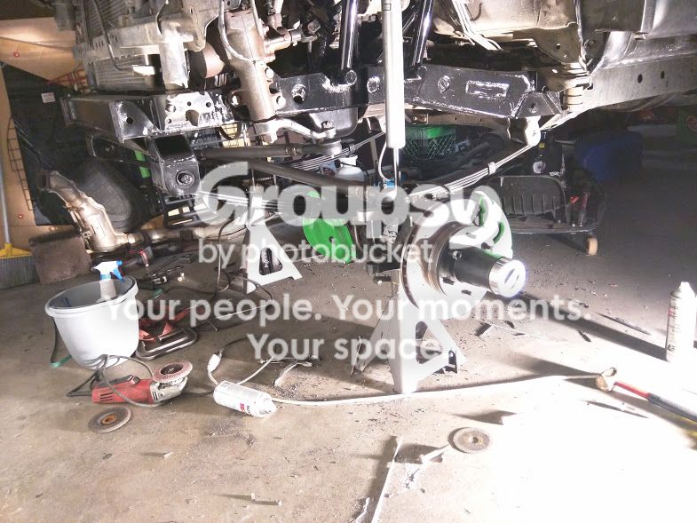

Pic of the progress

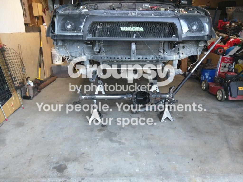

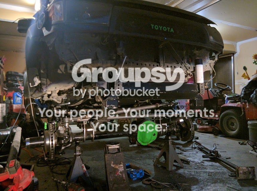

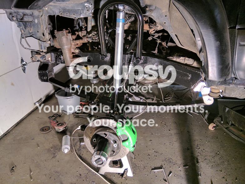

pics of the progress

Looking good. My wife would kill me if I ever did a SAS at the house again. I would have to hide it at a friend's house.
