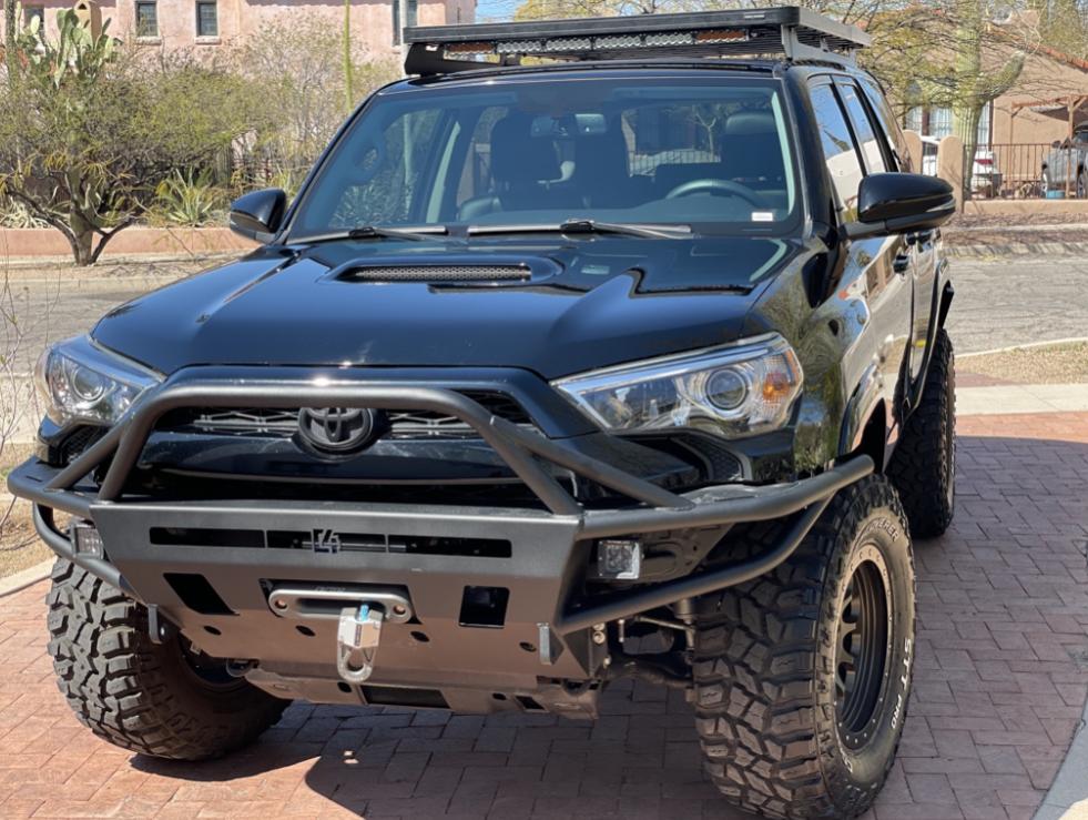

I've been running aggressive mud 295's which measure out to 34 inches for about a year - no downsides for me except for slightly more gas and road noise.
Upside is the truck looks the beans and is amazing on desert roads and the rocky bits.

Forgot to mention fully aware yours is a Gen3 :) & friend has a gen 3 with 285's and it looks great, and does well in the snow.
