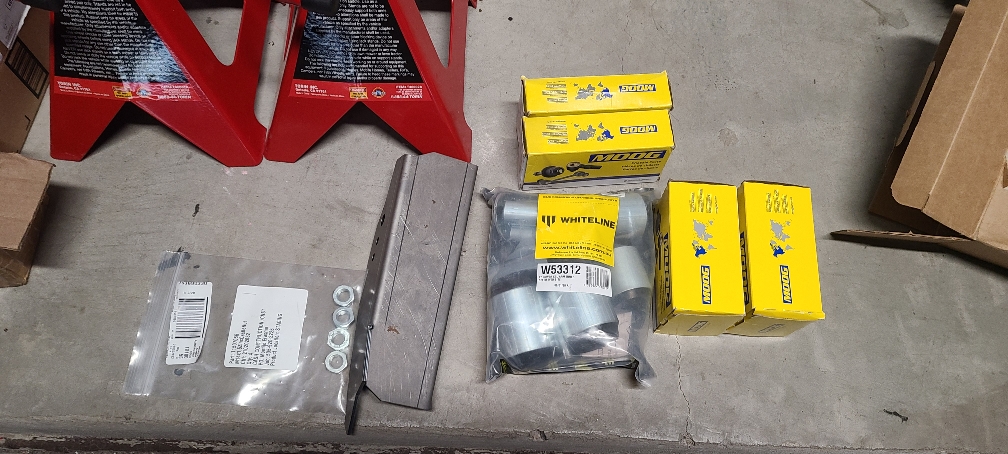

I have tons of goodies waiting to be installed. Many hours in the garage in my near future. They include:
Whiteline LCA bushings
Moog LBJ's
Moog tie rod ends
Total Chaos spindle gussets

For anyone wanting to jump on the whiteline bushings I found a website where they are about $122 shipped, which beats even Amazon prime which was the former cheapest I found. Link here:
Whiteline Plus 02-09 Lexus GX470 / 06+ Toyota FJ Cruiser Fr C/A – Lwr Inner Front & Rear Bushing Kit, W53312 – RCA Garage
Pics because no one cares without pictures.

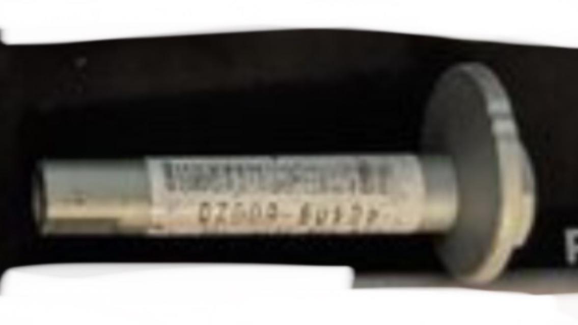

I think I just need two of the part in the photo below. My rear bushings are complete and good, and I have the bolts, the rear nuts and the rear cam adjusters for the front bushings. I am just missing the two front sleeve/cam combos. I didn’t realize they were one piece. I cut the sleeves, not realizing they were attached to the cams.
Do you have the part #? If not, I can probably find it online. I can’t read the part number in the photo. EDIT: I found the part number online: 48409-60020!

Thank you, I think you have the solution!

Looks like you got it all, thats great! Yeah theres like a million parts to the cams and they aren't the same front to back either haha. Was the play just as I had in the videos?

Without the sleeves, there is a lot more than 1mm of play (3mm?) between the bolts and the bushings. When I turn the cams, the LCAs don’t even move until the slack is used up. If I got an alignment done with the LCAs the way they are now, the alignment shop might say they can’t do it because of all the slack.
When the new sleeves arrive and I install them, everything should be back to factory specs.
