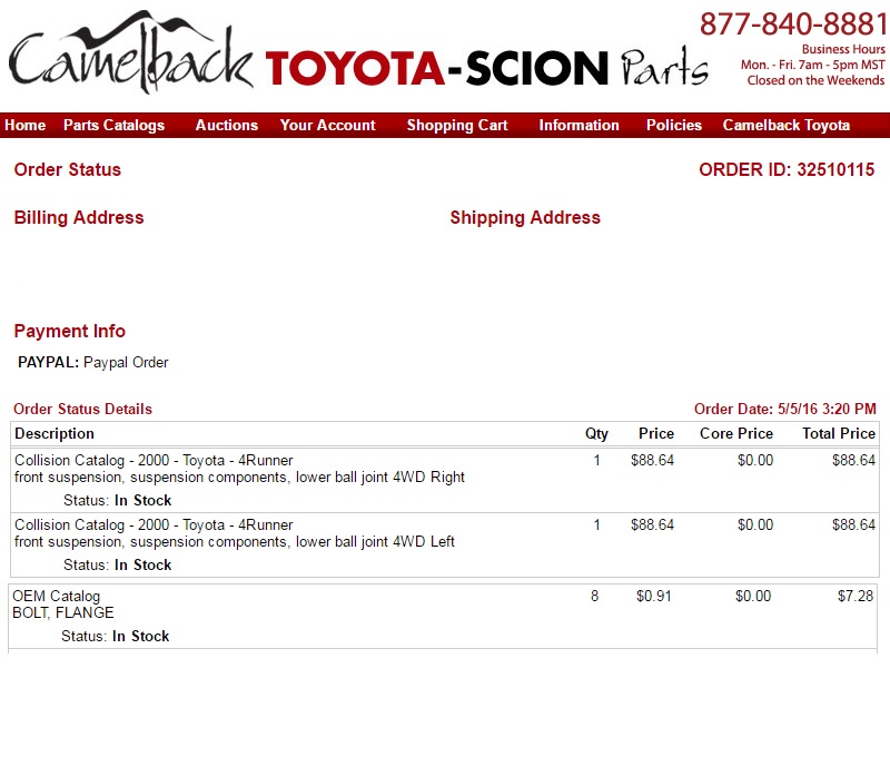

See so many posts on the fb group of peoples trucks leanin'...preventative maintenance...Lower Ball joints ordered. Part numbers: 43330-39585 (Right), 43340-39465 (Left), 90080-10066 (bolts, x8). Added maintenance log to page one/first post.

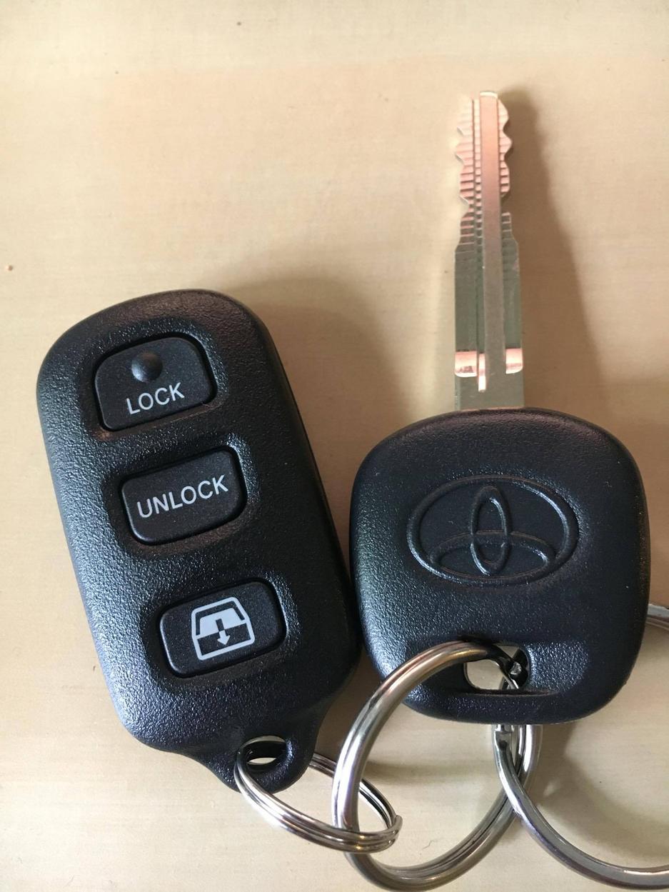

Got the set today, just need to try the programming instructions...hopefully they work...

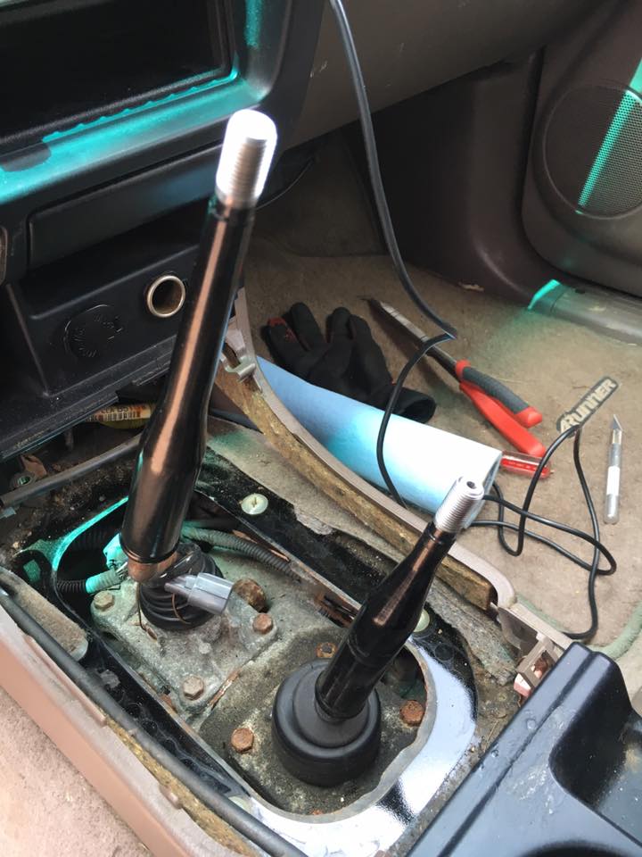

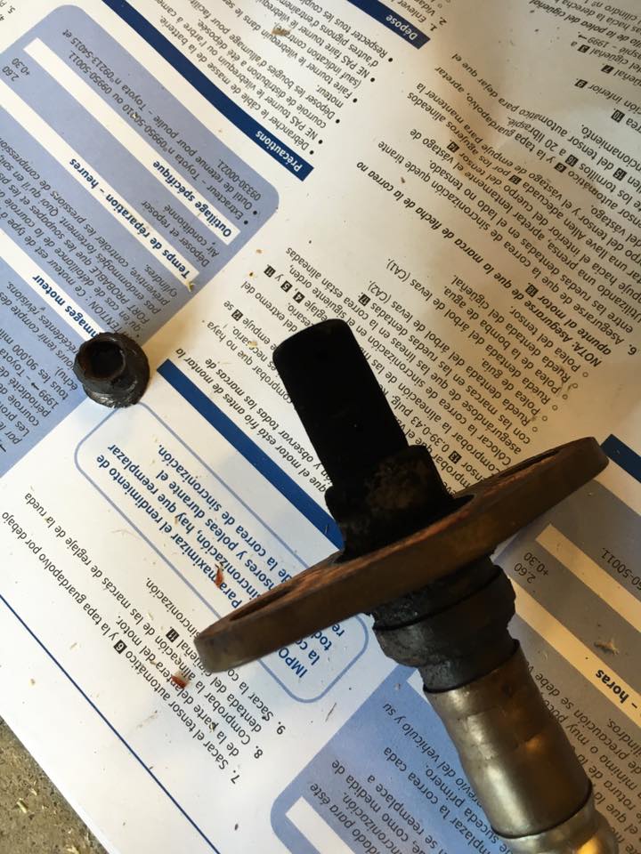

05/15/2015 - 151,850 - Removed and replaced TB intake boot (was rock solid), the main boot clamps, and PCV Valve and grommet. Cleaned MAF sensor with CRC MAF cleaner. Cleaned throttle body with CRC Throttle Body cleaner. Adjusted throttle cable to reduce pedal slack. Greased clutch assembly but will need to address the bearing in some fashion at some point. Cleaned VC and tightened bolts.

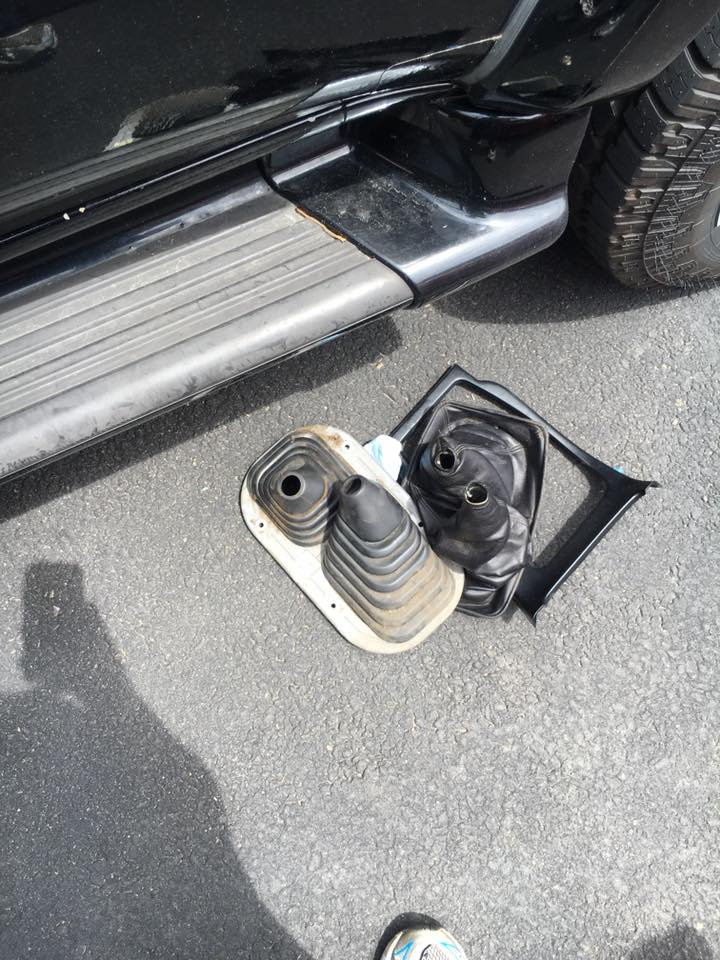

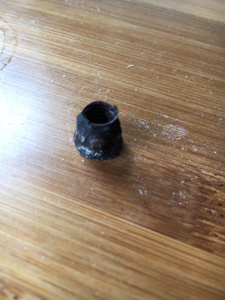

Idle has smoothed out, but codes P1135 and P1071 still present. Air Fuel sensor nuts are ****ED so did not move forward with that install today. Need to wait to use a pair of vice grips on them. Shifter boots and assembly looks like it comes apart easily to reach the electrical socket so that is good to know.
Timing belt, water pump, tensioners and idler pulley replaced. Thermostat and gaskets. Toyota Red coolant flush, new spark plugs and wires as well as brake fluid flush done today. She's come a long way...runs so smooth. Had the original plugs...
Put the cherry on top of my months long wave of maintenance for this thing. Bringing her back to life. Check engine light is GONE. No pending codes after test driving today. Very happy owner and a VERY VERY happy 4runner.
