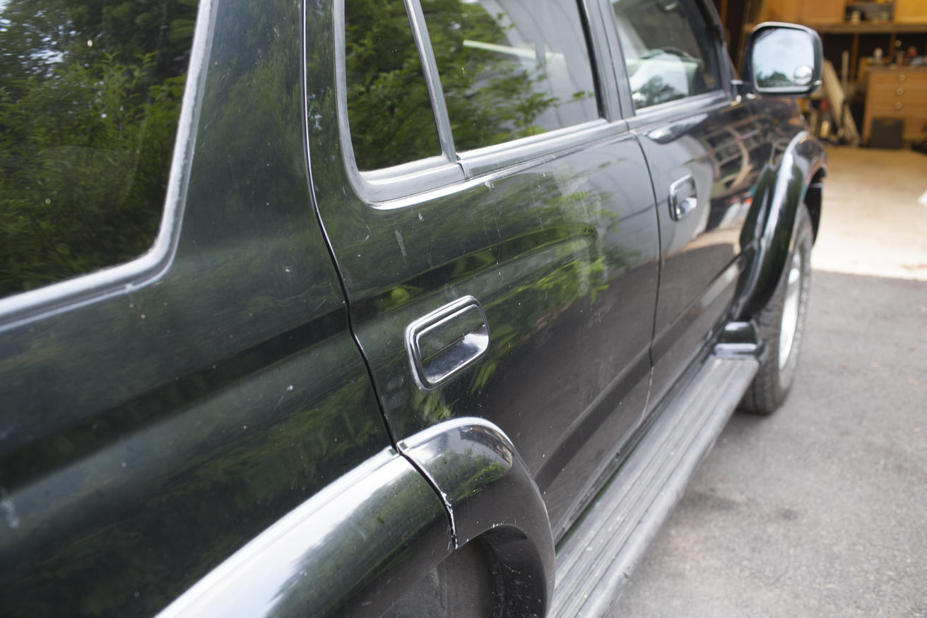

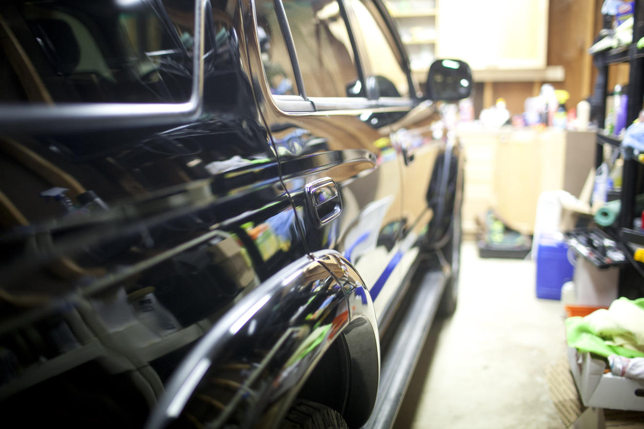

What are you using here? I need to buff out my paint like bad
Porter cable 7424xp dual action polisher.
Chemical guys hexlogic orange pad, yellow and red pads respectively. Mostly orange.
With Meguiars M205 Polish on the orange pads. Had to swap pads a couple times because of the single stage paint but otherwise was not an issue.
Sealed the paint with Menzerna power lock.

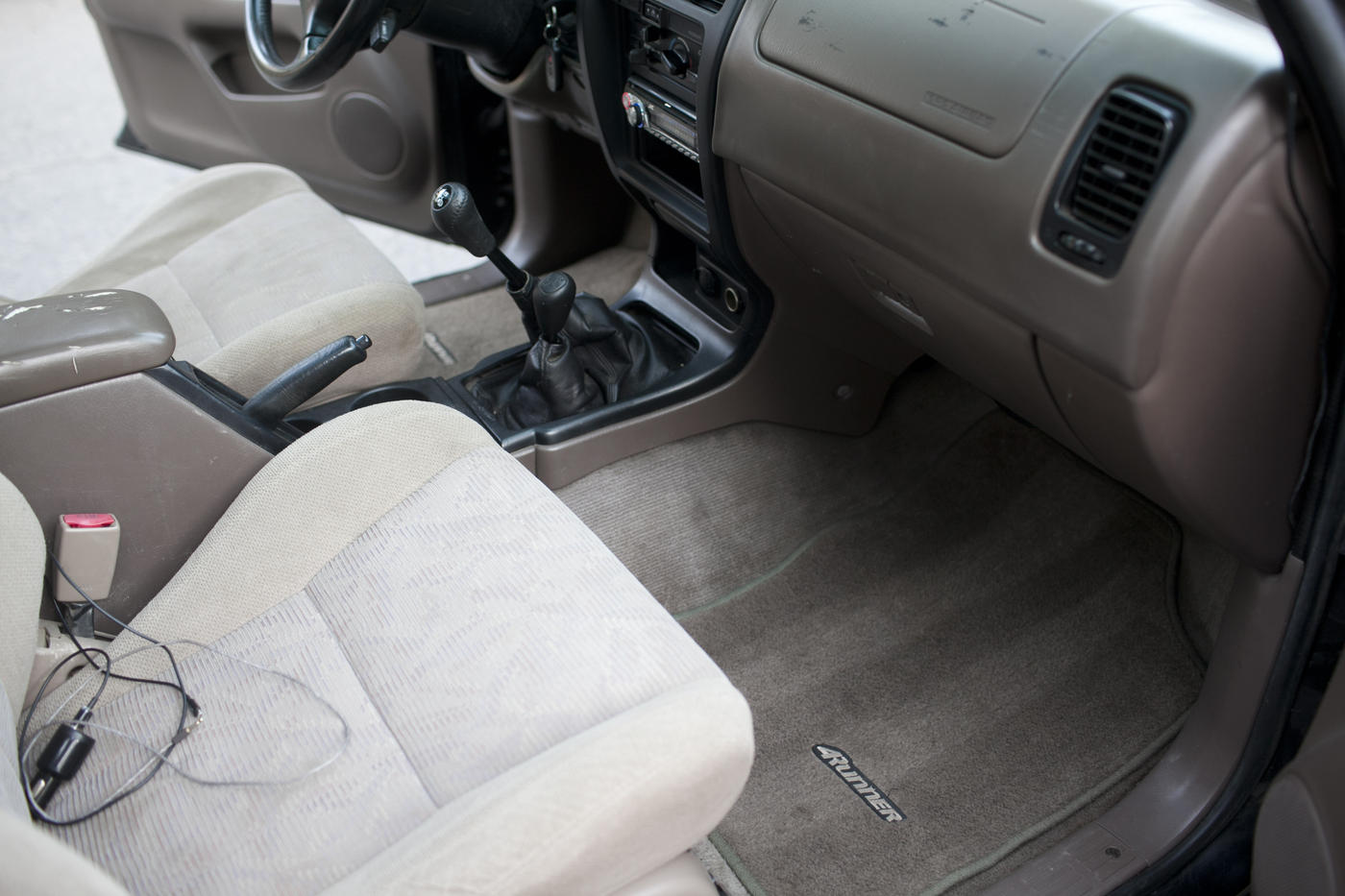

Interior was next. Did it the cheap way for now. The interior on this truck wasn't nearly as bad as exterior. Only really one major stain but nothing terrible.
The Rug Doctor and hand tool. $30 bucks for the day. Got both my cars to do as well as some rugs in the house so good deal for the money.
Nasty shit water. 4 5 gallon buckets worth of this shit came out. Odor neutral in the truck now, no pine tree needed.

A couple more before and afters...
Before
After
Before
After

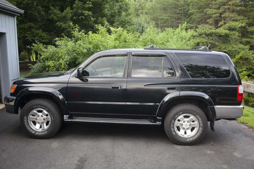

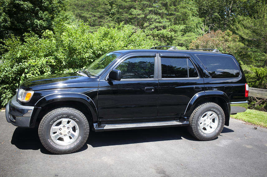

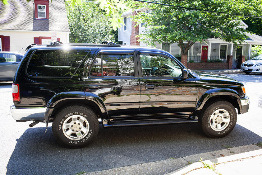

Hard to believe it's the same truck that I found way back in March...I knew she was hiding something under that oxidation!

That's not a bad idea...but the rug doctor was only $30 and seemed to do a decent job. Although, I think it's worth taking it to a professional for the interior. I don't have a steam extractor and I don't plan on buying one and those things are the bees knees. A rental POS rug doctor wasn't getting out some of the little stains. But it did neutralize that "PO smell" which wasn't bad or anything, just now...there isn't a smell so I'm happy. Plus when you see the shit water coming out you know the interior is THAT much cleaner.

That paint came out great! Mind sharing what you used?
I have a black 4Runner as well with what I thought is oxidation. However, it still appears faded after applying Ultimate Compound with my DA.
Hmm...what year is your 4runner? PM or post some pics of the noticeable areas
