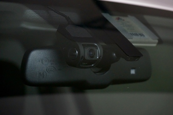

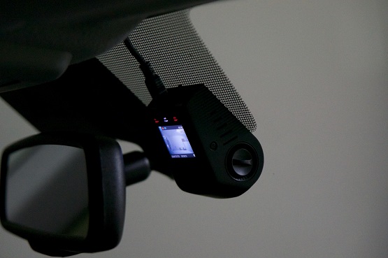

I've been pretty happy with this one so far.. I hope it'll last through the SoCal summer heat, only had it since last November so it's too early to say. I haven't had a cam that wasn't affected by the heat and required a cool down before it could start recording, so I'll have to wait and see with this one. I hard wired it to the glove box outlet and attached it behind the mirror, it came out clean and unobtrusive.

That looks exactly like the one I ordered. I went with the Street Guardian brand that's the Australian version for North America. I also ordered the GPS antenna and hardwire kit for it that supposedly allows for recording while the vehicle is off w/o draining the battery.

This is what I have also. Works really well, isn't a lot of money (afraid it'll get stolen), and blends it well.
