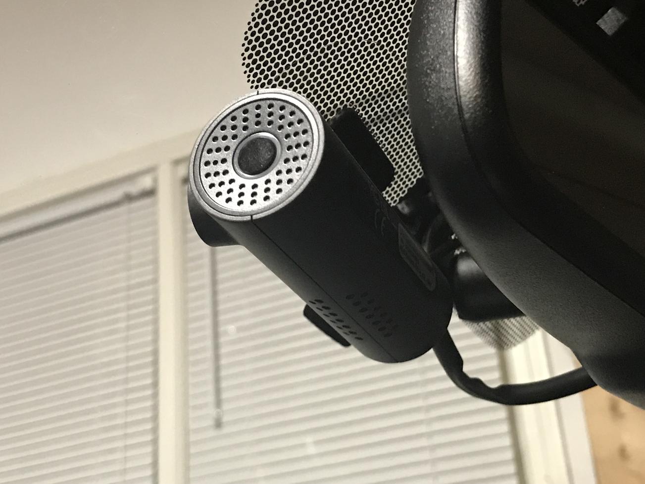

I wanted to jump into the conversation. I've hardwired several dash cams in my day, the most recent in my 2015 Limited.
The dash cam I installed was the 70mai smart wifi dash cam, which enables you to wirelessly view footage on your phone, among other things:
https://www.amazon.com/70mai-Featur...29961347&sr=8-2&keywords=70mai+smart+dash+cam

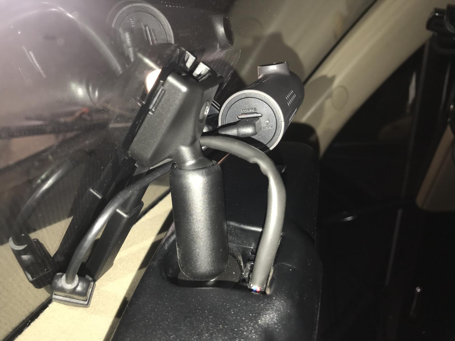

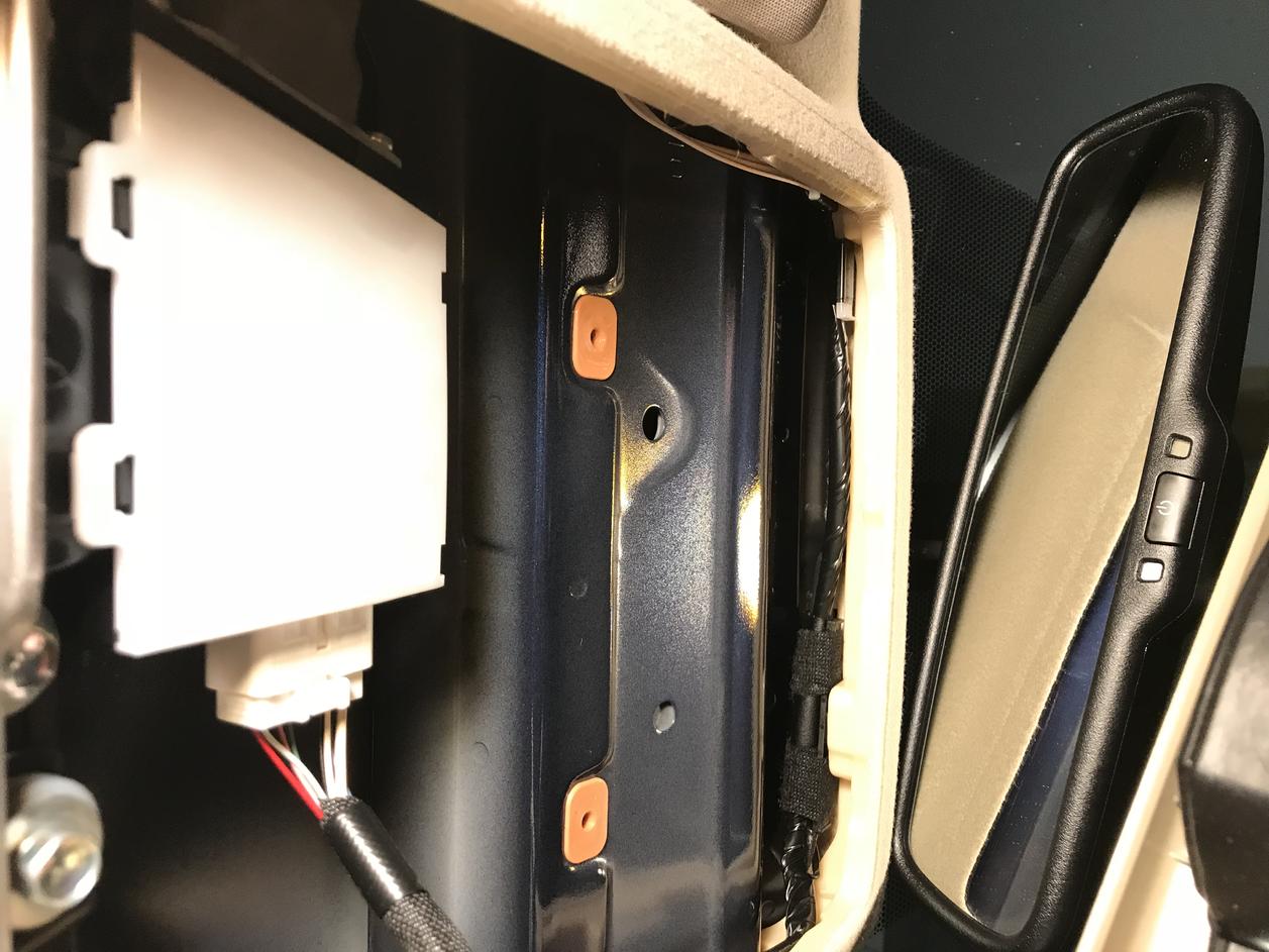

See all my pictures below. I started my taking down the sunglass holder console so I could stash the hardwire kit transformer and extra wires.

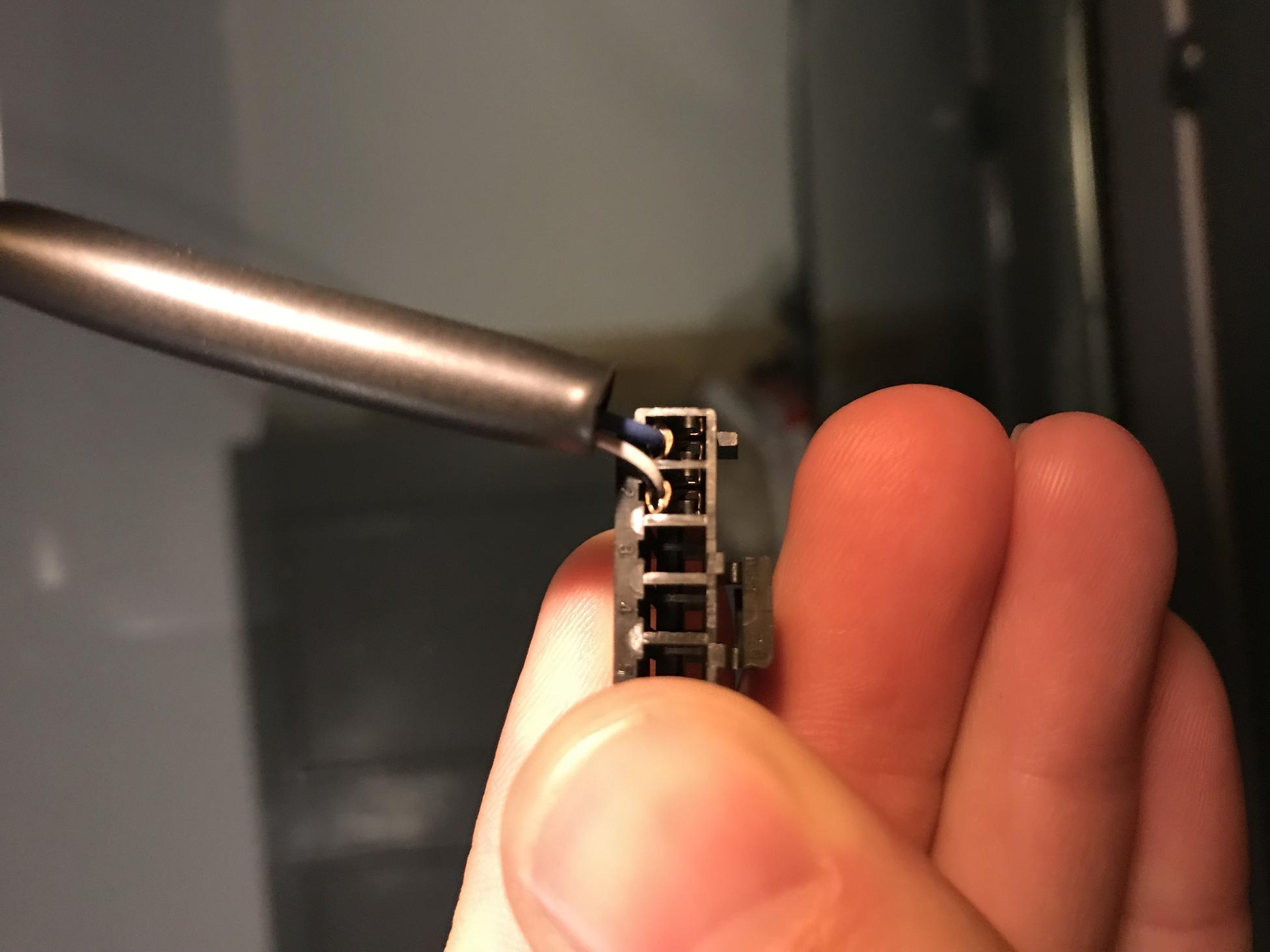

Since I was going to grab power from the back of the rearview mirror, I had to wirenut in some extra length wire to the hardwire kit. The low voltage wire I used was stiff enough to feed down through the wiring sleeve that feeds the mirror. So, I fed the two new lv wires from the headliner down through the sleeve directly into the wiring harness in the back of the mirror. The wire was also stiff enough to stick directly into the correct wiring slots-- and stay put! No electrical tape, no cutting the T4R's wires, nothing!
It has been 3 months since installation and the connection has not loosened once. Solid metal-on-metal contact in the back of the wiring harness.
Then, I simply plugged in the dash cam's usb into the hardwire kit's usb that I stuck out of the headliner. Done!
