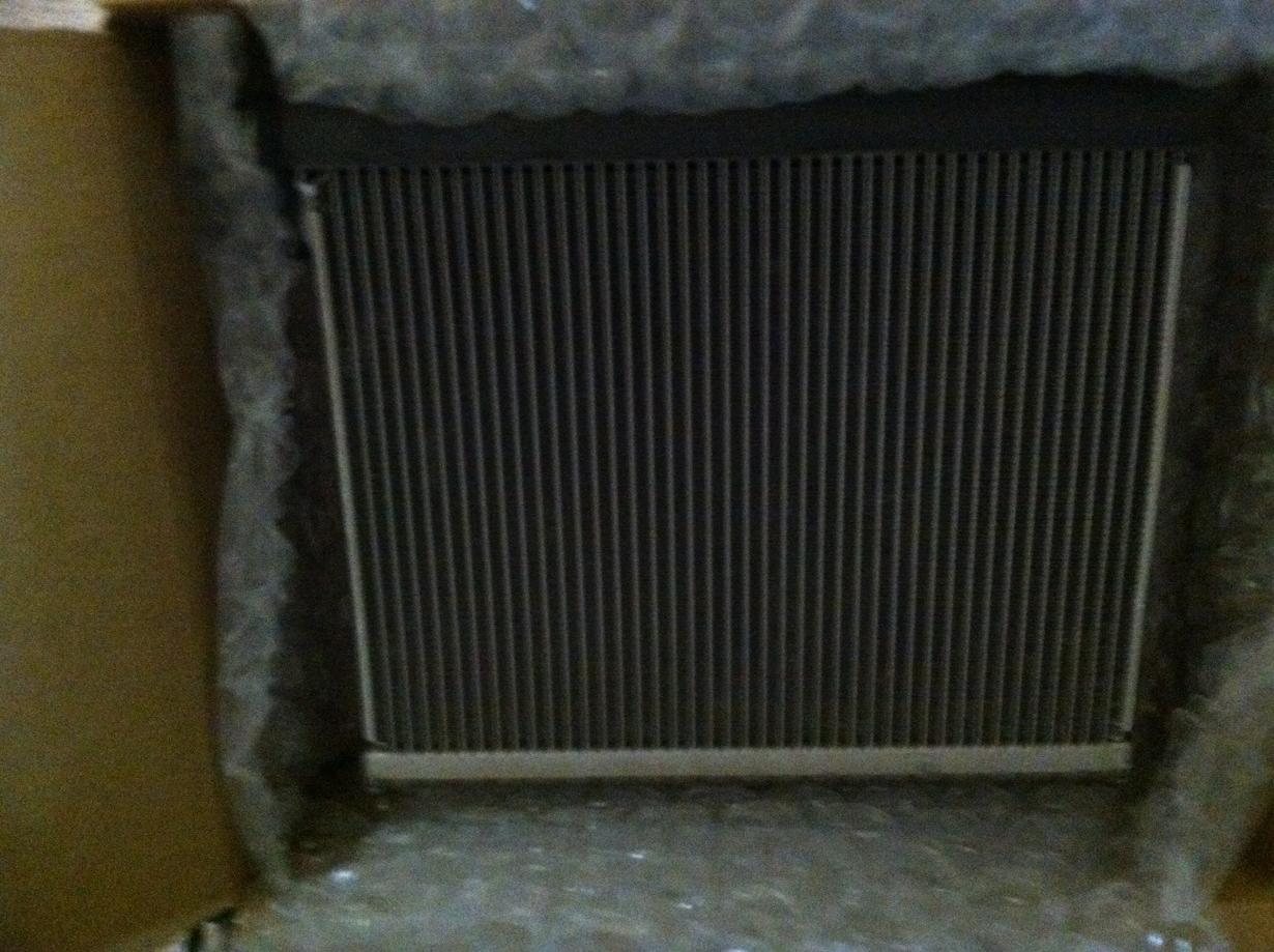

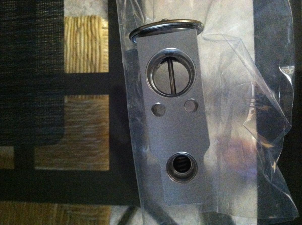

Well, $150ish later. I have a new expansion valve & evaporator core from RockAuto. Toyota quoted me $770 to put the parts in tomorrow. Hopefully this fixes the problem.
