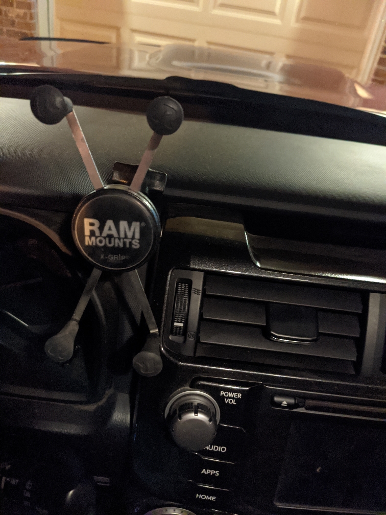

I did the Ram Mount. It's very easy to take all the facade off. I think I googled Ram mount 4runner install. I think whatever button you install should have a bezel to hide anything. I can't recall any cracking or flaking.
Sent from my Pixel 4a using Tapatalk
Didn't do any drilling in the lower area, but I've got the Expedition Essentials PAM. Had no problems with the finish chipping or flaking off when drilling the 4 mounting holes.
I've got a few RAM mount balls for misc accessories and an X-Grip for my phone on this.

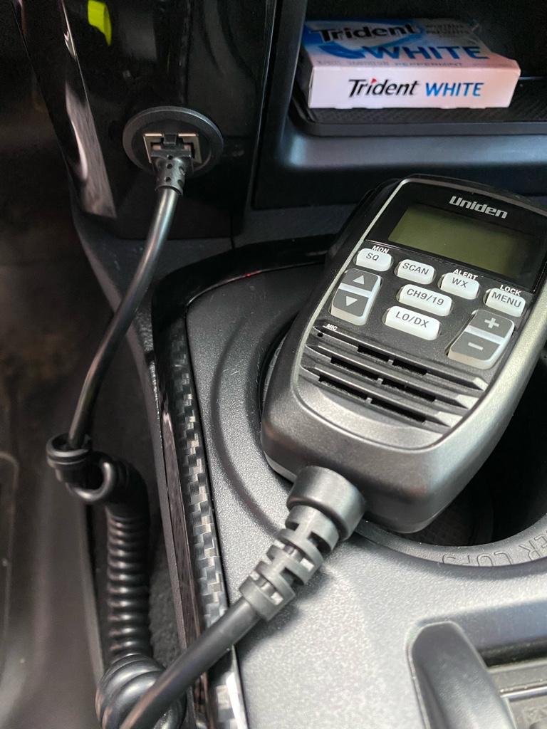

I'm going to mount an RJ-45 port insert to connect my CB radio (and maybe another one somewhere for a future HAM radio).. I think I'll just go with a hole on left side of the center console.

I drilled from the front and installed a ram mount ball on the driver's side AC panel. I put some painter's tape on the spot before drilling. This helped in two ways: prevented chipping of the finish and allowed me to clearly mark the site for the hole.
I started with a pilot hole and sequentially increased the size of the bit until the bolt I selected would fit.
If you are still planning on putting the ram ball there, I would suggest attaching the phone holder to the ball and placing the phone in the holder so you can see exactly where the phone will end up. It may take some maneuvering to avoid the AC knob/shift knob/your kneed depending on phone/holder.

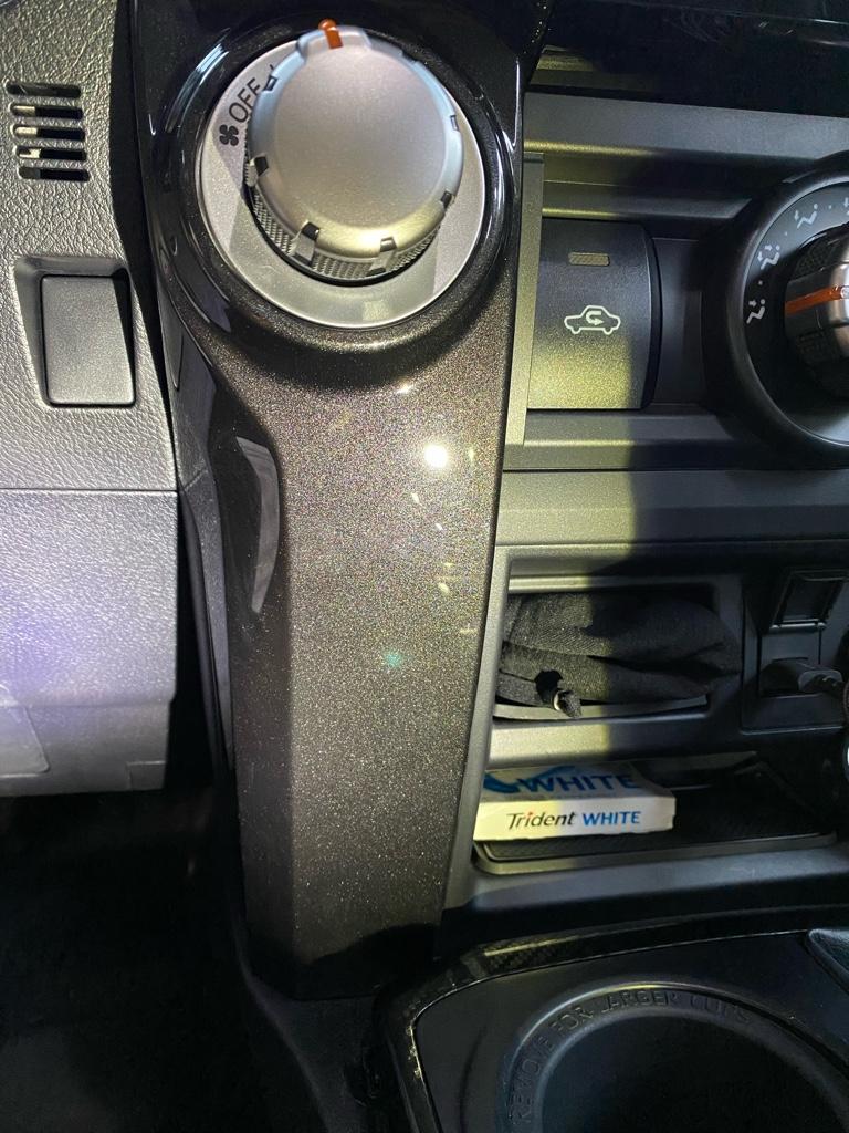

For closure if you need it haha... I pulled the trigger and I love how it turned out.
Pilot hole confirmed I could drill from the back.
Found some cool black clip mounts for the mic too but I didn’t get a picture. Thanks for the help folks.
