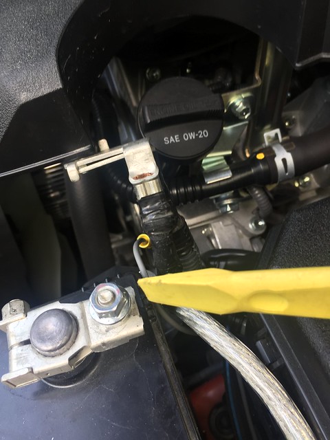

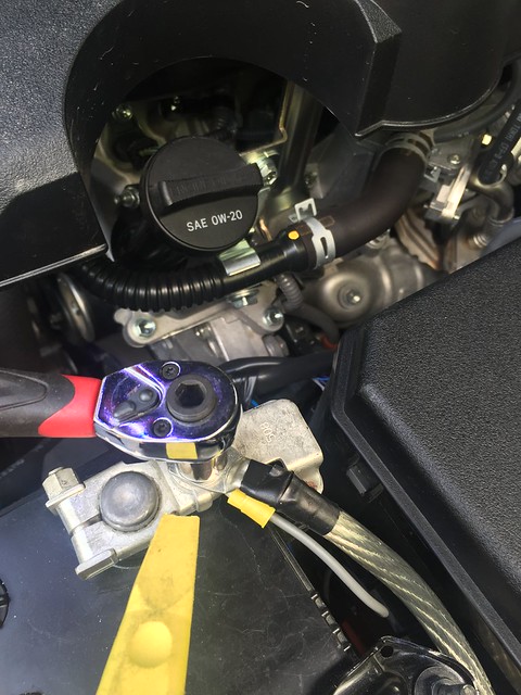

Step One: Unhook the positive terminal on the battery. You will be removing an airbag and other pieces that can be effected by a positive terminal connection.
Note: as in the picture above make sure that the terminal is disonnected from the battery and is unable to reconnect. You may place a piece of cardboard inbetween the connection and the terminal to be safe.

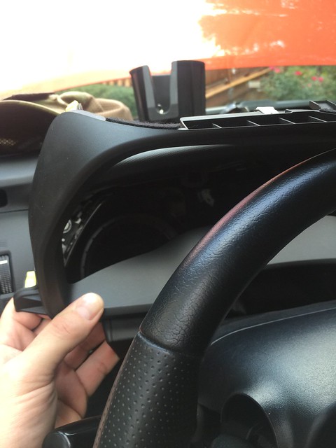

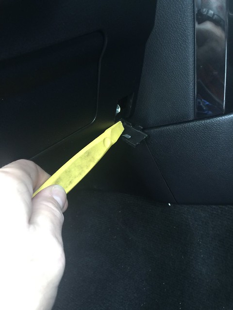

Step Two: Driver's Door Sill Trim Piece
Open the drivers door. Remove plastic trim on the sill using a plastic pry pulling up in a lineard fashion. The trim piece is secured by plastic friction clips.
Secure the pieces. Be careful as to not break the clips. Do not force the trim piece. The piece will give with steady force. The front part of the trim piece is attached to the drivers quarter panel trim piece and secures in it. Lift up and out to remove from the quarter panel trim piece.

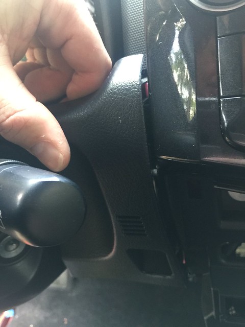

Step 3: Drivers Quarter Panel Trim Piece
Note: Make sure rear wheels are chocked for your safety before continuing with this step.

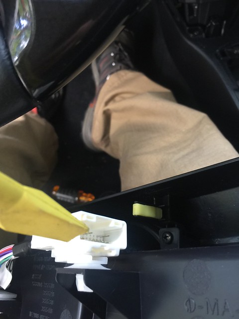

Disengage the parking brake by stepping on it. After making sure the vehicle is securely in oark as well continue.
Then you will have suffecient room to pull the panel out towards you. If you cannot pull it out you can unclip the small round peg attachment to the right of the footrest. Once this is rmoved the oanel should unclip easily out towards you.

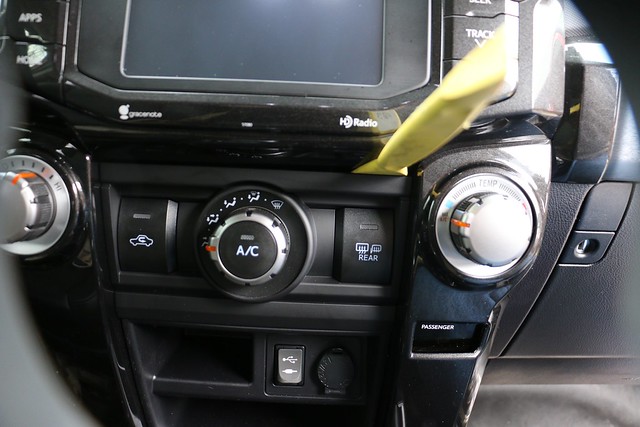

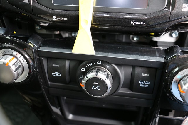

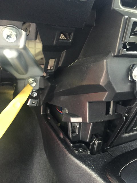

Step Four: Center Dash A/C Control Trim
It is the trim piece that is located right under the radio. This is also houses the A/C controls.
Use the plastic tool to pry away the trim piece from the dash. It will oull towards you. It is held by plastic friction clips.

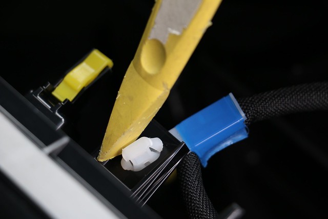

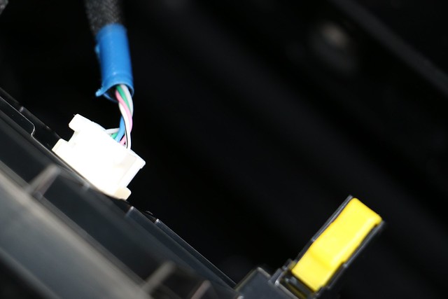

You will alsoneed to use the trim tool to disconnect the electrical connections as documented in the pictures below.
