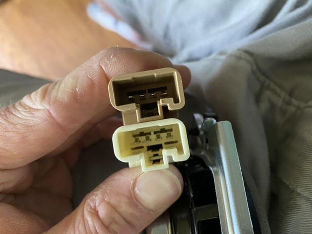

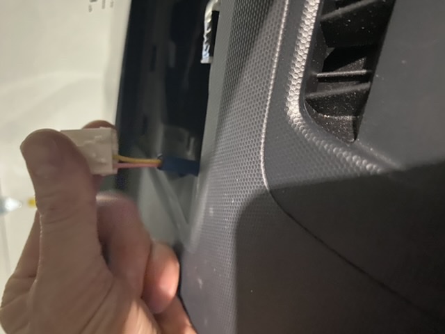

I am replacing the stock tweeters w/ 3.5" since one of my tweeters are blown.

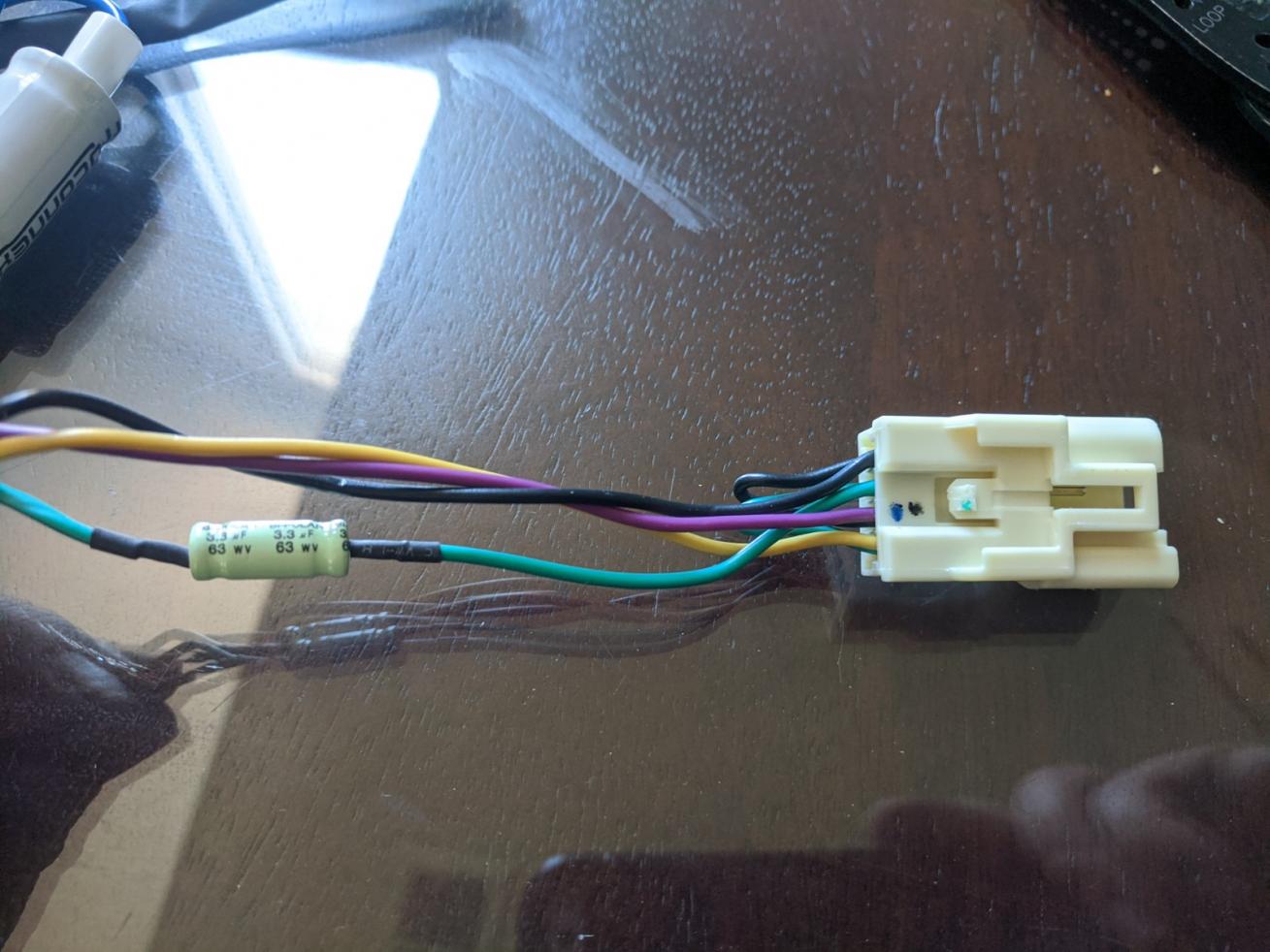

I have looked through all of the write ups and still have a question since my wiring seems a bit different (see pictures).
Goes to Tweeter
Yellow = +
Purple = -
Goes to Front Door
Green = +
Black = -

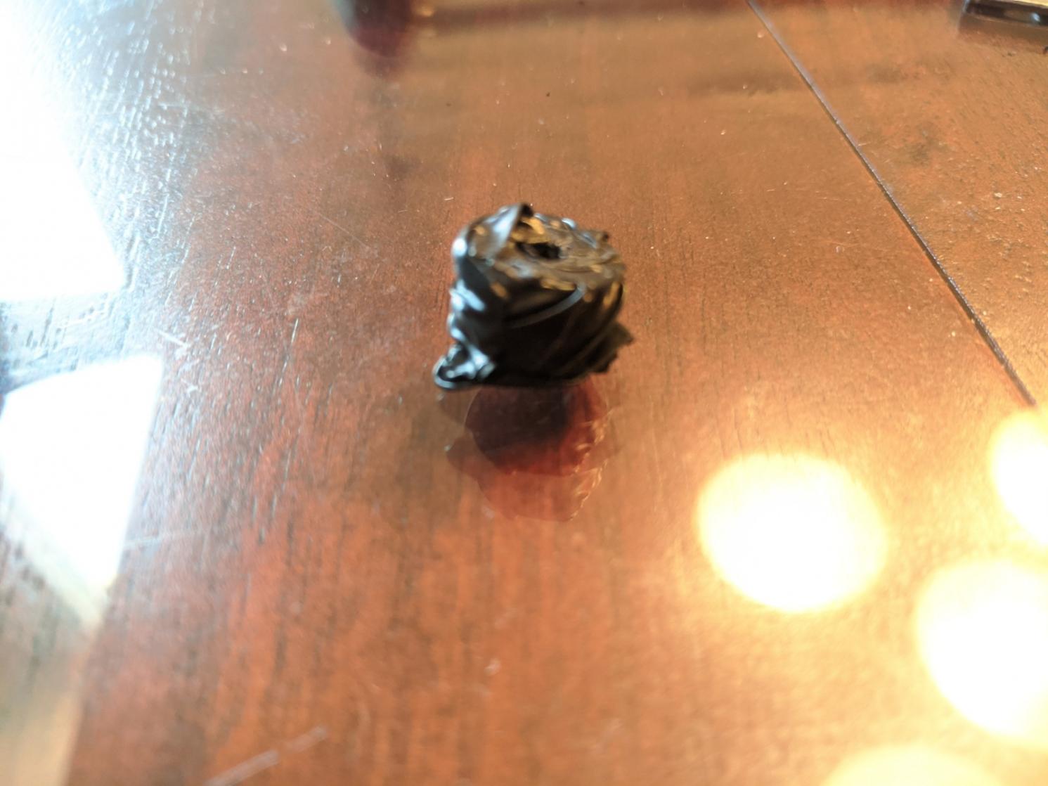

I have a capacitor on the positive lead for the wire that goes to the front door (green).
How should this be wired? Do I cutoff the green wire w/ capacitor since it's jumpered anyway? And cut the black? Not the jumpers.

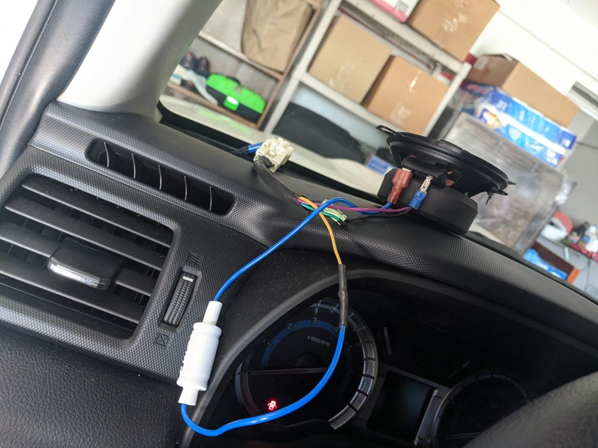

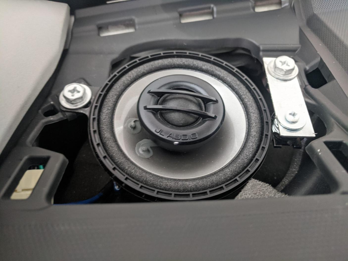

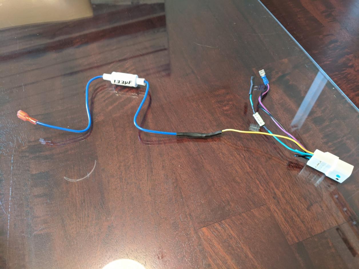

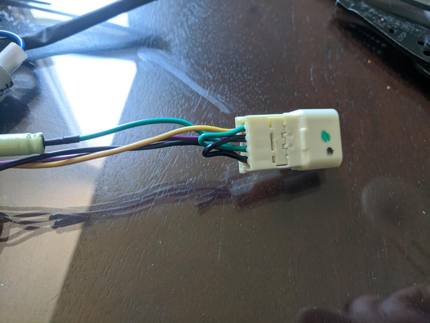

I ended up wiring it purple and black together for -
and capped the green. then i soldered the bass blocker inline w/ the yellow wire.
see pictures of the wiring harness to speaker.

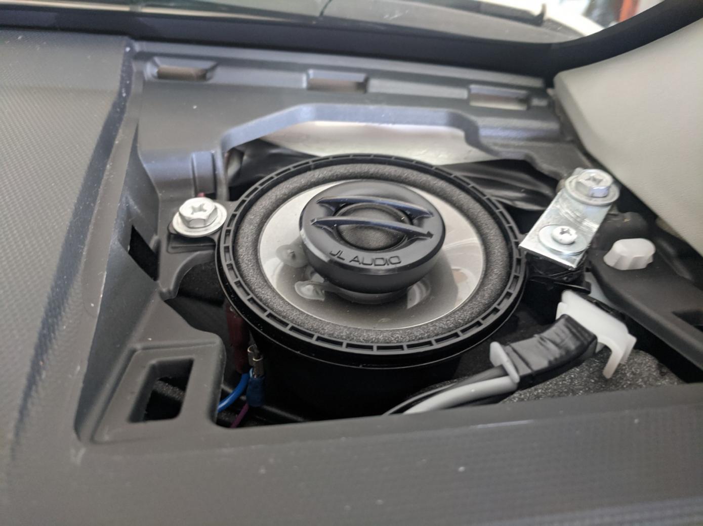

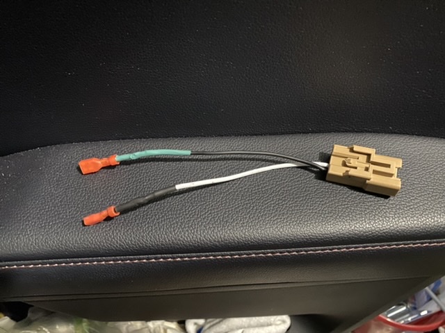

I just installed some JBL 329s in the dash and if you look at the connector coming from the amp, it only has 2 wires, one + and one -. The jumper wire you see along with the 2 wires coming out to the speaker has one set for the mid, and one set with an inline capacitor for the tweeter. You need just the 2 for the mid.
I initially installed the capacitor that JBL provided, but the sound was very quiet and it made a popping noise on startup. I removed the capacitor and the volume increased, the pop went away, and no distortion at Max volume (I listen to gangster rap).

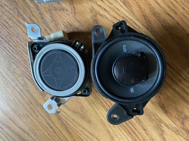

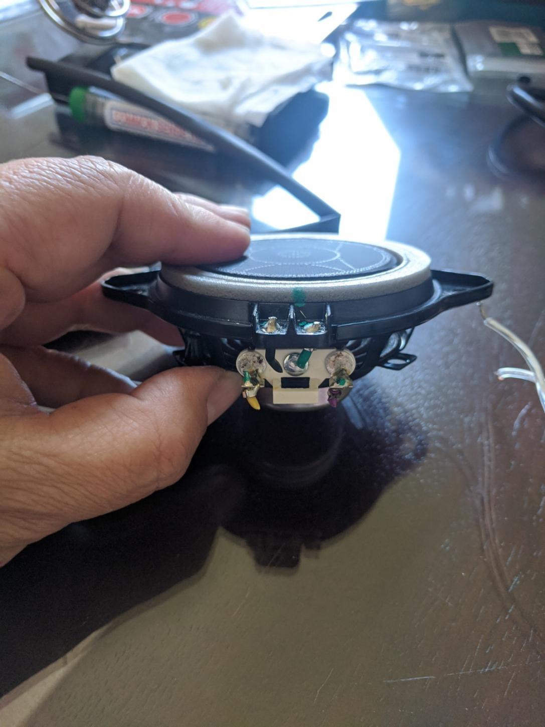

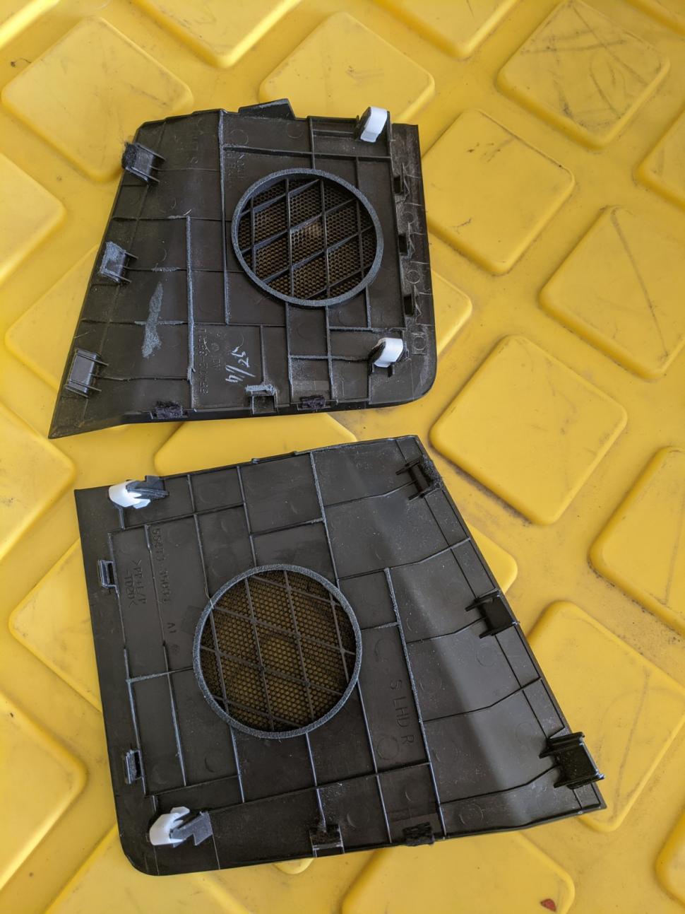

I didn’t want to destroy my factory speakers, so I used the Taco Tunes harness (they do not have a JBL specific harness listed for the 4Runmer). 3D printed the brackets (thank you member on this site that posted the STL files!) and reused the factory bolts.
I did this mod, because I have blown the dash speakers 2x under warranty, fried the amp, and blew the subwoofer. This JBL system has done pretty horrible. Now that I am out of warranty (still only 29k miles on it), I have no choice but to upgrade to prevent a gap in music while I drive. So, I am in the process of full upgrade.

Initially I joined the 2 + with the oem capacitor to the speaker but it was quiet as you mentioned. After that I decided to just cap the green wire (+) and us the yellow (+) to the dash speaker ...now dash and door work work fine.
