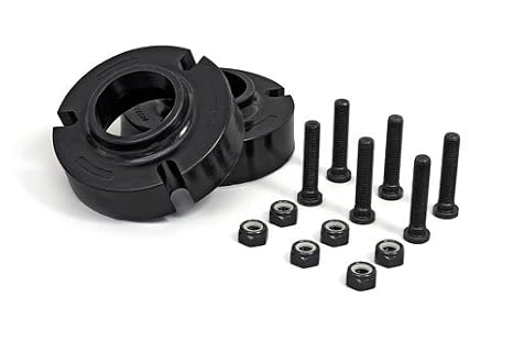

I'm interested in picking up the Daystar 1" Leveling Kit for my 2006 4Runner V6. Forum members have reported that this raises the front of their car by about 2".
Now, I was about to order this kit on Amazon: KT09117BK
However, I read that there is an old design version and a new design version. Can anyone shed any light on what may be different between the two?
I'd like to be sure I get the correct on if I order on Amazon.
Thanks,
Luke
Thanks Brian, but what's different about the two designs?
Why was there a design change maybe I should ask.
I have the new design. The old design requires you to disassemble the strut assembly. New style uses studs that thread onto old studs. Much easier install. Just remove the strut assembly enough to slide new extended studs on and slip spacer in. 20 minutes a side.

New design:
Old design:
[MENTION=113957]MrRoo[/MENTION] is correct. The new design allows it to be easily installed onto the top of the stock strut assembly.
Anytime you mess with the suspension where angles/height change, it is generally highly recommended that you have an alignment. That said I personally did not get one and had no issues. But I also only ran my daystar spacer for 2 months tops as I went full OME suspension shortly after.
