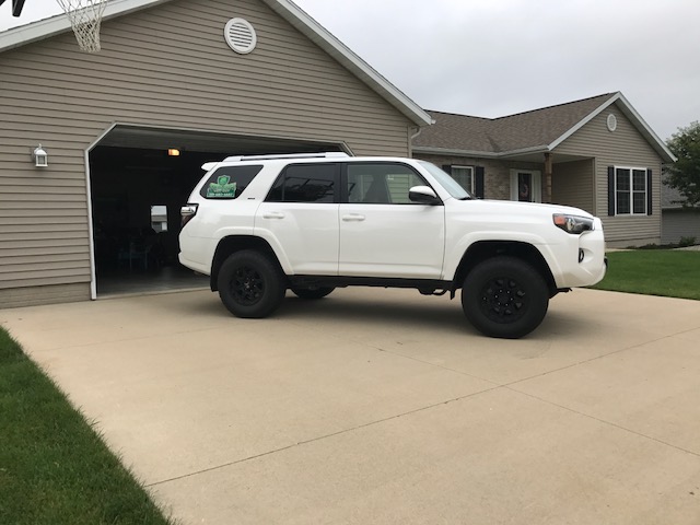

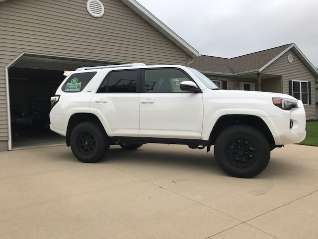

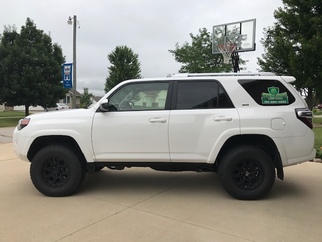

I just got the 2.5"/1" Cornfed spacers installed on Thursday night thanks to my brother and his mechanical ability. I think it has a bit of reverse rake. I may end up ordering the 2" rear.
Also check it on dead level ground with nothing loaded and all tires equally inflated.
Drive it a few hundred miles and see what it looks like. The springs will settle and it may end up "level" what ever that means.
