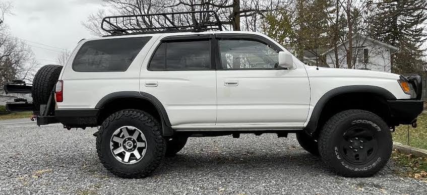

Alrighty, today was the f*ck around and find out, phase.
They were on, now, just rears are.
Fronts *juuuust* rubbing the UCA, so spacers it is.
They slapped my old ones back on so I could drive home, and my shop is seeking out locally available spacers, they feel an inch will get me where i need to be.

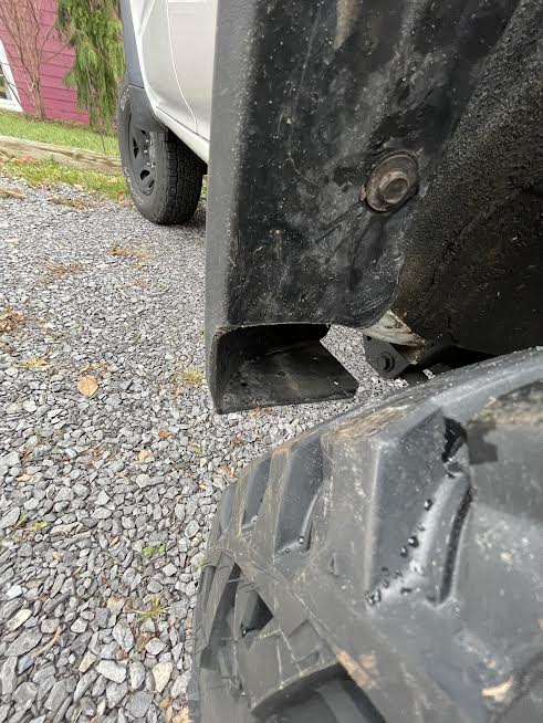

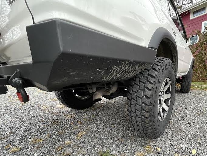

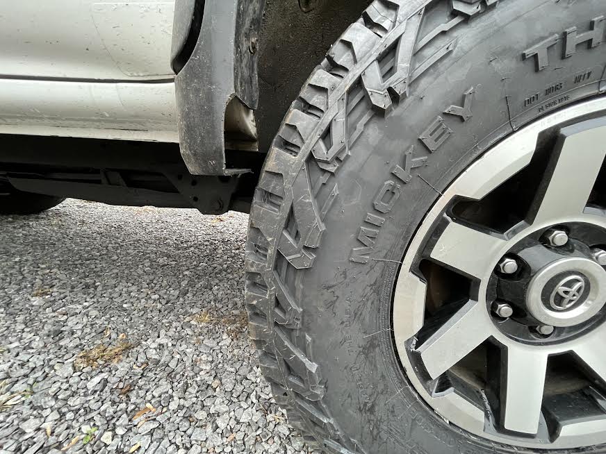

I hadn't anticipated how close to the front edge of the wheel well, the rears would get (I can' say I'm surprised though), it does ZIP a touch during suspension compression, as the pic will make pretty clear.
Curious how folks have dealt with that, since the spacer obviously won't. Maybe it just sands itself down through enough plastic and I ignore it??
Pull the rear flares off and trim the INSIDE at the bottom there a bit. If you notice, they are about 1/2" farther back in that area than they should be. There is a lip on the inside that pushes it that way that you can avoid. When bolting on, push/adjust it as you tighten the bolts to get the best alignment. You should be fine on the rear after that.

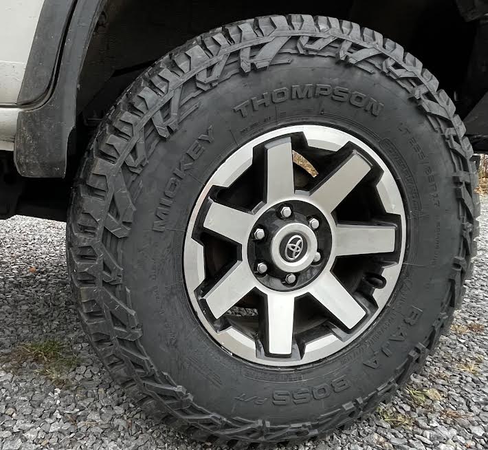

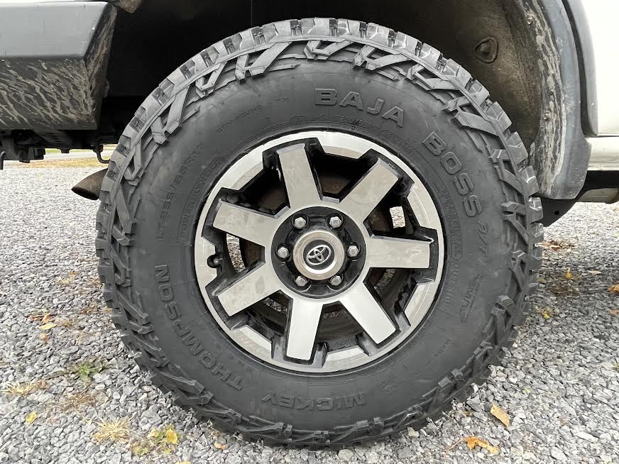

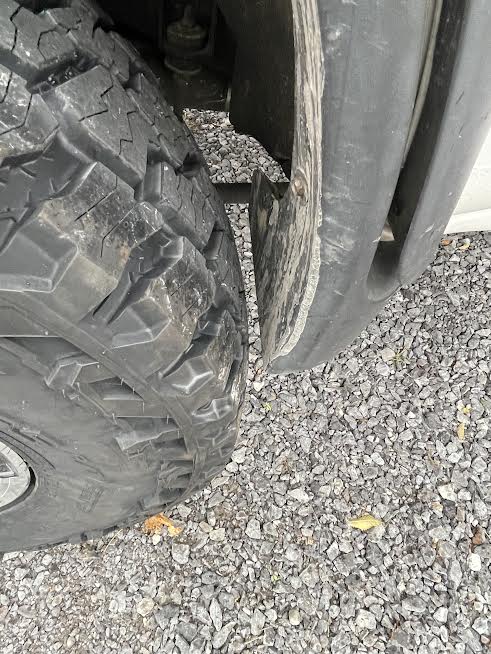

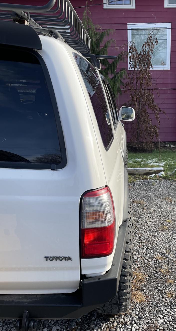

So I got brave yesterday, removed my flares, and went to town.
Used a straight edge and level to determine exactly how far forward the clearance gain needed to be.
Dremel abrasive cutoff wheel did a gorgeous job, BTW.
The *tire facing* support material from farther up, sits well out of the way but extends down just far enough that I needed to do a gentle little radius, rather than a nice straight line, but it's subtle, and I'm okay with it, though I may go back and see if I can find a way to minimize it's appearance a little more, it's an odd convergence of material in different planes and angles, tricky to not have it look like a 4 year old with a chainsaw did it.... :nono:
Honestly, pretty proud of my results, and hopefully I'll have spacers by the end of the week.

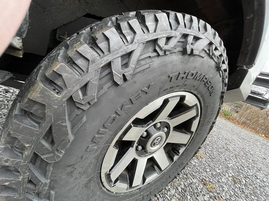

Last pic if just of the sidewall tread, dang, I love the tires!

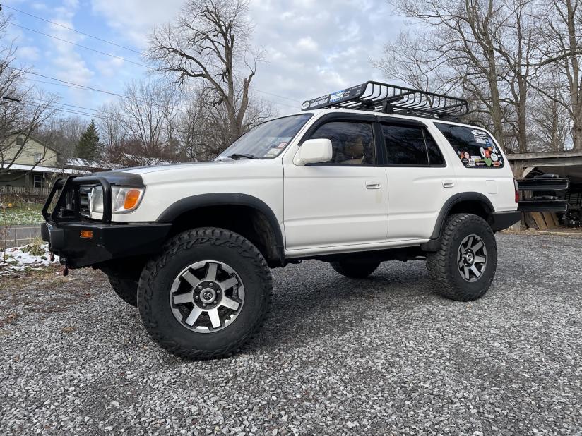

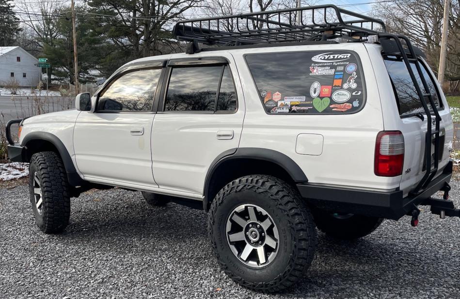

Okay, everything is on, and working, mostly....
Rears I already had sorted, SpiderTrax 1.25" spacers just bumped things out a little, ^the clearancing I did^ seems to have made them no longer rub.
Fronts, I am getting a bit of rub when near the stops, and it's hitting right at the lower most bolt heads holding on the fender surround.
There's plastic wheel well liner behind it too that seems to be buzzing a touch as well.
Do folks just carve that section out?? Or am I uncovering some sheet metal hole that's going to send road debris down into a deep well, never to be seen again?
I'm guessing that's the region that folks are beating back with a 2x4 and a hammer??

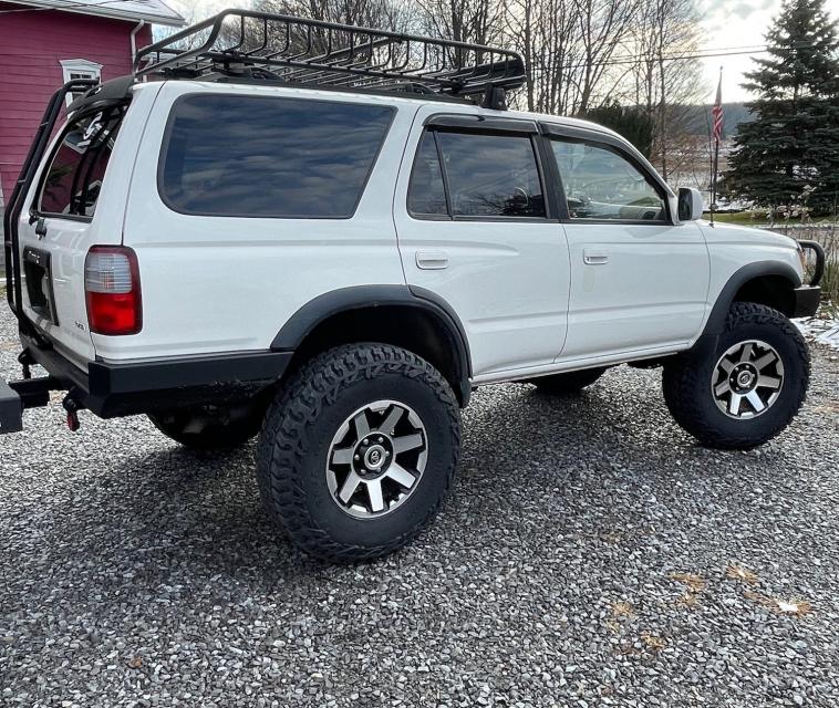

Everywhere else, full stop in both directions, not seeing any rub potential, so I'm pretty happy. The stance increase is really minor, I'm surprised, they still sit within the fender surrounds for the most part.
Going into storage later today since the roads got salted this week, so the 50 mile drive before checking spacer bolts torque, will come in the Spring, along with the more aggressive rubbing mitigation.
Love the look of the newer style wheels, and I nailed the look I was seeking in terms of no tiny doughnuts in huge wheel wells, things look nicely proportional again, and I really dig these tires too.
A big thank you to all who stuck it out with me, your help is much appreciated, hope you all have a safe, fun winter!

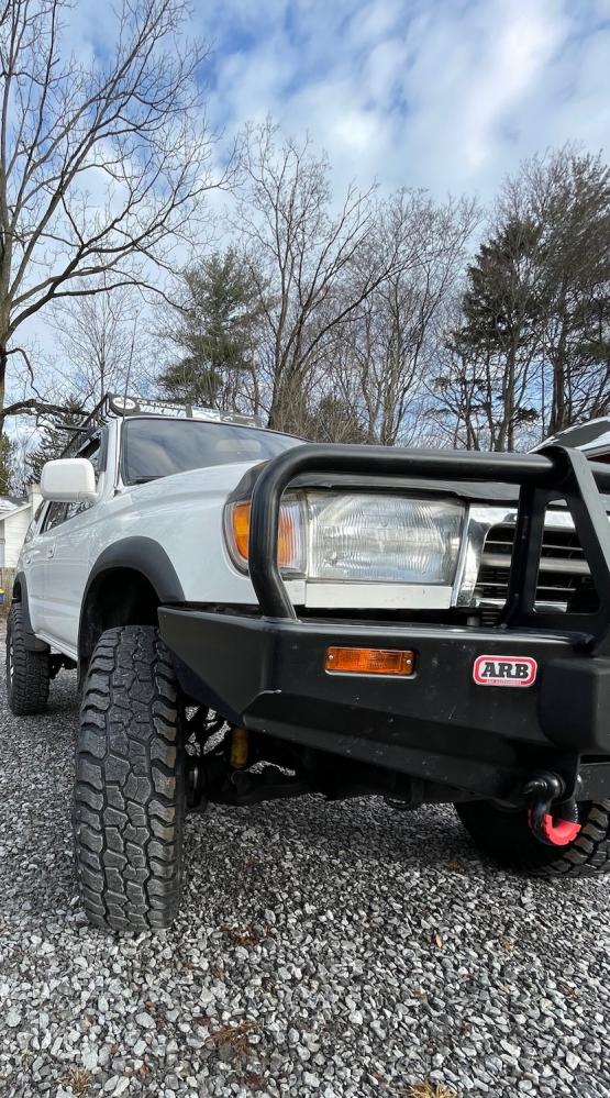

[MENTION=284604]Mendoncyclesmith[/MENTION] looking really nice congrats.
I've used the Truss style McMaster-Carr to help with the scrubbing on that bolt head.
May be all you need. Measure what you have order accordingly may be different than what I had.

Thanks! Just put her to bed for the winter, wish I had more time, ah well, Spring will come soon enough.
Noted on those screws, thinking I'll need to be more aggressive than that.
Dremeled about half the height off both heads, still enough there to see the tire yank one out, sigh.
Come Spring, I'm getting the cams replaced so the full range of alignment adjustment is available, (that'll do my LCA bushings too, and hopefully kill my *thunk* in the process), and hopefully that will allow for a bit of caster adjustment forward to help with clearance.
I carved off the lower end of the plastic well liner (and removed my little running board delete fender surround caps too), a distinct edge seam was now visible, I Dremeled that back too, and the tire still catches as it swings past in a full turn.
So either alignment magic if that'll work, or, going to have to get more aggressive in my bending, deforming, grinding, etc.
