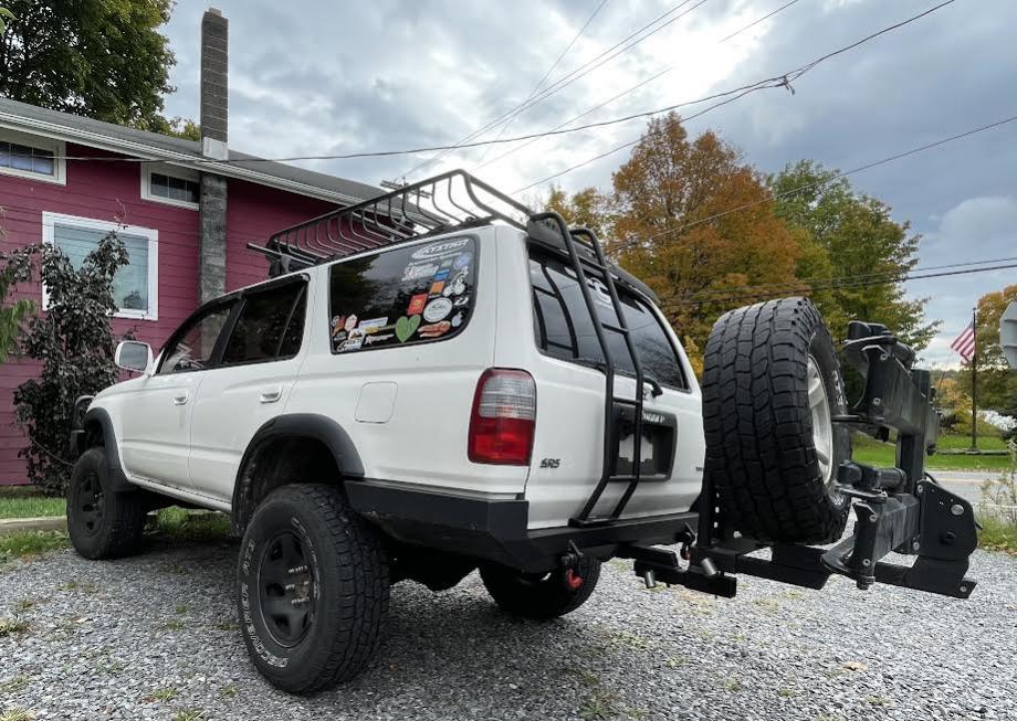

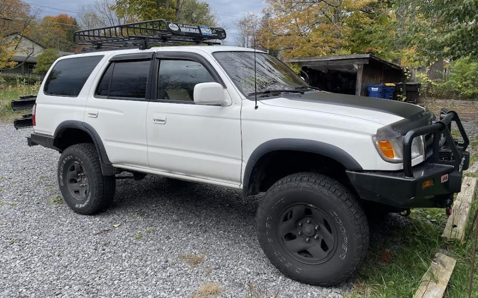

And, pics just because... :thumb3:

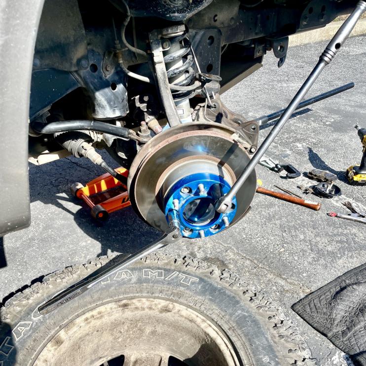

I have zero offset 17s Methods w/285s with Dobinsons UCAs and lift, was able to get 3.5 castor, said maxed.. Had to trim very little and remove mud flaps. Have ran the thing on some rough stuff last 2 trips out, and backing down a 40 degree hill uneven terrain, no rub..
I'm going to grow up and get the right size aftermarket wheels soon, too. I do feel the $125 was fairly well spent and got me through the last 2-3 years while spending the $2000 needed for new wheels and tires on other areas. I was reminded of the extra level of fvckery involved with spacers when I did my rotors and pads yesterday.....

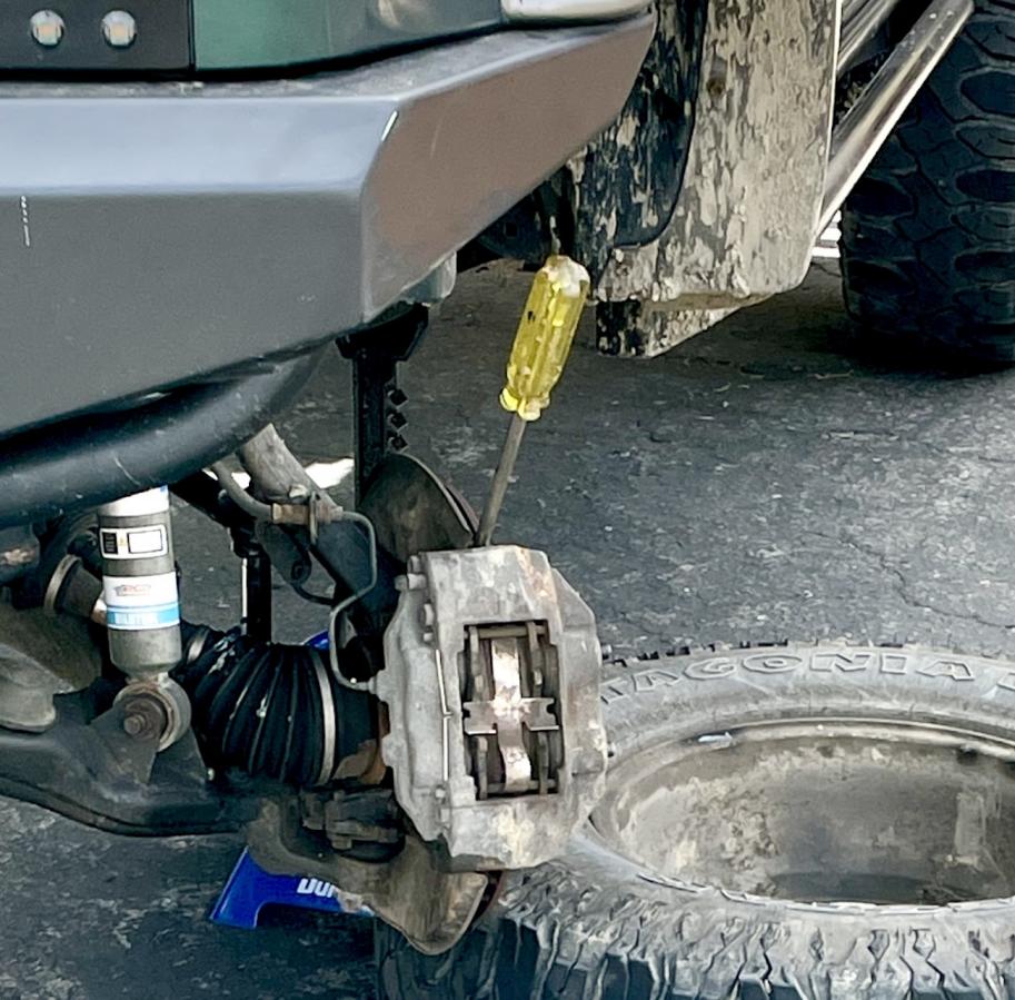

Gotta ask why you chose that moment in the process?
A screwdriver or drift punch in the rotor vents against the caliper eliminates the fuqqery.
Been using screwdriver since last century work smarter not harder :)
In a word: Inexperience. The caliper was already off. I stopped to take a picture of my lunacy and I figured it out when I put it back together and on the other side....
