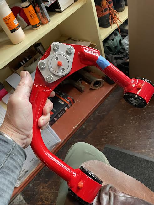

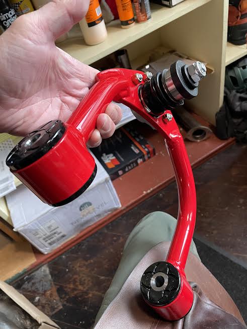

Also! Just got these bad boys in, they look great!
Hopefully they perform even better....
