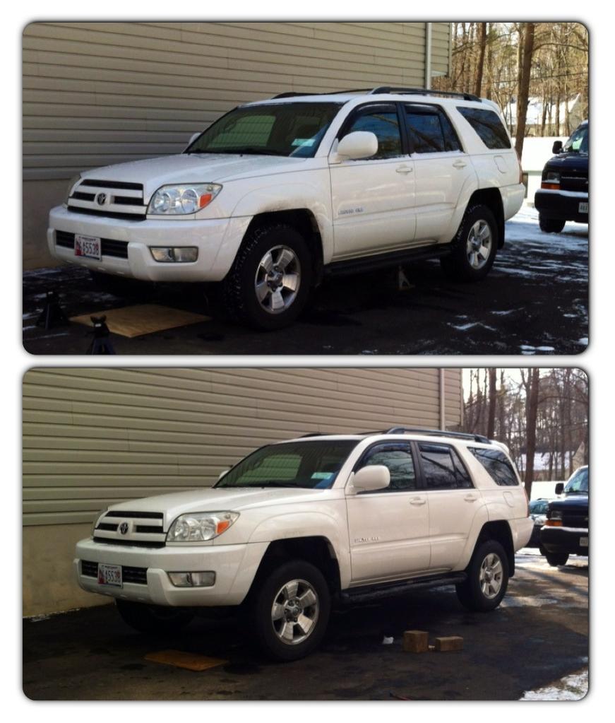

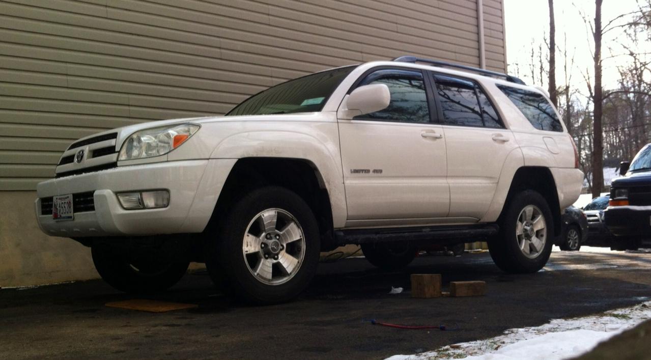

A buddy of mine came over to give me a hand while I did the install. I would say it took about 4-5 hours, with temps in the mid 20s. I had to use a propane blow torch melt some of the snow/ice from driving the day before.
On the front, I undid the Upper Ball Joint; it came loose with 4-5 smacks on from a mini sledge. That rear top bolt is a pain, good thing I had a ratcheting wrenches. The rear was a breeze, I dropped the coil out and installed everything and pushed it up in the hole.
Next month, my buddy is installing one on his 4Runner and it should go buy a couple hours quicker (06’ no XREAS, hopefully warmer temps).
