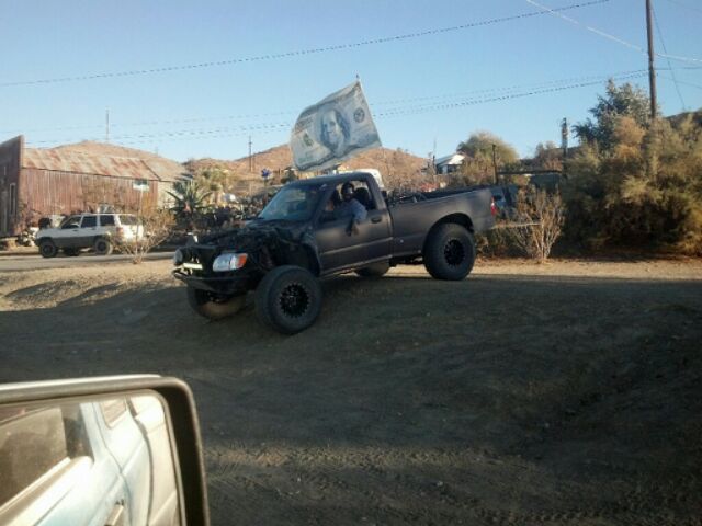

This what I have now...... I know the 4runner won't be able to be as solid as my truck now but I would like it to perform a almost as good
