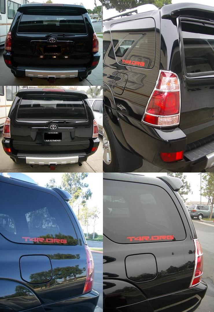

Ok, I've got some before and after shots. The sun hasn't been really out yet, so the pics are pretty bad. I'm sure I'll be taking some better pics as I finish other mods. These stand out quite a bit and definitely aren't for everyone, especially the chrome haters. But, I like the look a lot and am totally happy I got them.

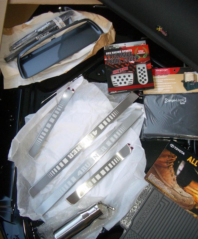

Thanks guys, I'm just getting started! Check out what I picked up today (prices are after tax):
  • Door Sills
    - 4runner Dr Sill (PTS21-89040) $59.26
    - 4runner Rear Sill Kit (PTS21-89041) $47.41
  • Exhaust Tip 4runner (PTS18-89040) $39.11
  • Xtreme Cargo Mat (PTS07-89031) $71.12 (CAUTION: I think this part # is for w/out DD)
  • All Weather Floor Mats Grey (PTS206-89036-03) $70
  • OBX pedals (PTS22-0C030) $32
  • Cargo Logic Tote (PTS07-00020-02) $28.45
  • Sport Hood
    - Hood S Stk (53301-35150) $274.17
    - Plate, Hood Buldge (76192-35020) $12.16
    - Guide, Hood Air (76182-35060) $11.35
    - Bulge, Hood (76181-35050-B1) $78 (CAUTION: I think this part number is color specific and I actually got a grey one by accident, but kinda like it)
    - Painting ~$200

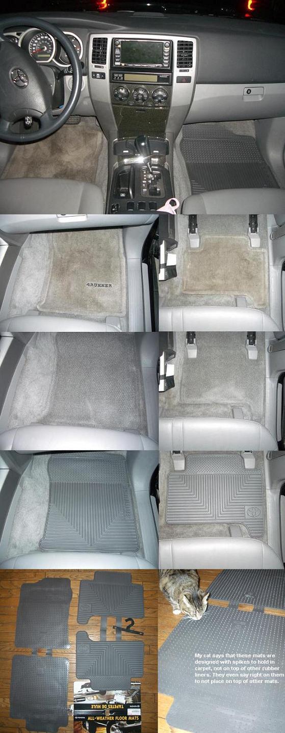

So, the first thing I installed was the AWMs. I love them! Even though they add a very sporty look to my leather/nav interior, I am way happier with the look than the carpet mats. Of course that is partly because my carpets were so dirty. There are a lot of pics attached below, but the first gives the best comparison IMO.

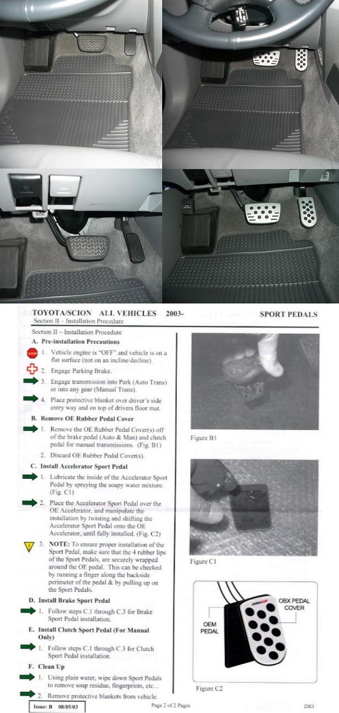

And the only other thing I've got done so far is the OBX Pedals. I didn't find them that hard to install. It just hurts the fingers some. I didn't even do the soap lube method described in the attached instructions.

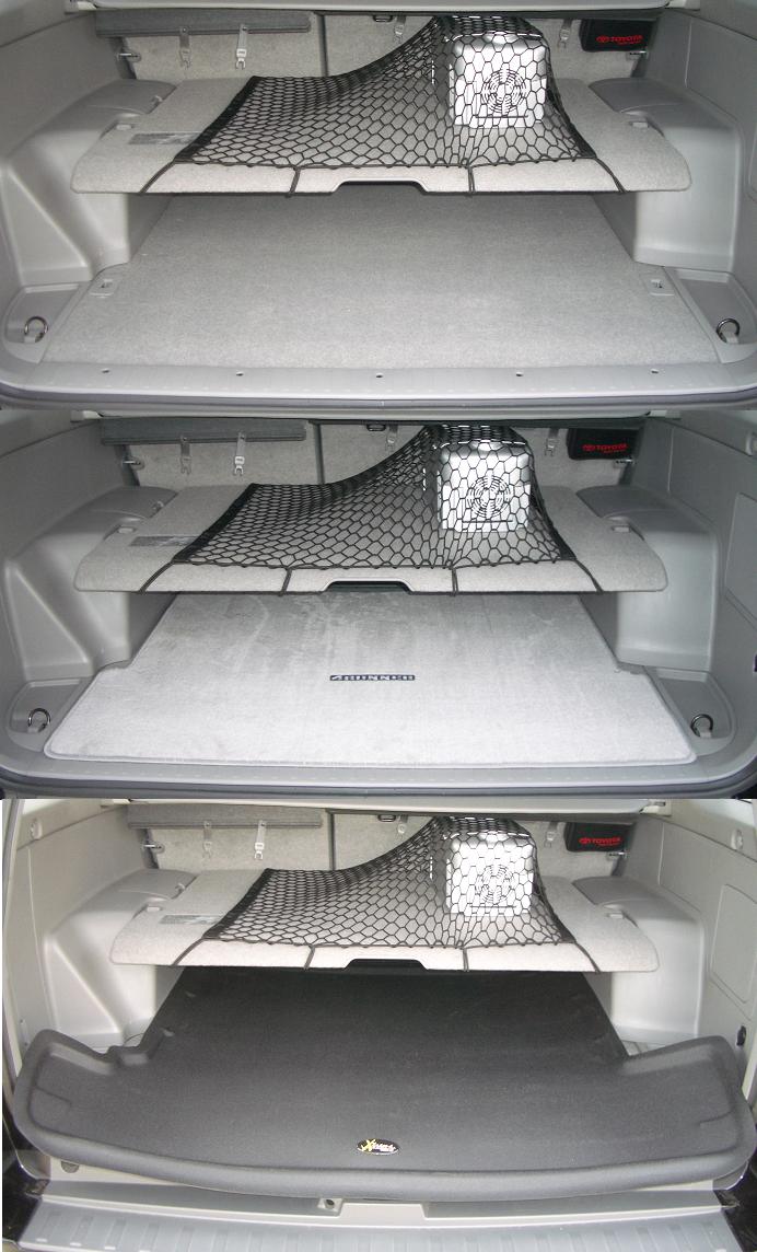

As far as the Xtreme Mat goes, I haven't had a chance to instal/test it yet, as I just got all this yesterday. It is a lot lighter weight than I thought it would be, which should make it easier to move up to the Double Decker if need be. One problem though, I got the one for w/out DD, so I think I am going to return it for the w/ DD version. I'll definitely try it out first though. A cool thing that I noticed is that that big ugly Xtreme logo on the mat appears to be very easy to remove. I'll use this post as a place holder, and post more details here once I've got it installed. I think I am really going to like it since I am totally sick of stuff sliding around when I turn/accelerate faster than I probably should.
Update: I tried it out at lunch and it totally didn't fit. Too deep! Here's some pics anyway:

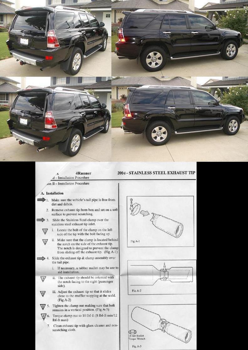

So, at lunch I installed the Valor Exhaust Tip and am a bit undecided about the look. When I slipped it on last night, I thought I liked it a lot, but today I almost feel like taking it off and spray painting the stock jet black. It could be a balance thing, like the dual exhaust makes an even look. What do you all think?

I have the tip and I absolutely love it. I can't see not having it. With such a beefy SUV, the pipe without the tip just looks out of place. Just my 2 cents....

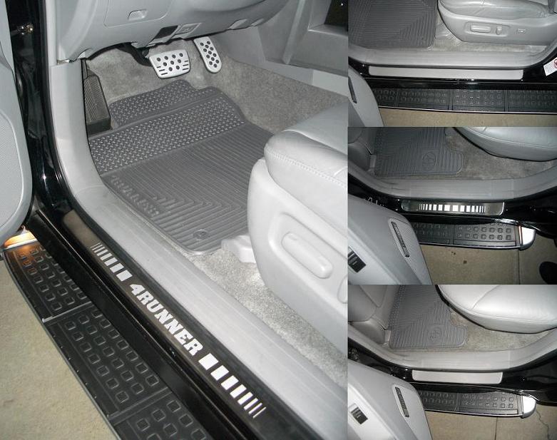

I installed the door sills without following the directions at all. Actually, I made sure that the temperature was above the minimum temp of 60 deg F so that the 3M tape actually felt tacky. All I really did was brush the area with a paper towel to remove any loose dirt and then I followed tkr128's suggestion and those babies seem to be on there really strong. The instructions said to use some adhesion promoter, but it didn't come in my boxes so, I totaly skipped it. Here's some pics:

looks good luxury but damn with all those add-ons your truck is gonna weigh 6 tons by the time you're done with it! ;):

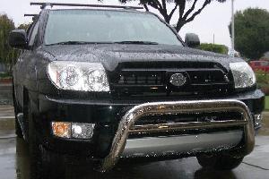

Just posting a small pic so I can get it on the main page :)
