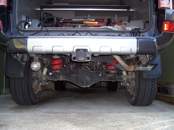

In addition to rear shocks you get two new (longer) rear brake lines made of braided stainless steel, new rear links to adjust the anti-sway bar height, and front spacer plates to adjust the front anti-sway bar height.
Earlier (IIRC) Goodtimes had noted that he felt that Old Man Emu rear springs might be better than the Downeys for heavy loads.
When I went to Utah I had three adults, 15 gallons of water, 10 gallons of gas and lots of camping gear. I rarely bottomed out but I could see that the rear had sunk down. Maybe airbags might be called for but I rarely am that heavily loaded.
