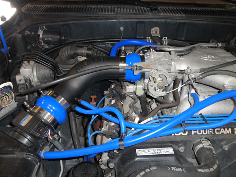

I did the elbow mod and this:
I haven't a clue if there are any more horses in there, but it sure sounds good at 3/4+ throttle and I get better initial response from a stop.
Except for a supercharger, I chalk up all the intake and exhaust stuff on 3rd gens to personalization of our rigs. They mostly result in small gains, but are definitely worth the hobby of it all.
That engine bay looks BEAUTIFUL!!!!
I got a used K&N FIPK off craigslist, it made a difference not just in volume, the ISR and DP mod should do the same or close anyway! All the bad press on K&N only applies if you are to lazy to maintain your vehicle (ie cleaning the MAF).
I really like how those blue hoses make the engine bay POP!!:gun6:
