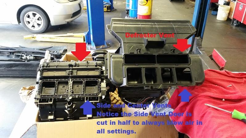

I just wanted to update this thread with this picture I took earlier in the week. This is a 2014 Toyota Sienna I was replacing the HVAC box on, I took a picture because it perfectly illustrates what I was talking about.
BlackWorksInc:
Your explanations couldn't be more clear and regarding engineering design, I further agree that much makes little sense here. I regard this vehicle to be over-engineered to a degree equalled only by the late Saabs and too many Volvos. Technology is great, when it works right.
I would have just liked to be able to keep the fog down and my feet warm without having to blast air, set around 80 degrees, in my face until my sinus cavity achieves Sahara dryness while my feet remain annoyingly chilled.
It is what it is.

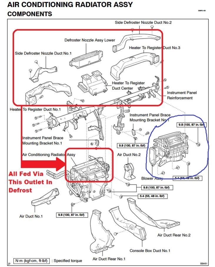

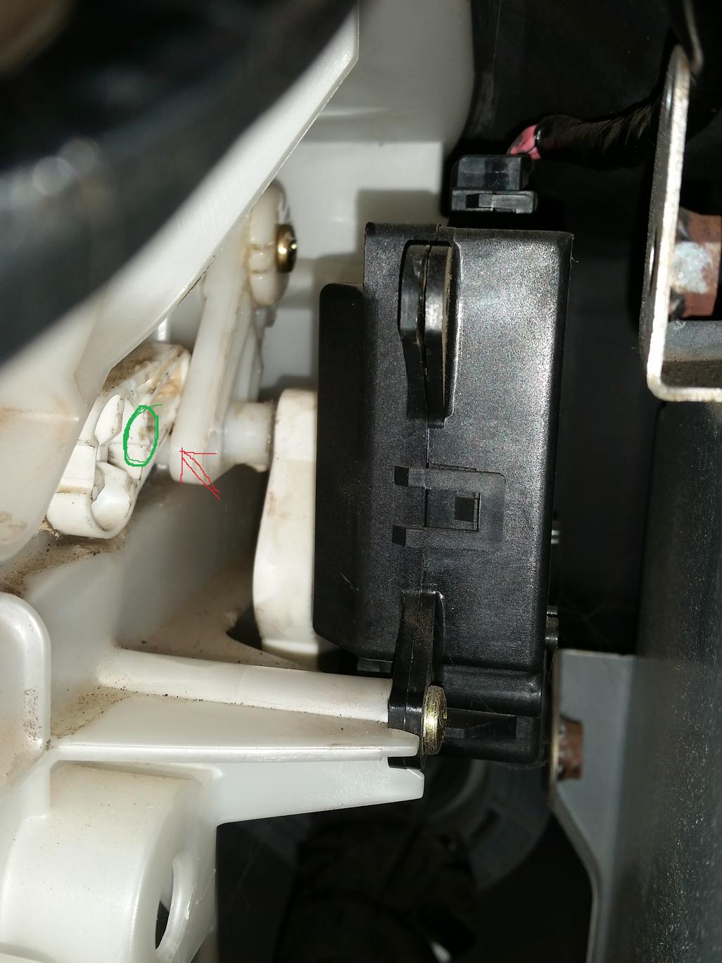

aha, so i have found the problem!.
the servo arm jumped out of its track . similar thing has happened to me in the past and i was able to push the arm back, now i am trying and its impossible,
attached are the pictures, in the schematic you attached earlier, is it possible to remove the complete airbox i circled in blue, without tearing the dash apart?
the major difficulty is not having enough room to push back the arm.
i also attached the pic of the arm and the track.

[MENTION=78511]earthrealm[/MENTION] What I would try to do is get the actuator off the box and then see if you can GENTLY pull the arm back over the slot in the air door lever. If you can't you might be able to loosen that gold screw after you have the actuator off to get some wiggle room to do so.
Usually you can't get the blower housing assembly off the main HVAC box without it on a bench because of clips and screws on the backside. I don't remember how it is for a 4th gen, but most of the other Toyota's I have done have been this way.

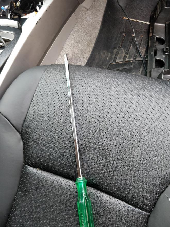

i didnt have to do all that, had a clue, and decided to use a longer studier rod to pry the actuator arm while using my fingers to turn the tracks from the inside, it worked perfectly, and while testing the arm went off the tracks again.
so i discovered it appears to be a design mechanism to prevent the motor from burning out or breaking the arm, once it meets any resistance on the tracks, it will jump off track.
below is the simple tool i used..lol
also because i left the cables unplugged throughout the night, when i started the truck this morning, the check engine ,vsc, trac and other lights came on..i was thinking i would need to do a ZPC, but all the lights went off, on my 4th start-drive cycle

My hand was in the way..preventing the door from opening..that was the resistance that made it go off track again.
But since i had my study tool..it was a simple fix again.
Everything is working ok now..airflow has increased back to normal and i can use my usual airflow #1 or #2..unlike then twas only airflow #3 that was able to push out a decent amount of air.
Also no more exhaust fumes enter the cabin:D:D.
