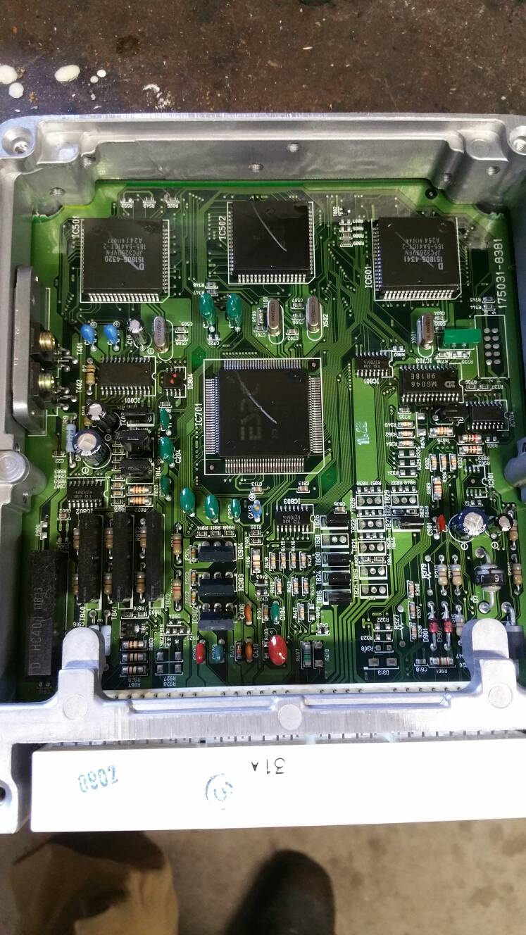

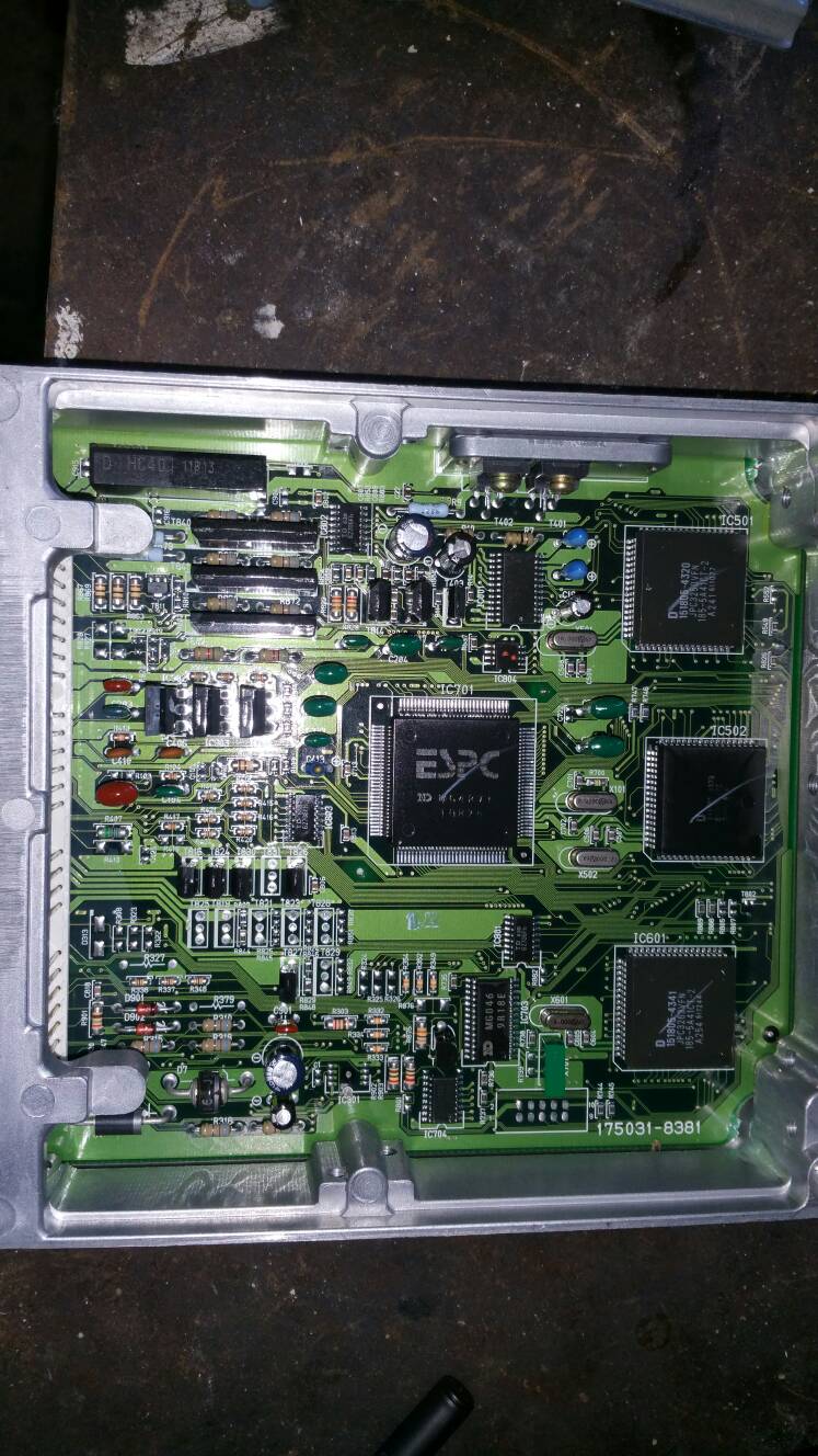

Ok so I took the ECM out and inspected it. I don't see anything wrong with it that I can tell visually. The connectors are all clean and I cannot find any corrosion anywhere.
When I started it to leave work today, I got the P0301 pending code again, seems to be happening more. Engine is running perfect and no CEL lights on the dash, the pending code only shows up on my ultra gauge.
Here are a couple photos of the ECM board.
Still totally lost. Could be the ECM, could be something else. Hmm

Usually you would have to look underneath the board for bad, old solder connections. The caps look fine, though for all the LCDs and plasmas I have repaired I have seen leaking caps work for years with no real ill side effects. Look with a magnifying glass for breaks as well as rust around joints.
