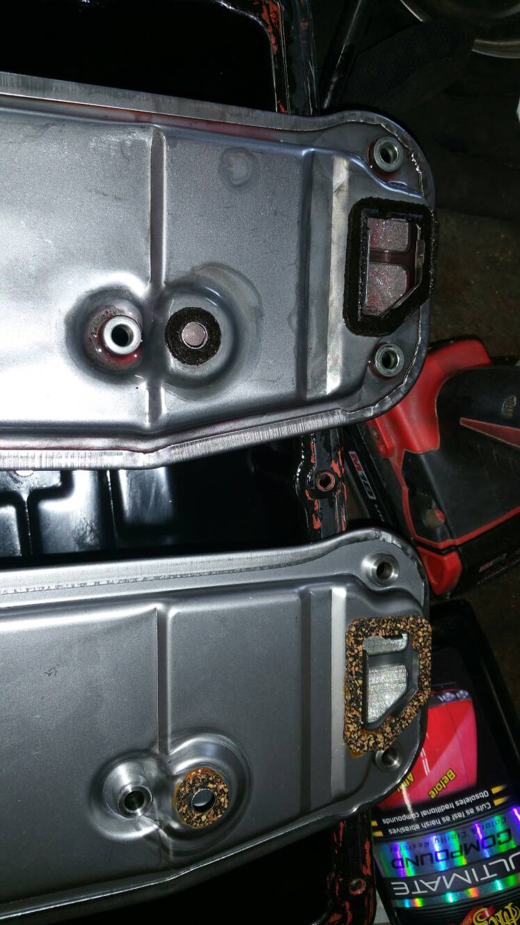

Changed out the filter with a new one and a new pan gasket. Refilled it up and took it for a spin (engine temp was already at 138) and it shifted perfect. Too early to tell if it's fixed, I'll let it sit for 3 or 4 hours and try again.
Fingers crossed!
Ps old vs new filter. The cork gaskets on the old filter were totally smashed down.
Fingers crossed!
