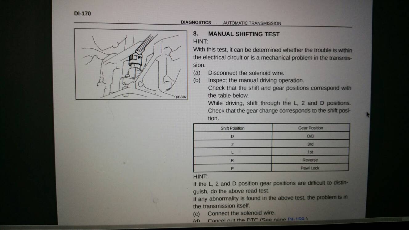

Did you ever perform the manual shift test?
Yes I did, that is when I knew for sure my tranny shit the bed. In fact, that is really what I should have done first before replacing the solenoids etc.
If you disconnect the solenoid plug and it still wont shift manually, you know something mechanically is wrong with the tranny.
At that point, I knew I needed a replacement trans.
Ok, I didn't know if you got conflicting results with this test or not, as I do not want to spend the coin on replacing solenoids when the manual shift test points towards those and it still doesn't fix the issue.
Solid plan. Just unplug the solenoid connector and try manually shifting, if it doesn't shift right, you know the tranny itself is messed up.
Are you having the same "won't shift out of 1st until its warmed up" issue that I had?
I think (a guess) mine was the tranny pump itself was failing. Mine developed a whine when the symptoms first started. It would whine when cold for a good 15 seconds then go away. A couple weeks after the whine, the tranny stopped shifting properly. I was able to fix the whine by cleaning the filter (totally plugged up) but the damage was already done.
When I drive slow I get the delayed shift to 3rd. If I hop out on the main drag from my house cold it goes through the gears just fine.
Wondering what ya'll would suggest if I'm having similar issues as thegipper but mine transmission passes the "manual shift" test? I did a trans fluid flush using the cooler hose and replaced the filter recently. Every time I start up it will not shift out of first when computer controlled, but had no issues with the solenoid plugs disconnected.. I'm stumped.

Disconnect the solonoid connector from the transmission. Shift it manually, if it is still acting up then it's not your solonoids.
