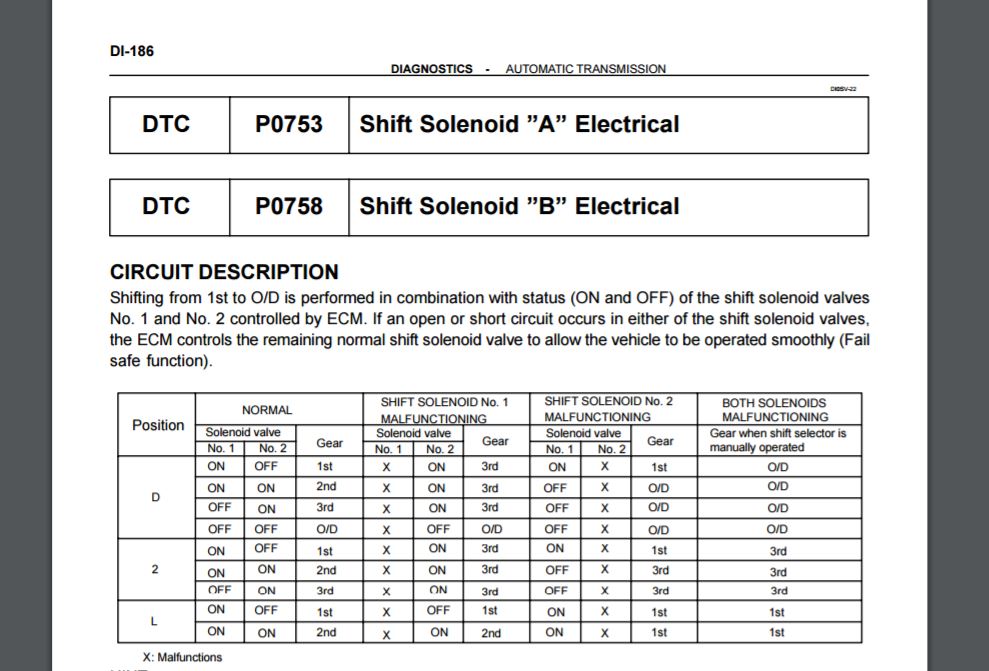

Not sure if this will help, but thought I'd post it. Found it in the FSM. :)
