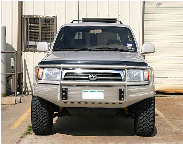

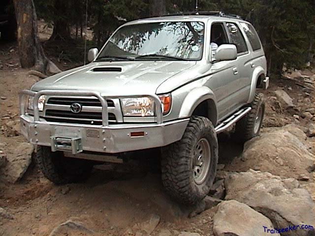

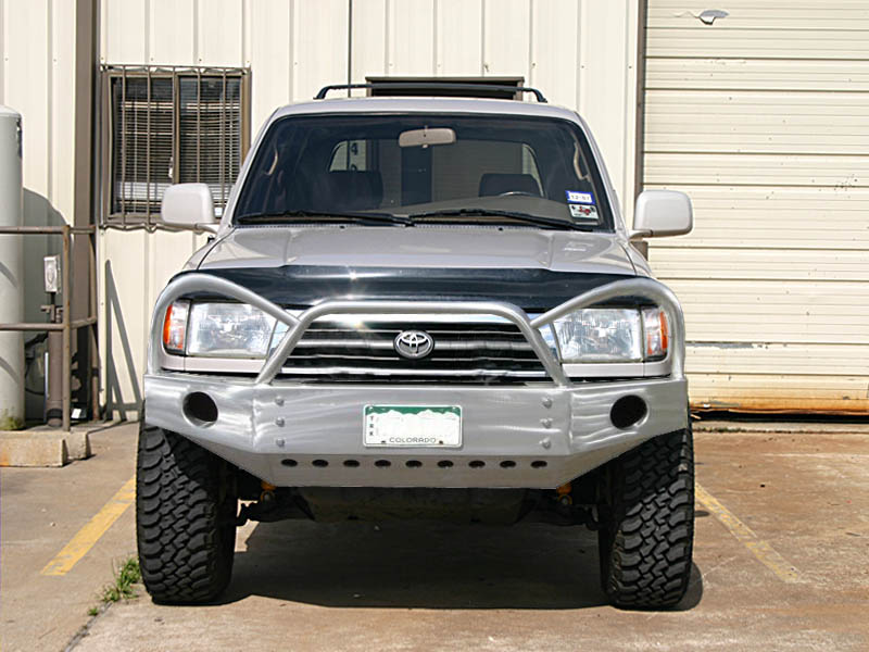

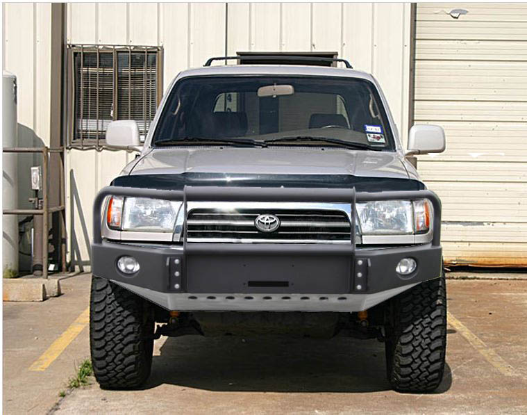

So I'm putting my order in for Denver Offroad bumper. He said I could have it built any of the following three ways, so I PS some together.. Keep in mind this Aircraft Aluminum...so with a winch, total weight should be around 100lbs. And more durable, and last longer than (10) ARB bumpers... nough said.. $1500, including powder coating, any setup....

If you are looking for comments, then I like the middle one the most. I prefer the rectangular stinger hoops rather than the ones that are rounded at the bottom. I definitely don't like the top one. Just looks funny to me and I can't understand the benefit of the stinger set up that way.
Yea I'd probably go for the middle one as well...but it would also look sweet without any of the hoops. It looks like the stinger is bolt on, that pretty cool too.
Pricing is not bad, aluminum is freaking expensive
I see most people like the first for running in the sand,, not sure why... I love the middle cause the bulldog pushbar mixed with the bumper is stout. I had the push bar on a 71 Blazer, and it took down a cow. And that's what I want something that can take a deer, or elk down....:boxer:
I would like to see the first with the stinger from the last picture. I think that would be sweet.
First ones cool, kinda looks like my ODL front.
The rest kinda look like they belong on police interceptor or a 80's pickup. Not my style, but im sure theres a market.
Good to see another manufacturer throw their hat in the ring though.
What is the reason for the tube hoops on the bumper? Do they serve any real purpose?

This design is ok. I would rather not have the bolt/ rivet heads showingon the front and would like a couple of anchor points.
Thanks for sharing the pics
I would like to see how these bumpers are put together on the backside. Seems to me aluminum would need a lot of bracing to hold up to repeated impacts (or a big impact). IMO, all the hoop/bull bar combinations are ugly. I would just get a plain bumper and hope I don't hit a deer.
I have to double check, but this isn't normal Aluminum, It's aircraft rated. Bench test strength shows that it is something like double the strength of 1/2 inch steal, or something like that....lol I want to call it the terminator bumper...:50cal: I've decided to go with the second from the very top, and add a one D-ring right in the middle where the license plate would go....

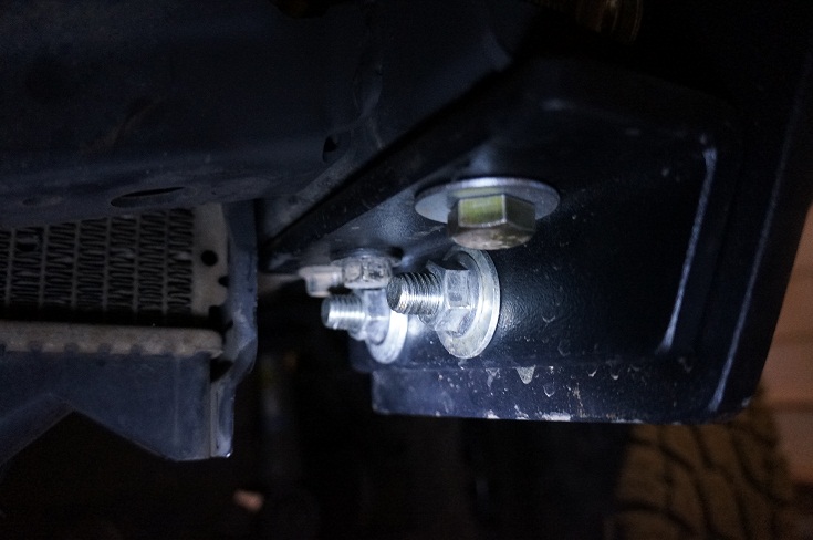

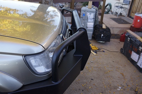

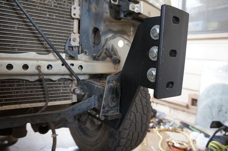

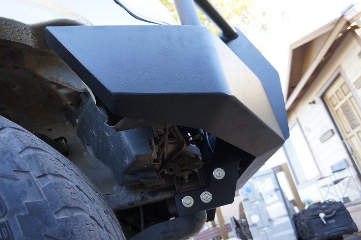

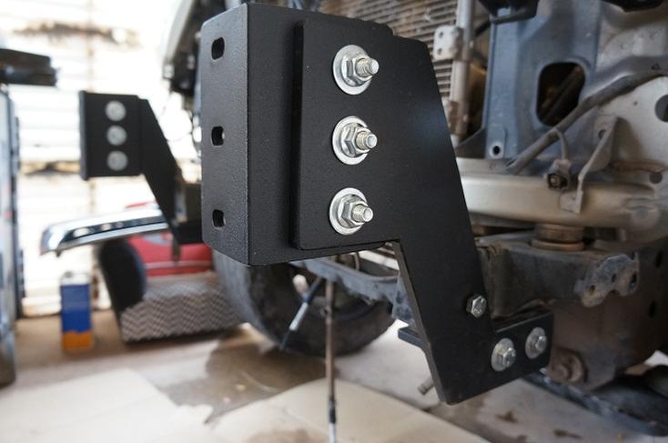

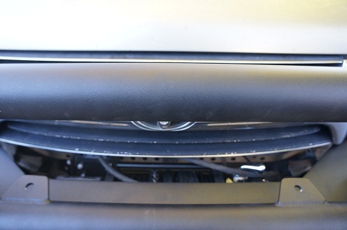

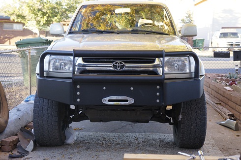

Final product...
really nice, I like the mounting system. When will these be available for sale?
It took about a month to make, but I told him to take his time since I was still in Afghanistan, at the time. So to answer your question he makes them when you send him the money.
