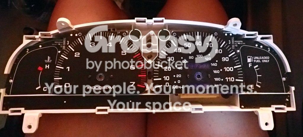

Well, I've been looking into trying to wire up the dash "RR DIFF LOCK" light, but ran into a problem today- It's not there on mine. I had always thought that every 3rd gen had it and it just wasn't wired, but I was wrong. I'm assuming 01-02 don't, but who knows.
In the picture below you can see the insert that only has ABS and the fuel light. Oh well, not a huge deal!
<a data-flickr-embed="true" href="https://www.flickr.com/photos/derpiful/31796995644/in/dateposted-public/" title="178.elockerlight"><img src="https://c1.staticflickr.com/1/486/31796995644_fb6caab078_b.jpg" width="1024" height="689" alt="178.elockerlight"></a><script async src="//embedr.flickr.com/assets/client-code.js" charset="utf-8"></script>
Yup 01-02's were never offered with a diff lock so they scratched the light from the clusters. Depending on the switch you got you can run power to a lighted switch the show when it's engaged. Just won't look as factory.
I would imagine you could get just that little piece of plastic from an older cluster in the classifieds.
Around here there's sometimes a damaged cluster to borrow parts from and, judging from the pic of the 96's cluster, seems JBurt's idea is a good one. If you go for it grab a few bulbs too.
