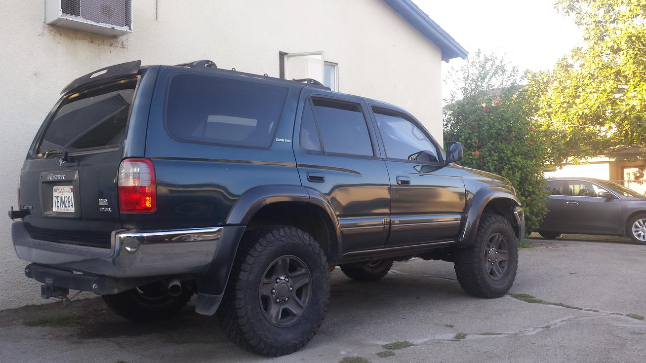

So the time has come, I have done a little bit of work on my runner so I figure I start a build thread to help document my maintenance, mods , and offroad runs/adventures
this one poped up at a local tow
97 limited 4x4 with rear diff lock
This is how she sits today (1/24/17) (295,000)

Obligated runner photo
After seeing how good all the old parts were I'm thinking my truck was a victim of lbj failure it's a salvage title and the passenger wheel well plastic trim it basically ripped off glad I finally got around to this and now truck feels solid over bumps

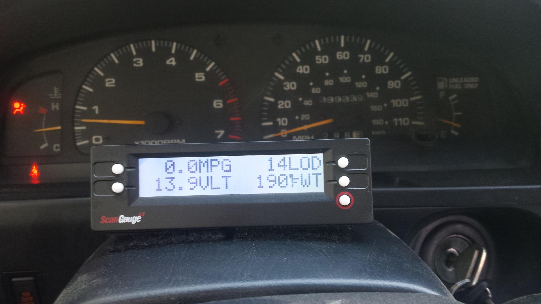

And got my scan Guage finally . the highest coolant temp my truck read was 205
I'm thinking a new oem rad thermostat hoses and possibly fan clutch is gonna be ordered when I get some time to stop by my local toyota
